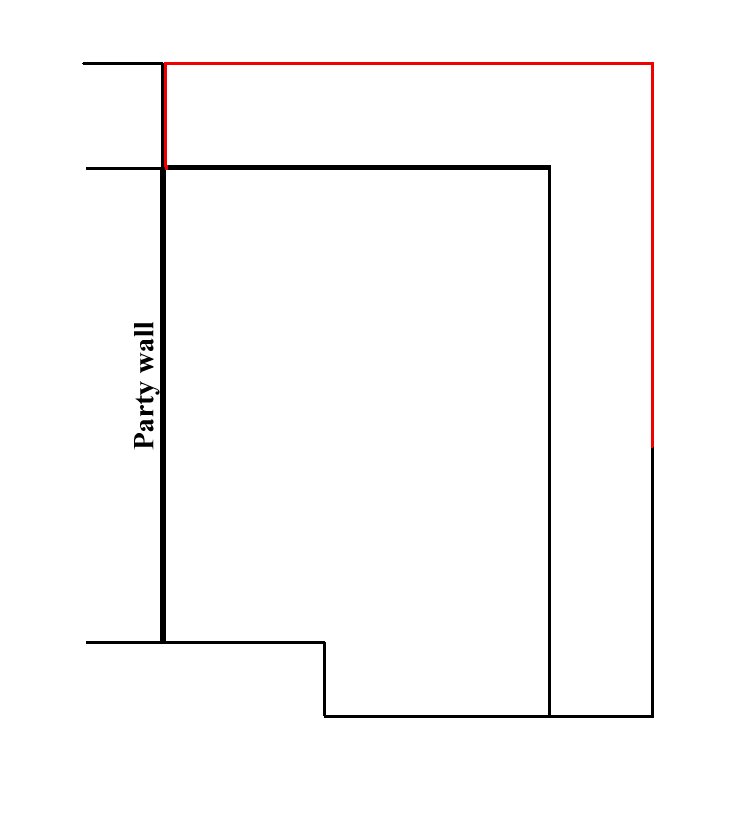

I have two questions regarding the demolition of an extension wall and building regulations. We have an extension which runs (9 x 6 metres) on the side and rear of our bungalow (in red) which is suffering badly from subsidence and damp. Our plan is to demolish the 9inch wall and replace it with a cavity wall. Although our architect says we don’t need planning permission to do this as we not increasing the footage, we do need to adhere to building regulations. It was not until I looked at the plans did I notice the architect has replaced the current raised wooden floor to a solid one.
The questions I have are:
1. Being as there is absolutely nothing wrong with the current flooring can I not leave it in place and integrate it into the new build, or would building regulations not allow it. By this I mean would I need to renew it?
2. Wouldn’t changing this part of the bungalow flooring (in red) from raised wood to solid not interfere with the current ventilation under the property given there will be very little through flow?
Any advice would be appreciated,
Rob

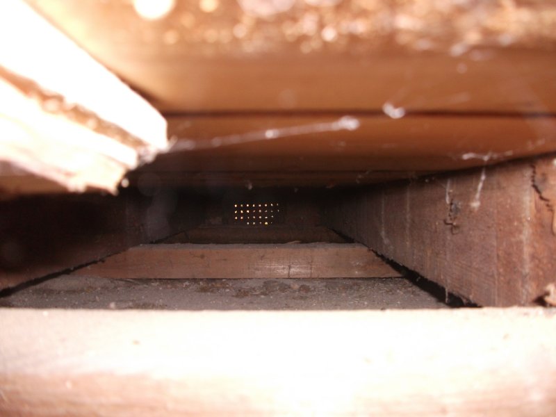

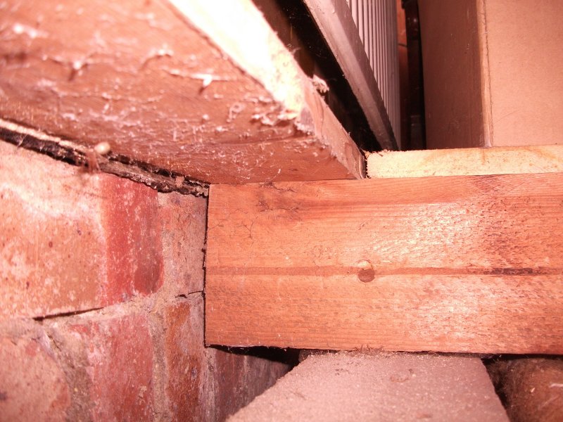

Instead of my trying to explain what the floor is resting on I have taken a few pictures for you. The wall to the left is the wall to be removed. The floor itself doesn’t seem to be effected by the subsidence.

The joist is resting on wood which is itself on a concrete base. The bottom picture is of the same location but taken further back from the wall. So in the bottom picture the right joist (running parallel) is the same as that in the top picture. Hope that isn’t too confusing as I can be terrible for trying to explain things :)
If you were propping the roof and just rebuilding the external wall you could probably have just got away with Building Regs for the new wall. As you are replacing the roof as well I would say they will treat the whole thing as a new extension. Not such a bad thing, you might as well bite the bullet and put in a new concrete slab floor and bring the insulation up to current regs, with vent pipes as Freddy suggested for the inner suspended floors. By the time you've messed around trying to insulate and ventilate the existing floor it would probably have been easier and cheaper to rip it all out and start from scratch.
Hmm, well if the floor can be retained without it compromising when the new foundation excavation is dug out then it should be possible to retain it, assuming it is sound. Sounds like a bit of an odd set up tbh. That said the joists are pretty shallow so not much insulation can be inserted between the joists whilst retaining good airflow, which you may as well do as the boards are up.
