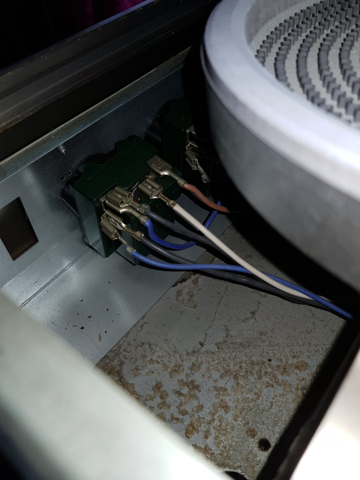

Hi

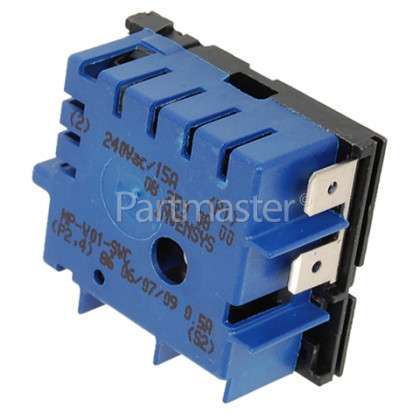

I purchased a me regulator from espares. I entered my model number and it gave me the compatible regulator. I received the product. Took apart the cooker etc. To find that even though it is compatible the product is different so I cannot just swap wire for wire. I need help how to replace it.
The part I received was mp-v01-svc which I have attached a pic of
Theres also a picture of the current broken setup.
My cooker is a belling and the model number is 444445057
Any ideas would be greatly appreciated.
The original regulator brown is live, white is load, and the blues and blacks are neutrals.
On the new switch P1 is live, 2 is load and P2 and 4 are neutrals.
Thank you so much for your reply .
So I put the brown wire on the p1 connection. The white on the 2 connection and then one spade of one of the black/blue pair goes on p2 and on the other pair one space from the black/blue goes to 4?
