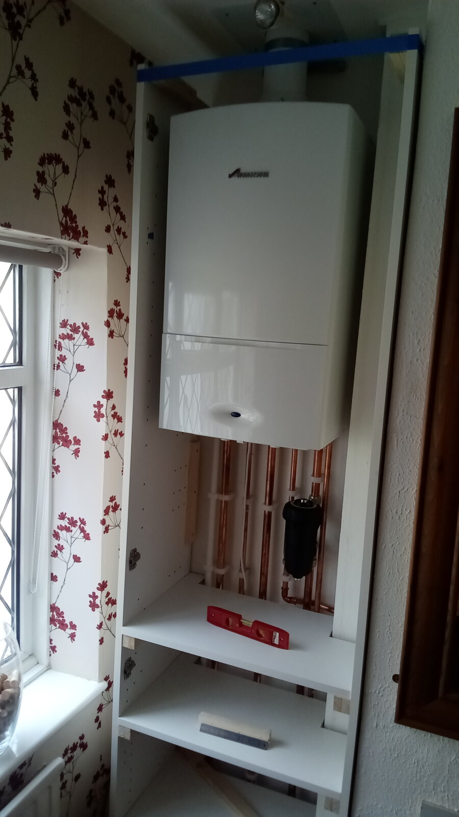

I am modifying a standard larder unit to go around a boiler (see pic: work in progress). The top door is about 1.3metres tall and weighs 9kg (three hinges). The left side panel will be fixed to the rear wall along its back edge, while the right side panel will be fixed with through screws into the side wall.
While the lower part of the cabinet provides cross-bracing with 4 batten-mounted shelves, the upper section will have only the top brace (represented in the pic with the blue tape) down as far as the top shelf (shown with the spirit level).
The top of the cabinet will be otherwise open to meet boiler clearances, and there is nothing else on the hinge side, e.g. no abutting cabinet.
So....will I need to reinforce the left panel? Is the current arrangement sufficient to resist flex with door use and resist sag over the longer term?
I have plenty of left over melamine :oops::), and can easily double-up over most of the top section near the hinges.
Any other thoughts welcome.
TIA!
You could possibly screw it into the wall at a couple of places with packers?
The gap could be filled with a closing panel if the Packers are unsightly?

I have done similar, but with a base unit trimmed to size for a wall cupboard, rather than a full height. I left the top open, to ensure there was adequate ventilation. I also made it quick to remove, should it be needed for boiler servicing or replacement - Just two fixing to remove and it pulls away, to give full access.
In your case, I would look at adding more bracing between the two sides, at least one above the boiler (where the blue is) and one just below the boiler, made from a bit of 2x1 bracketed, or even better a pair of side to side metal brackets.

Yes, good idea! I can install an additional cross brace(s) >200mm below the boiler and still be compliant.
Maybe I can combine that with something easily dismountable or knockdown-able (e.g. using modesty blocks or with those keku clips mentioned by @foxhole).

@RandomGrinch - those button clips would be great with a re-purposed cutdown shelf mounted vertically in front of the mag filter.
Yes, that would work nicely. Though be careful how you attach the brackets to the shelf, the buttons can be quite tight - you don't want to pull the screws out of the shelf the first time you remove the panel!
