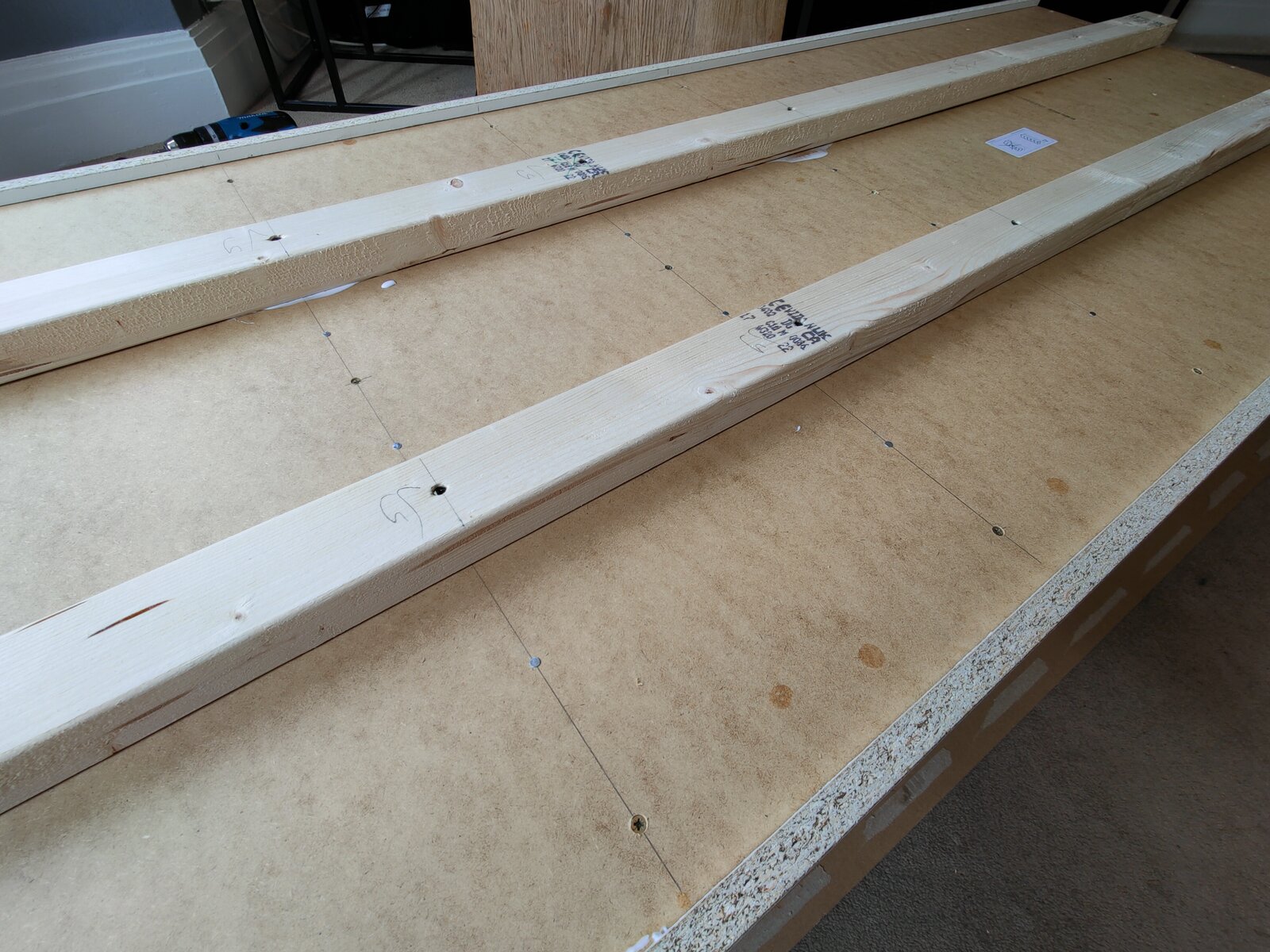

When I reinforced my Ikea Billy bookcases I fixed a couple of vertical battens to the back and used some extra screws as per the photo, I didn't want to fit a batten to the front of the shelves, could have easily used slimmer timber but CLS 38x63 is about the cheapest there is and I had the room behind. It has the advantage that it rigidify's the whole unit too.
