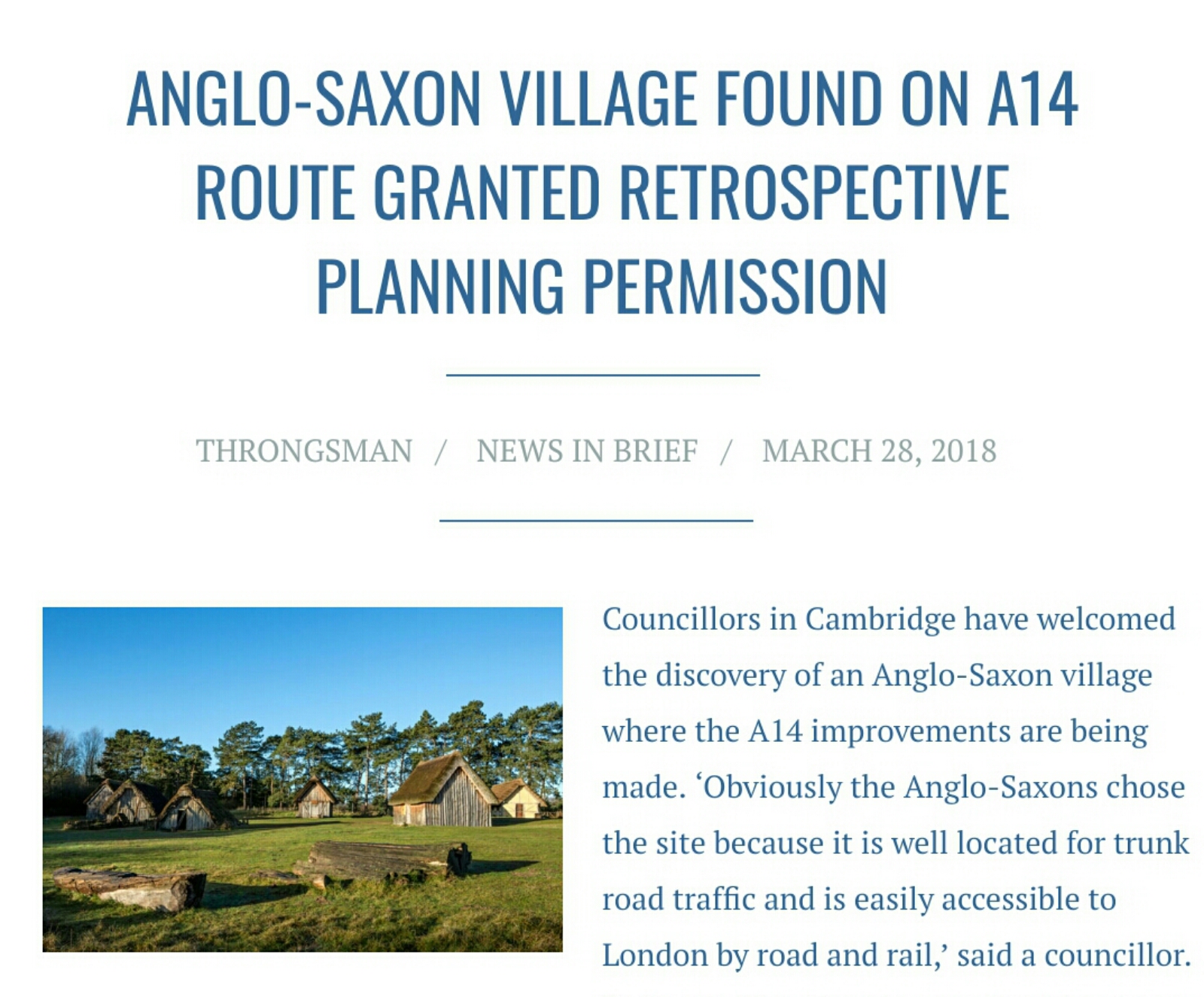

The OP may be in luck going by this recent planning decision
Full story here
Thanks for your replies everyone - much appreciated and I will definitely give it a good go :)
i would wait for an hour or so as the suggestions and information given is often different after aprill fools day has passed :D
