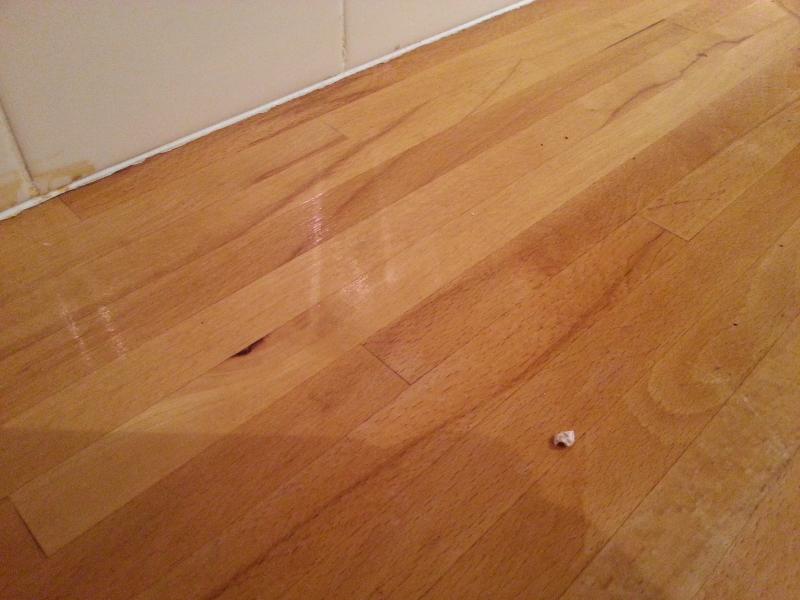

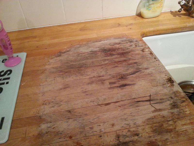

I am a newby to this forum but looking for some advice on our kitchen work tops. We have not long moved in to the property and they are as they show (hopefully) in the pictures below. The first one is heavily damaged, being next to the sink it has soaked up a lot of water it would seem. The second only has some slight discolouration to the area. And the 3rd is what it should look like...What would be the best way to get them looking good again? I was thinking of giving a light sanding and then using some teak oil or something? I have seen some you can buy wilko etc which is a clear oil. Will that be enough to brush in and let it soak in and it will pick the colour back up, or will I need colour specific oil?

I'm in the process of re oiling my worktop.
Yes sand first, I used 120 grit sandpaper to remove the dark stains then finished with 240 grit. Cleaned the worktop with white spirit, then used Ronseal worktop oil. It has come up brilliantly.
I believe most professionals use Tung oil but I always prefer worktop oil.
Using teak oil I doubt you would get the heat protection you require in the kitchen.
