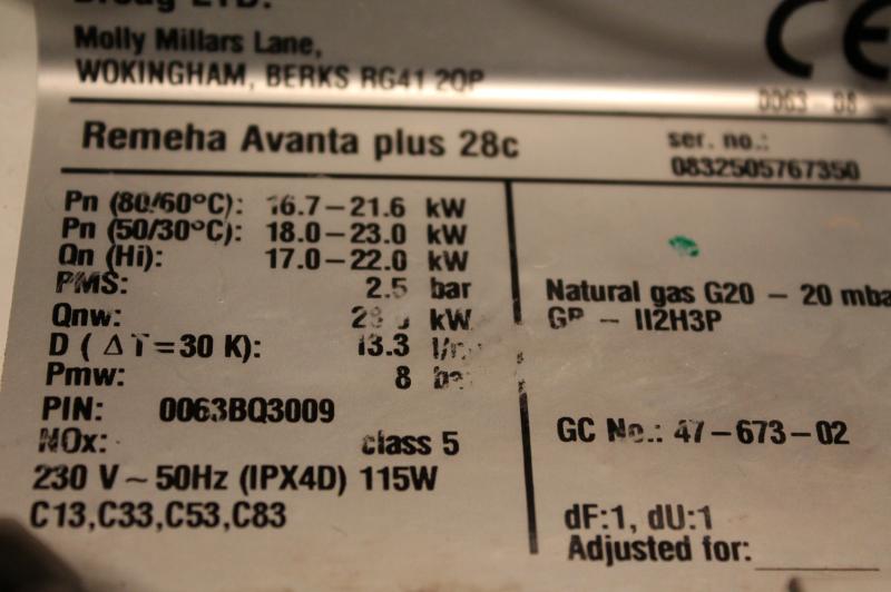

Values for df and du are both 1.
Correct values are on the data plate on the underside of the boiler.

df and du values are both 1 on the data plate.
Appreciate the help but I think I will be ordering a new PCB!!!!
ldf and du values are both 1 on the data plate.

As for the pic, I was curious where the dF and dU info were located as my Remeha boiler data plate does not show it.
