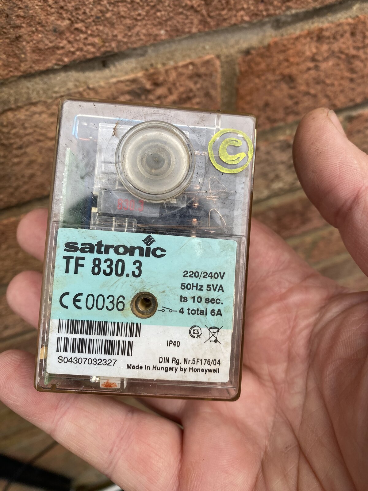

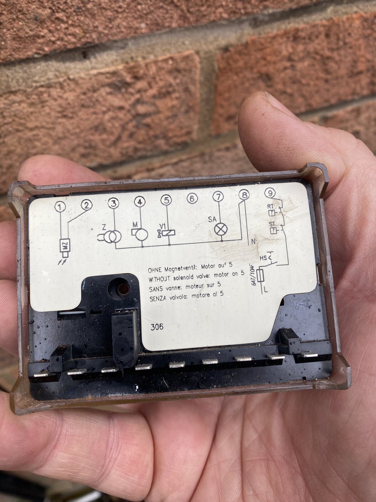

Hello, lurked and have found some decent answers here before, thank you.
Having some issues with a Wall Mounted Worcester Danesmoor WM 12/19 which I might need to get into in later posts.
What I'd like some advice on at moment is why the "Remote Lockout Reset Button" on the above boiler doesn't actually reset the lockout. To be clear this is the momentary button that is located inside the property on the bottom of boiler panel along with the overheat and frost resets.
The lockout reset button on the Satronic TF830.3 attached to the B9 burner does work as expected.

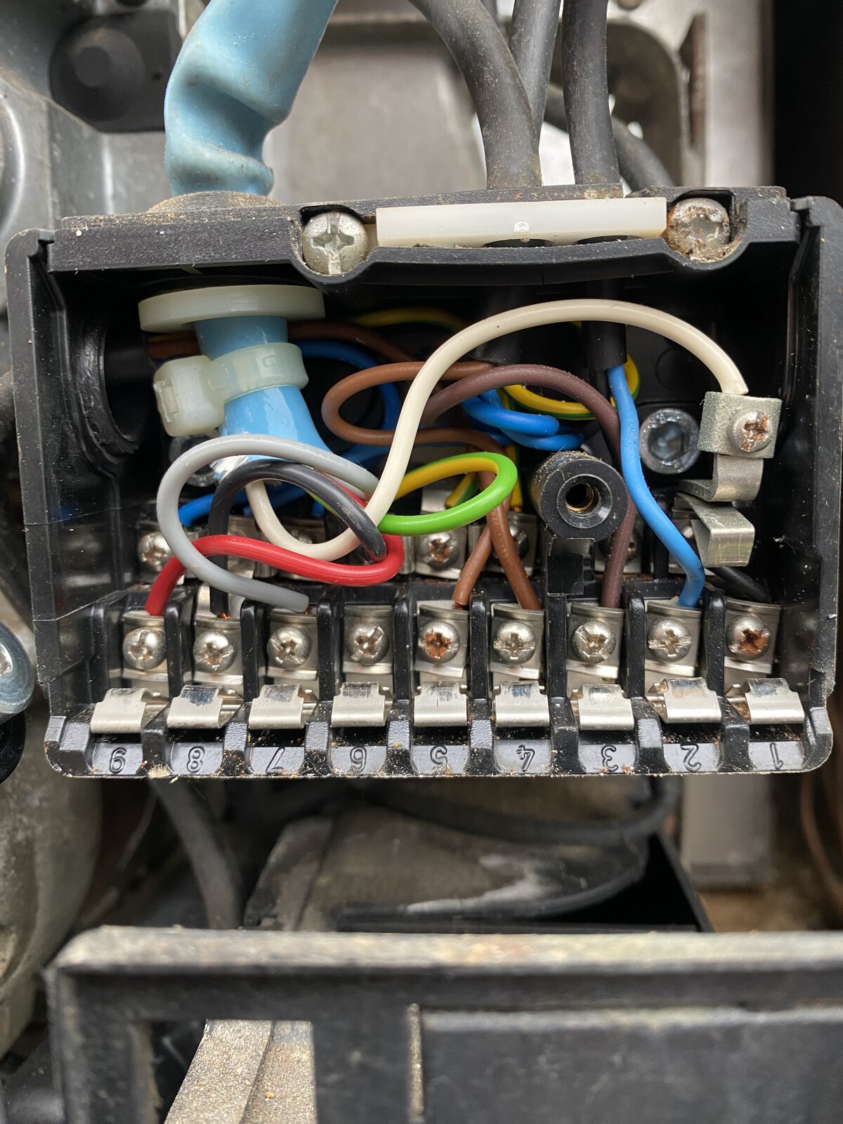

I've tested continuity of the button itself and I've traced mains voltage back from button (once pressed) via the White wire all the to the Satronic controller panel.
So when I press the remote reset and mains voltage appears at the post the white wire terminates to in the photo. I do not have the experience to know where to go next.
I thought the controller might be at issue so parts canon replaced it but still the remote reset doesn't work. Asking for some direction please.
