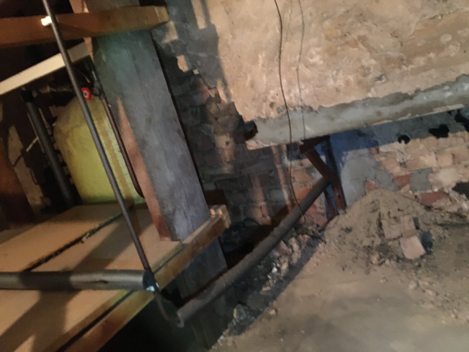

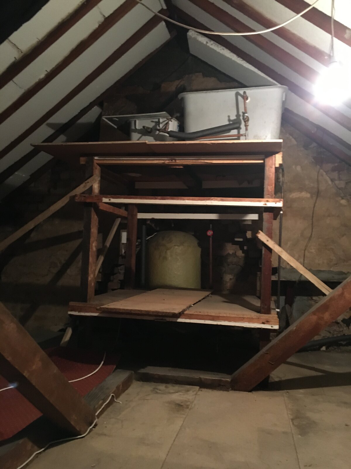

Hi everyone when removing a chimney breast how would a person know if a RSJ is needed? I’m looking to remove the chimney breast from my front living room, the back living room has already had the chimney breast removed first and ground floor and gallows brackets in the loft, would it be
the same for the other chimney breast? Do I need to get a structural engineer to have a look? They are expensive? Any help would be great thank you
The word is that gallows brackets aren't always suitable, the rules have been tightened over the years so you may not be allowed to use them on this chimeny, even if the other one was previously signed off that way in the past.
As far as I know it isn't an absolute requirement to get engineering calcs before Building Control will sign off on it, so you could contact them and discuss it. They'll probably insist on a site visit anyway. I'd plan with the expectation of needing an engineer.

I work in B control I've not encountered any problems with gallows brackets.
If installing steel I've rarely requested calcs if an over engineered approach is used.
To preempt the comments that will inevitably be left saying its not done like that elsewhere, this is the approach adopted by all the authorities I've worked, but I can't speak for everywhere so you still need to check with your building control body.
