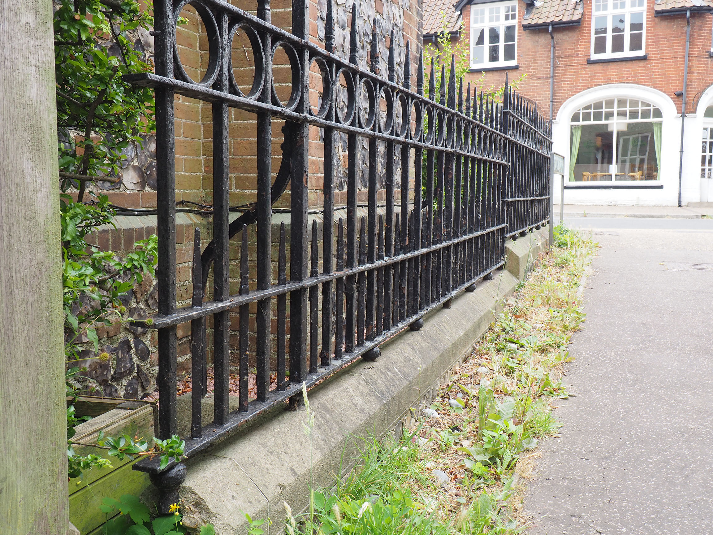

Hello,
I have some lovely 100+ year-old iron railings outside my house, on the boundary between my garden and the footpath, like this:
The paint is horribly flaking and they are fairly rusty. So the obvious thing is to get them sand/gritblasted. But, the local council, having spoken to the gritblasting company, are going off on some ridiculous tangent that has suddenly exploded from a sensible "you'll have to put up some signs asking pedestrians on the pavement to wait to be escorted around the site" to "ooh, it's near a road junction. You're gonna need traffic lights and all kinds of unbelievably ridiculous and expensive nonsense".
Various sandblasting companies I've spoken to have been keen to cut the railings out :eek:, take them away and sand/gritblast them, then weld them back into position. The idea of this horrifies me, especially as the railings are embeded into the base and a wall in THIRTY SIX places, not including the 7 or so curved support brackets.
Another option would be to find someone* willing to spend a week or so with a wire brush on a drill, working away at the rust/paint. Or is there an ultra-powerful chemical paint stripper that would be strong enough to strip this paint and rust?
*Preferably not me, but I feel this might be somehow inevitable.
So, I'm posting this for any advice on how best to progress this - has anyone experienced anything similar?
Many thanks in advance for any help!
~ Paul
