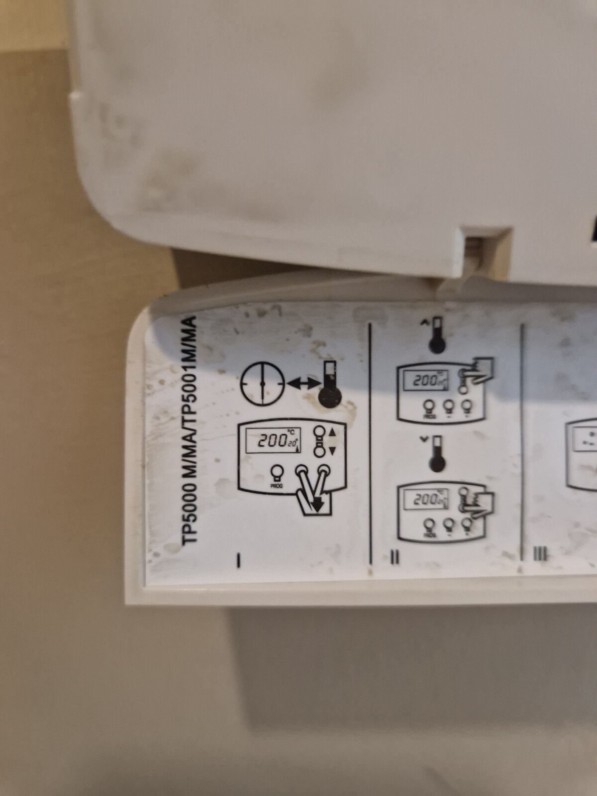

The stat is a danfoss tp5000 and is wired with live natural earth and SL and a jumper wire
Boiler side has single live natural earth and the SL with the 4 port empty on Boiler terminal block
Then I have 3am fuse switch that I haven't taken off wall yet.
All the cables them self are within the wall and I would rather not remove them.

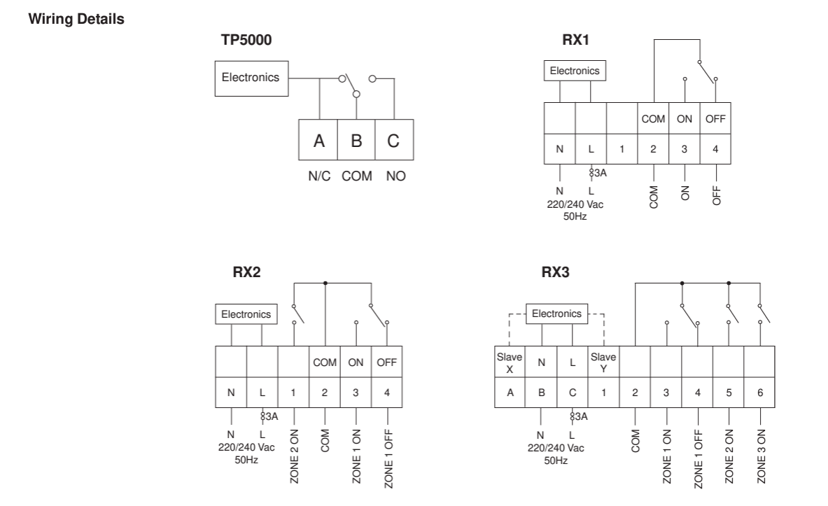

OK so the TP5000 is the hard wired programmable stat but it is battery powered so there should really only be 2 wires in there - a live (Com) and a NO (SL) ?
That looks like the receiver back plate and the room stat is wireless (RF)? Can you send a pic of what usually sits on that back plate, both side of it.. Is there another box that has the time/temps on it? Unless there's another TP5000 that Danfoss don't document.
Not that it all really matters as the isolation you'd have to perform is in there anyway. So if it's all been wired properly then the L&N should be powered from the same wall FCU as the boiler is. So the L&N would be disconnected in the FCU and put into a connector block and taped up and the SL disconnected at the boiler and taped or in a connector and taped too. The everything in that back plate is disconnected and can be taped up and placed into the wall
Right - ok - it's the TP5000MA SI with the remote sensor pick ups, nothing like Danfoss for making it confusing with multiple model types

not that it matters as you say but here is photo of stat I have just found manual and it's the tp5000 si range think there is rf version but it not this model or setup
yes so ideal if it all turns off at the Fused connection unit (FCU) - isolate the FCU for the boiler at the fuse box - open that up and you'll find 2 sets of wires, one set for the boiler and one set for the programmer. Always best and safest to disconnect the power to the stat from it's source which is in there. Just need to cover the wires (connector block) so they don't touch anything once the FCU is back together. Then pull the SL from the Boiler connector. That can just be cut back and taped and sat somewhere out the way.
Wiring the TADO receiver can all be done @ the boiler.
