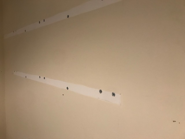

Good evening,

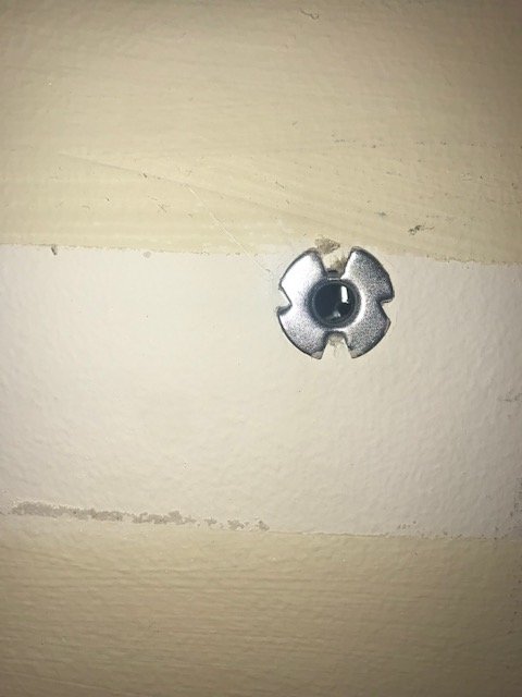

I've just taken down some floating shelves installed by the last home owners and am left with a wall of these crazy wee guys.
They seem to go pretty far in the wall.
So far I have tried to just use a flat head screwdriver and sort of prize them out and also thought I could screw a screw in and then pull out with pliers or something but haven't found a screw that would fit just yet.
Any help would be appreciated!

Insert a correct size set screw, (sometimes known as a bolt!), leaving the head projecting a short distance.
Place a block of wood against the wall to protect it and use a claw hammer to lever them out by placing the claw under the screw/bolt head.
There may be a little breakout around the hole but this can be repaired with filler.

No idea what an hss bit or pop rivet bit is :oops::LOL:but have had success with a sort of mish mash of everything! Hammer in to get some purchase then wiggle out and use the pliers to snip the top off.
