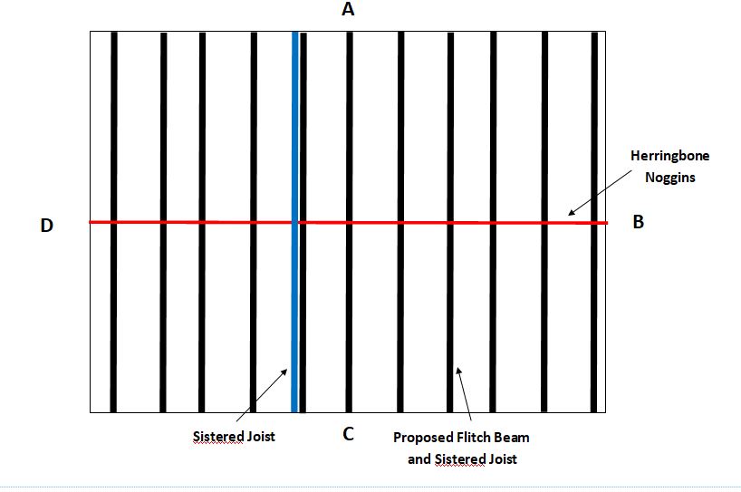

Attached below is a diagram of what is there currently and what I was proposing to do. A run of herringbone goes along the center of the floor. I was planning on the flitch beam running alongside one of the current joists and then sandwiching it with another joist alongside (in a similar way to how I have sistered the other joist).
Would this not work? I am keen to avoid having a beam in the floor below as I want to do a basement conversion at a future date.

You are strengthening 2 joists which will make the floor more rigid in that area with a bit of overspill assistance to the joists either side of it but basically you are not strengthening the floor as a whole. You may as well put the same size joists in at 200 centres at least the deflection would reduce by half
If you wanted to use a flitch beam and keep it within the existing joist height, you would need to cut every joist, fit the flitch beam and use joist hangers
alternatively sister every joist, maybe both sides for the joists around the middle.
and noggins help: use timber full depth of joist ie 220mm and stagger them so they can be screwed through and not just spiked
