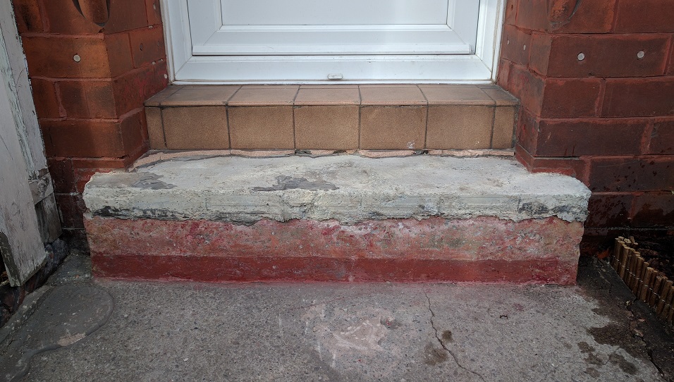

I am in the process of restoring the doorstep on my Victorian terraced house. It has been tiled over at some point, which is not to my taste. I have stripped back some of the tiles, which took quite a long time as they were well and truly stuck down! Anyway, when the tiles were added the height of the step was increased by what looks like concrete and so I need to remove this with damaging the original step underneath, which appears to be in fairly decent condition. See attached photo. Does anyone have any ideas how I can remove the concrete without damaging the original step?

Sliding a spade or a shovel under the concrete layer might lift the whole thing. Or a few hammer blows near the edge might shatter it into prisable pieces.
There doesn't appear to be anything on the step tread surface that could be damaged.
Do you intend to leave the remainder of the tiles? Its possible that the PVC threshold is sitting on tiles that were laid before the door was installed?
The two risers should be the same height typically: 7 1/2".
Off page but the plugged injection holes are far too high to be of any possible use.

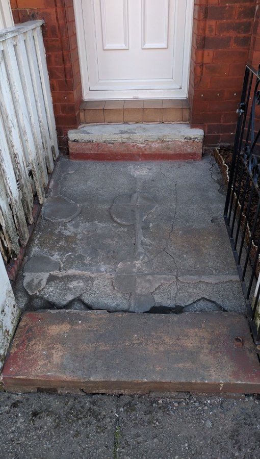

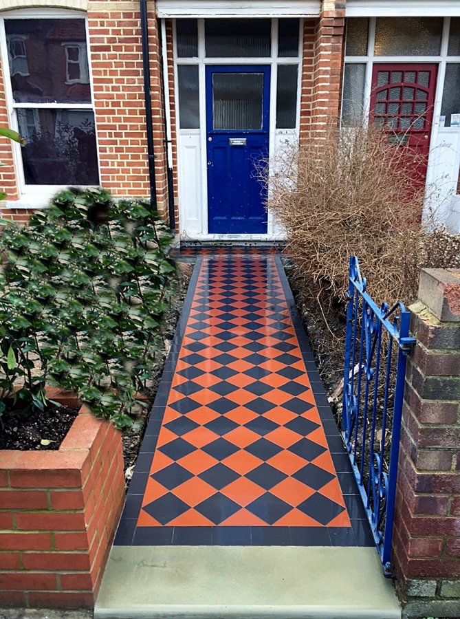

Vinn - Thanks for the info. I don't think I'll be able to get a spade under it but I'll give it a go. Failing that I'll think about whether to go at it again with a hammer or whether to re-tile with some nice Victorian tiles. I've taken the flags off my path too and it's not in the best condition (see attached photo) so I'm thinking of getting the whole thing tiled anyway (see example attached), so I could include the doorstep as part of this. I was intending to remove the remaining tiles on the doorstep as I don't like them. I had given thought to the PVC threshold but was going to see what the situation was as I chiseled the tiles off.
With regard to the plug injection holes I'm not at all surprised. I bought the house as a refurb and it seems that some of the work was done on the cheap and by people who didn't really know what they were doing. The injection holes are two bricks above the air bricks. I don't know where they should be? Some of the neighbours have theirs in the same position and others have theirs in the line of bricks directly above the air bricks.

You will have to work out the finished levels of the treads, and the finished level of the path. Having one riser higher than the other is dangerous.
The FFL of the path will affect the riser heights.
Tiled steps need quite a few considerations - type, dimensions, nosings etc.
The present tiles are too smooth for exterior use - you really need anti-slip tiles.
The dazzling Victorian pattern tiles in your photo are smooth (ie. slippy), and probably very expensive.
Best practice height for the DPC is the bed under the air brick or, failing that, the bed on top of the air brick.
The linseed oil mastic pointing has been poorly done.

The tile photo I attached was from Google images. Just to demonstrate the sort of style I had in mind. Following a quick search on the Internet I have found a website that sells new frost proof anti-slip Victorian floor tiles. They're 78p each which doesn't seem a bad price? I've ordered some free samples to see what they're like.

As a small point , I think the proportion of that step is wrong, that's why it was raised, I would make it shallower (as you want) but a lot deeper, so you can actually stand on it.
