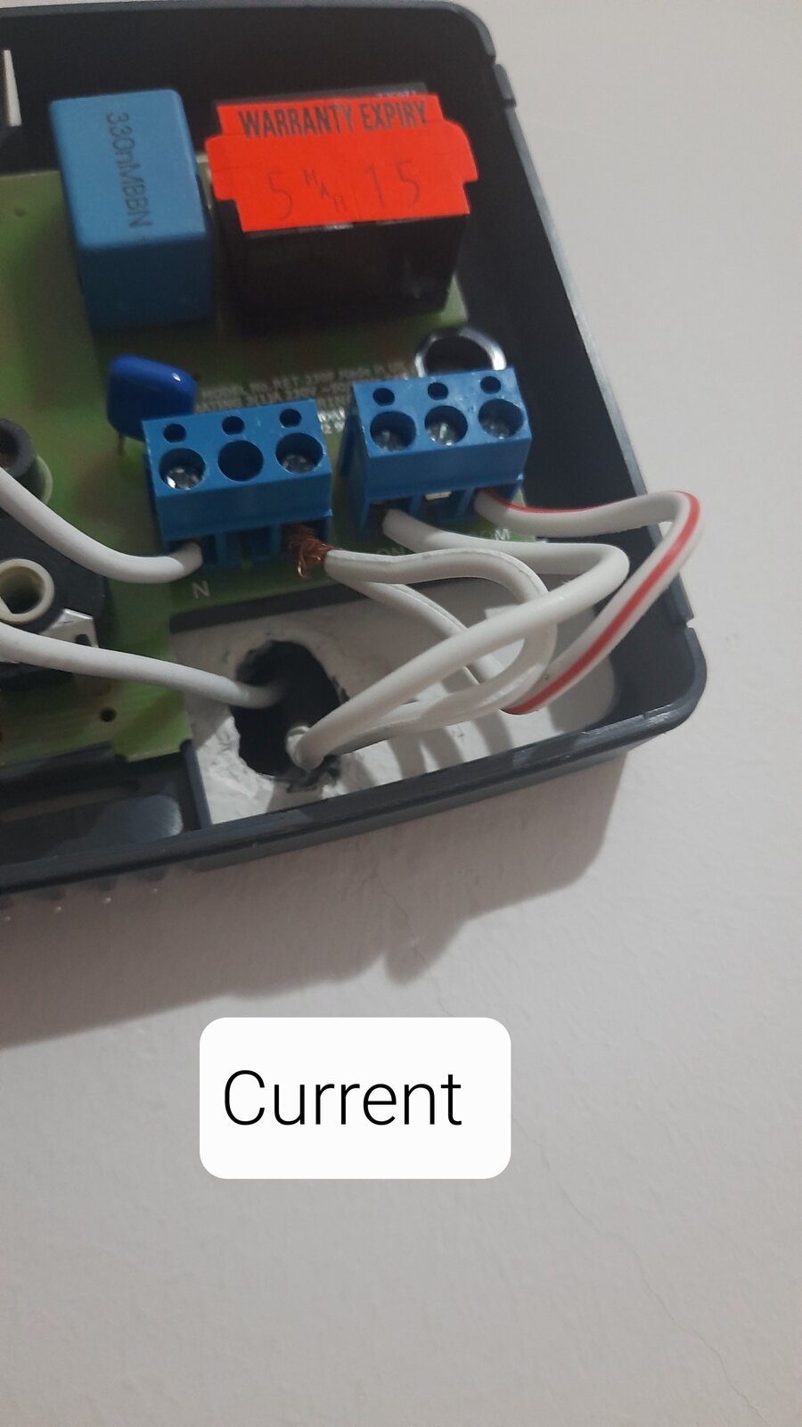

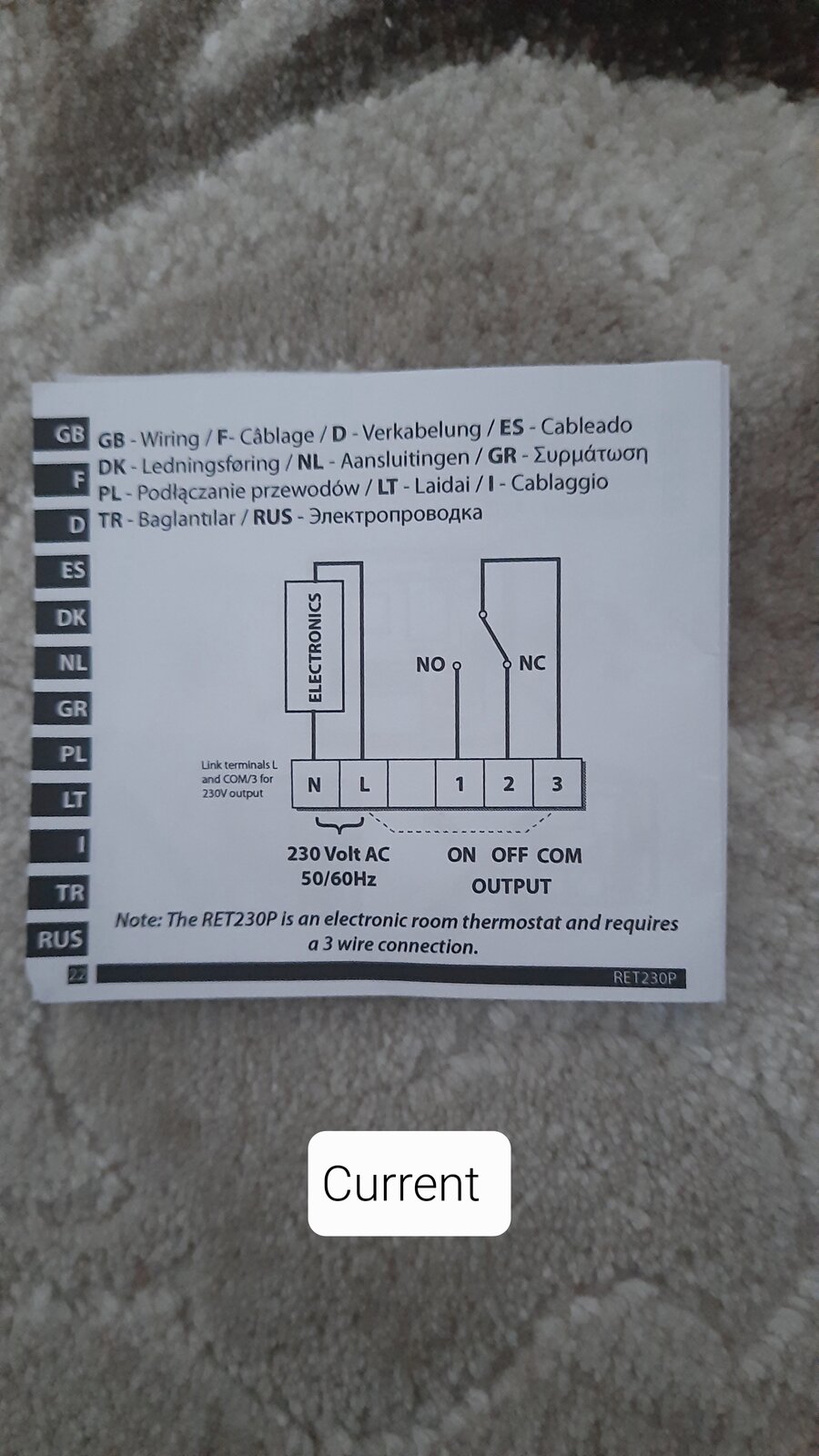

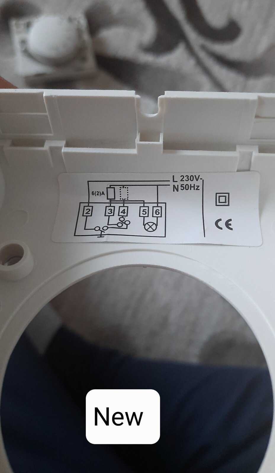

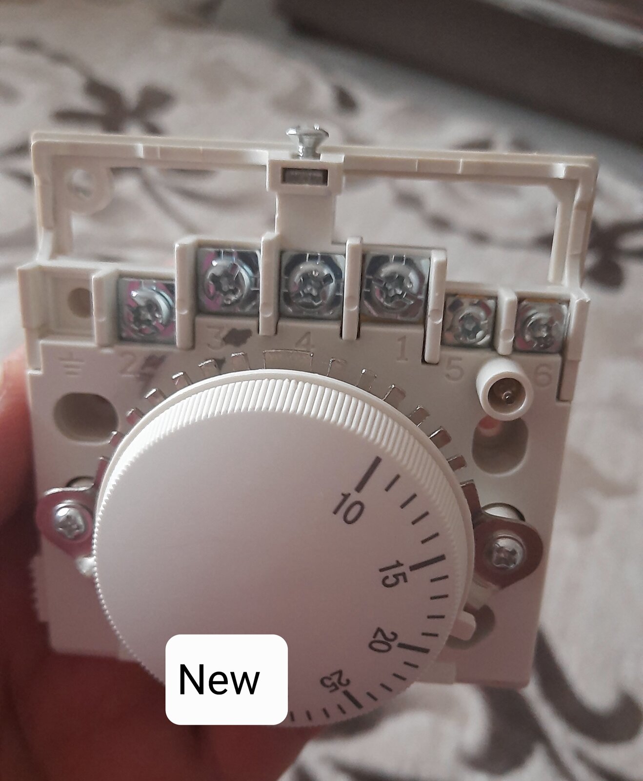

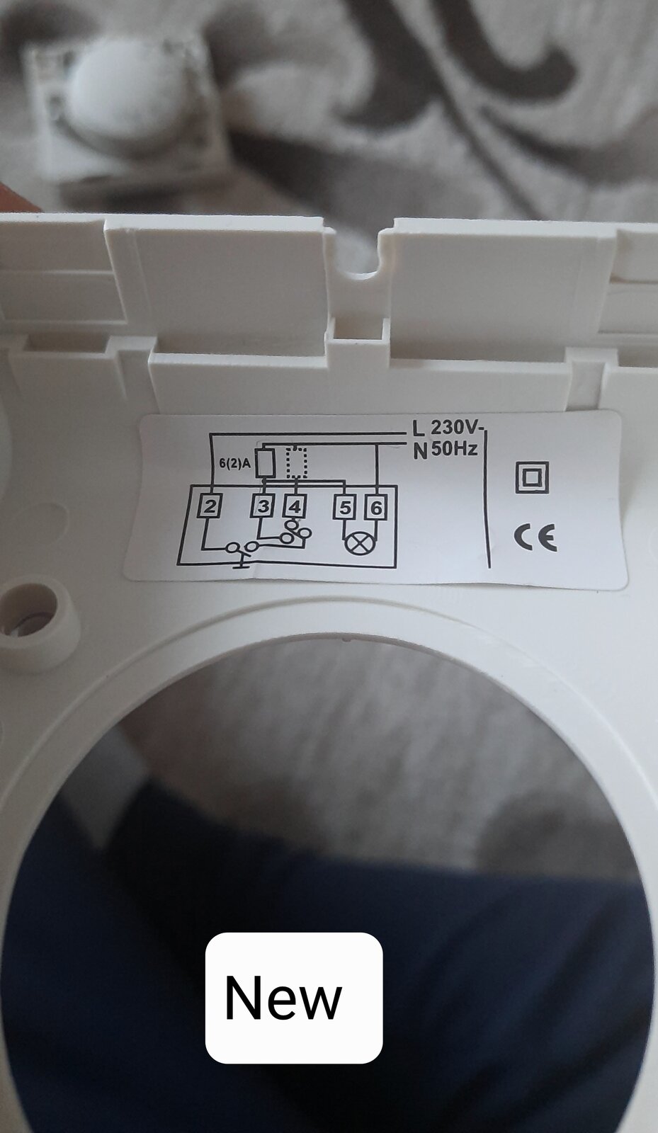

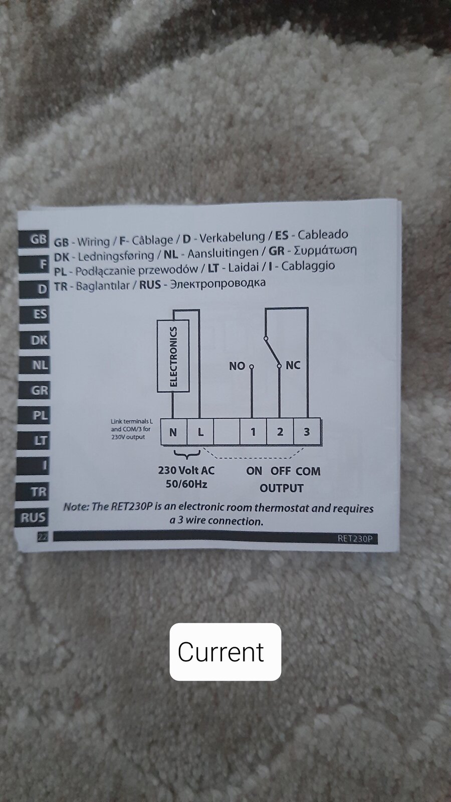

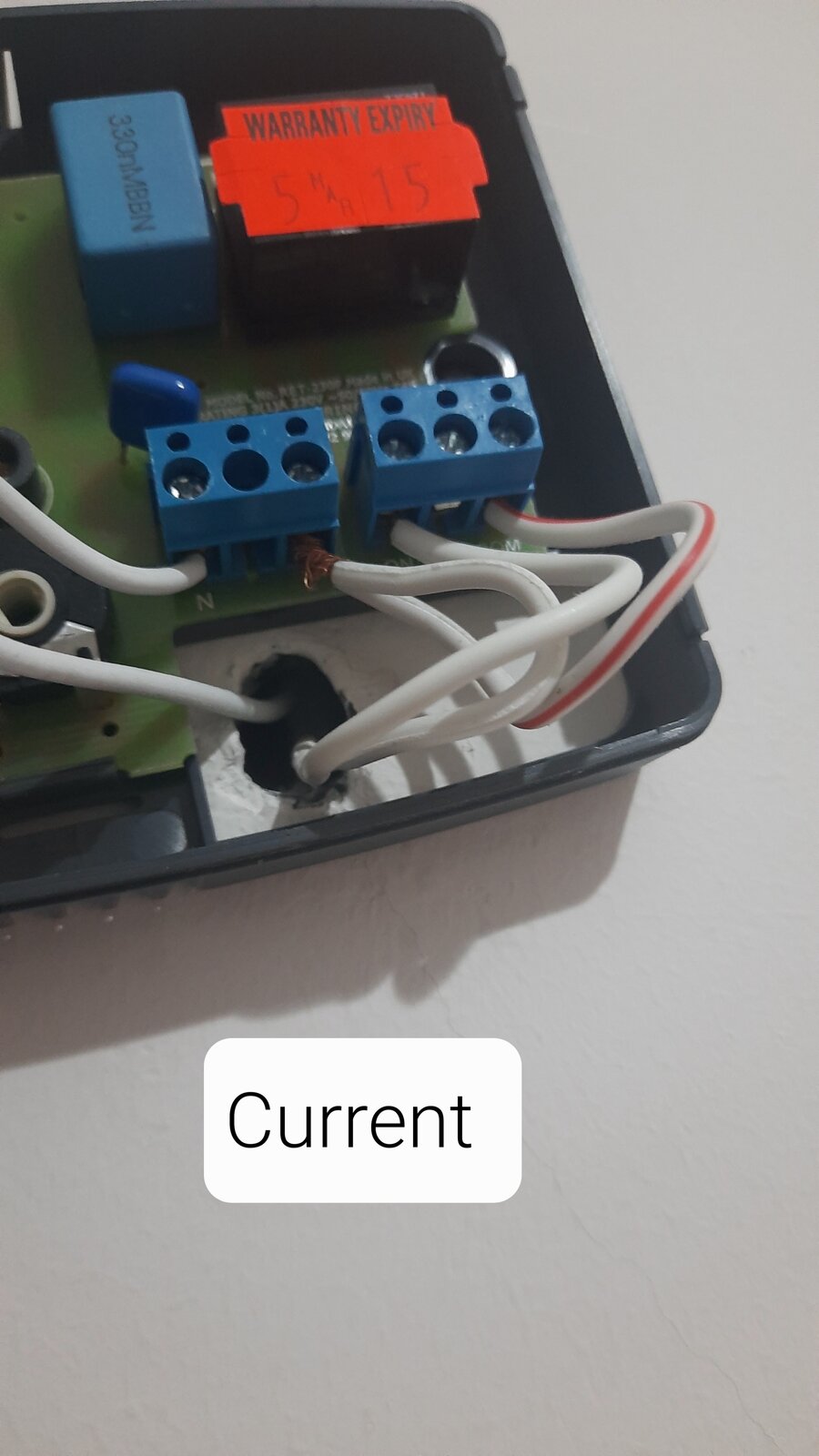

Hello,
I have problem with Chinese thermostat. Anyone could help me with wiring diagram? Where do I connect the wires to my new thermostat?
Tank you for your answers and sorry for my little english.

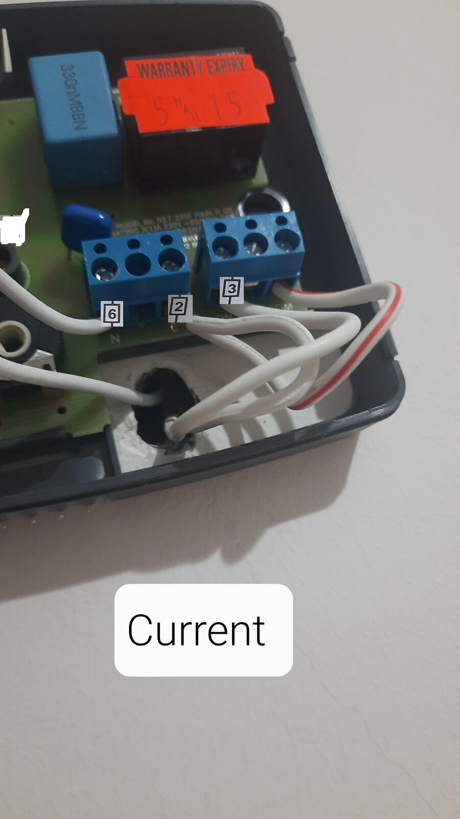

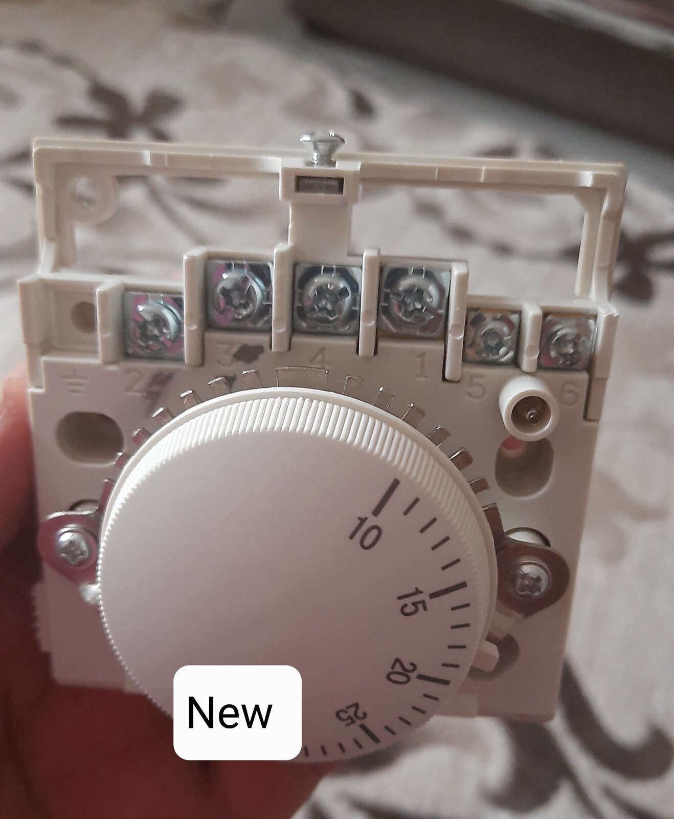

Hard to understand that wiring diagram, not the easiest. I thought I had figured it out, but unfortunately I can’t.
I think it’s L to 2, N to 6 and NO to 3, no link is required.

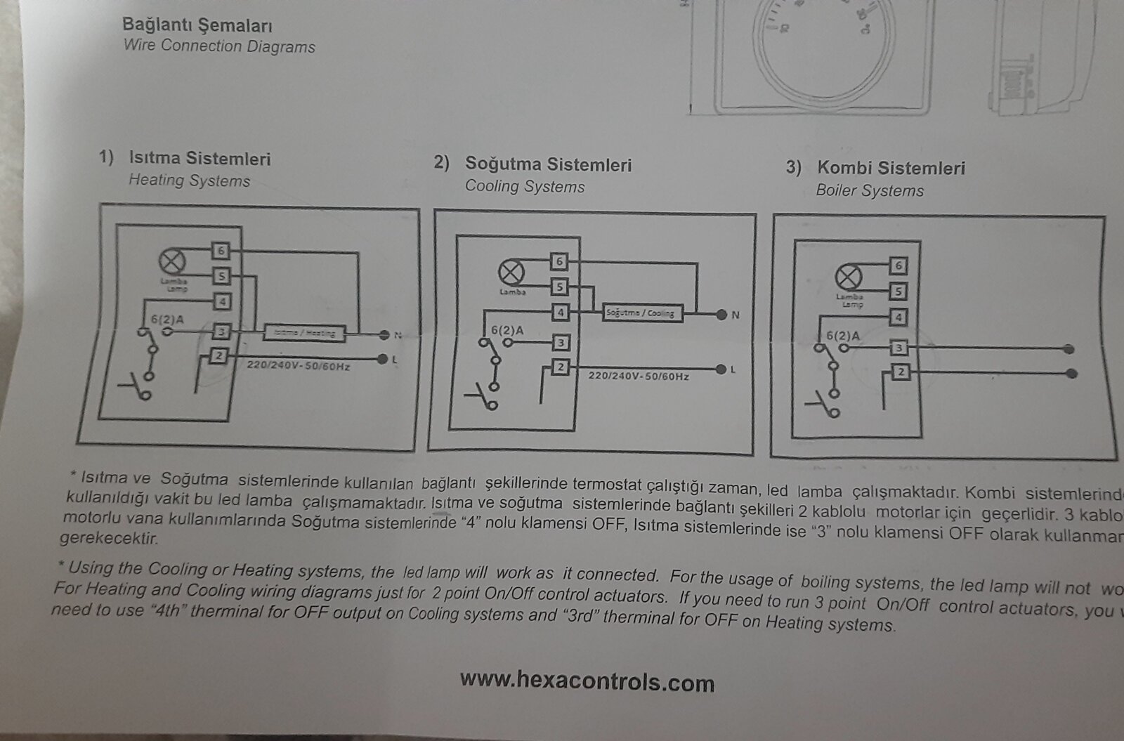

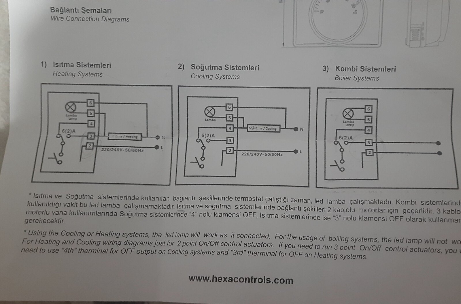

And in the manual there is an explanation below. My thermostat is heating sistem.
Does the diagram show that it links internally when a call for heat?
No. This particular thermostat can also be setup for cooling, with the NC terminal.
In which case, the external link would be made between terminals 4 and 5; the neon would then indicate a call for cooling! :)
Unlike many similar stats, the circuit diagram doesn't show an accelerator resistor - the neutral connection is only required for the neon.
