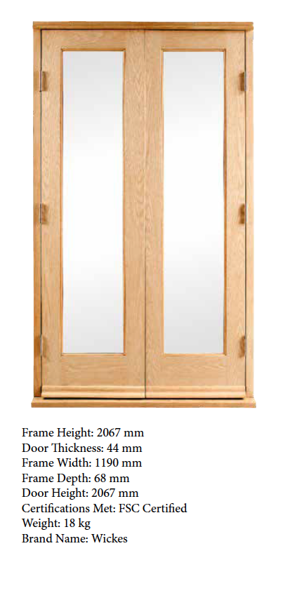

Wondering if I could have some advice on the above. I have a window in a kitchen that looks out to our side return. I'd like to remove the window and the brick below and insert doors. There's a lintel over the window and i'm not changing either the height or width or the opening, just the depth as the doors will fit perfect to the opening.
Would I need planning permission just to remove the 100 odd bricks below the window?
Thanks, Otis
You won’t need planning permission unless the house is listed
Assuming the doors are glazed you would either need Fensa approval or approval from the Local Authority Building Control if you are fitting the door yourself. Trickle vents would be required if the existing window has them, the glazing would need to be toughened.

The doors would be fitted by a builder and they are oak veneer. The window was a fairly standard fit and I'm nearly sure had not got the vents you talked about.
It should need building regs approval, but there is little point and no value to you if you applied.
That's a solid wall, so the builder can't mess any DPC or cavity up, in which case you might want to just let him just carry on and do it if you think you can trust him.
Planning permission might be needed. E.g. if the property is a flat rather than a house, if the property is in a conservation area with an Article 4 Direction, if PD rights have been removed by planning condition. Etc..
