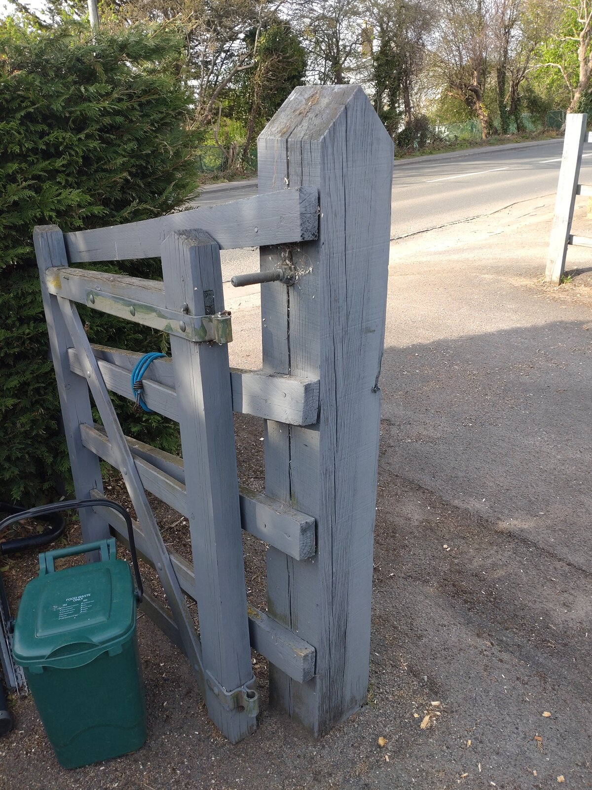

Any suggestions on removing this post with minimal effort & damage to the drive? I can't just cut it off as I need to fill the hole and tarmac over.
If I could persuade a friendly HIAB driver next time I get a delivery, do you think their 1 tonne crane thing would pull it out?
jack or lever.
I can't see a pic
is it concrete or wood?
size?
Sorry here you go. 9" square
If you pull it out you will crater the tarmac
It's possible to cut them off flush and burn the stump.
I once used a very large drill in a broken post, thinking to break it up. The heat dried it and it shrank enough to loosen and pull out.
Remove the fence parts and dig a little around the base, use the post as a lever to wiggle it.
You can fix a post near the ground horizontally and use a car Jack to lift it.
