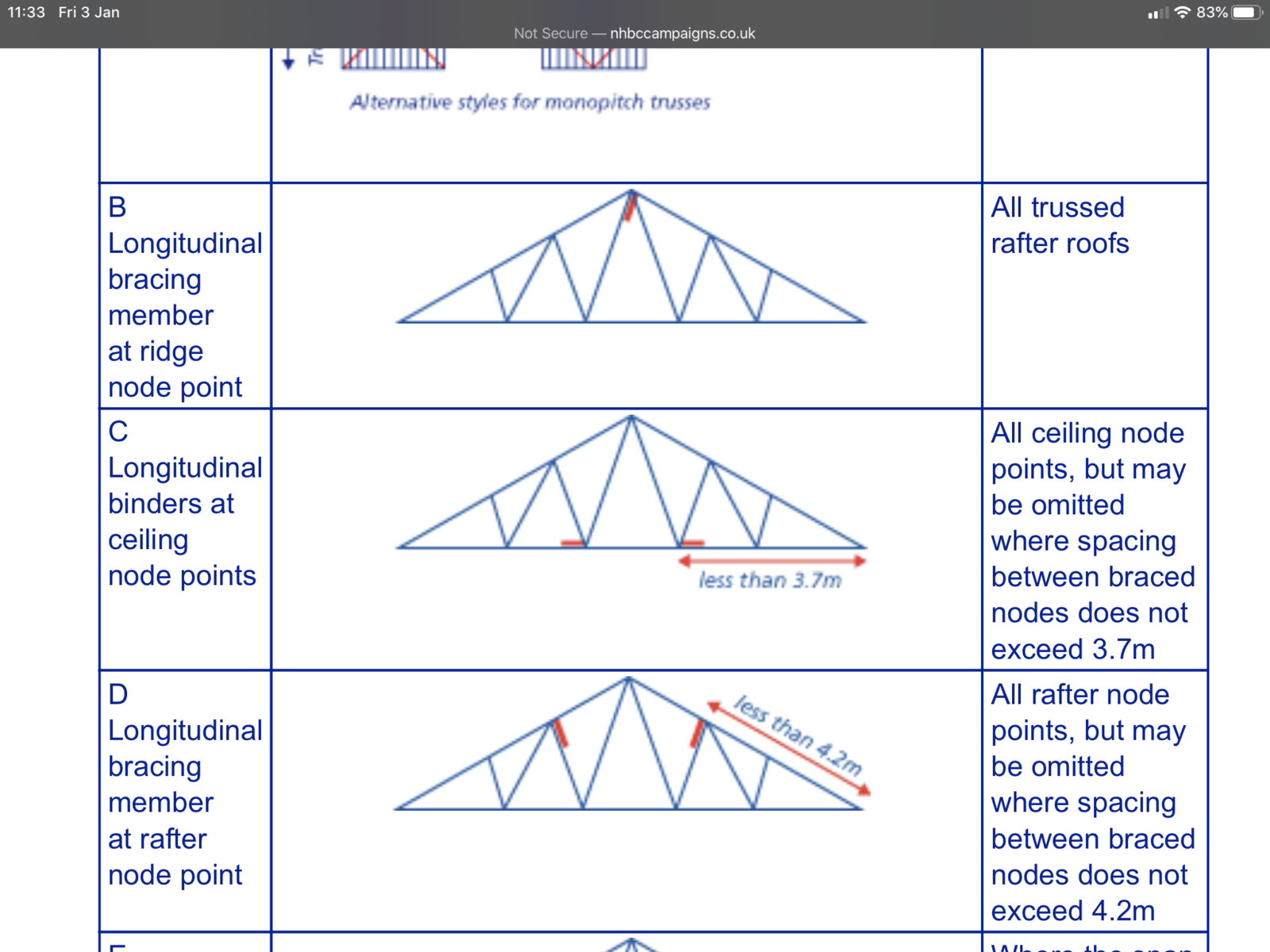

I have a pitched garage roof on a new build (2017) that I want to floor for light storage. I’ve already floored half of it, but want to continue all the way across. But there is a longitudinal binder with a tie to the gable end right in the way of where I want to go. As I see it there are a couple of options:
1. Remove the binder, lay the floor and tie the wall to the newly laid floor (chipboard panels)
2. Leave the binder in place and floor up to either side of it (weakening the floor as the tongue and groove won’t lock together)
Is there a better option, or what am I best to do (or allowed to do)?
For reference, the longitudinal binder is Point C in Appendix 7.2-C on this document http://nhbccampaigns.co.uk/landingpages/techzone/previous_versions/2010/Part7/section2/appendix.htm which I’ve also attached a screenshot of (I only have 1 binder, right below the Apex)
This is a garage roof, not a house roof and the garage is a separate building to the house. It’s a twin size garage building shared with my neighbour (we both have 1 garage door and car space), with a dividing breeze block wall between mine and my neighbours sides of the garage.
