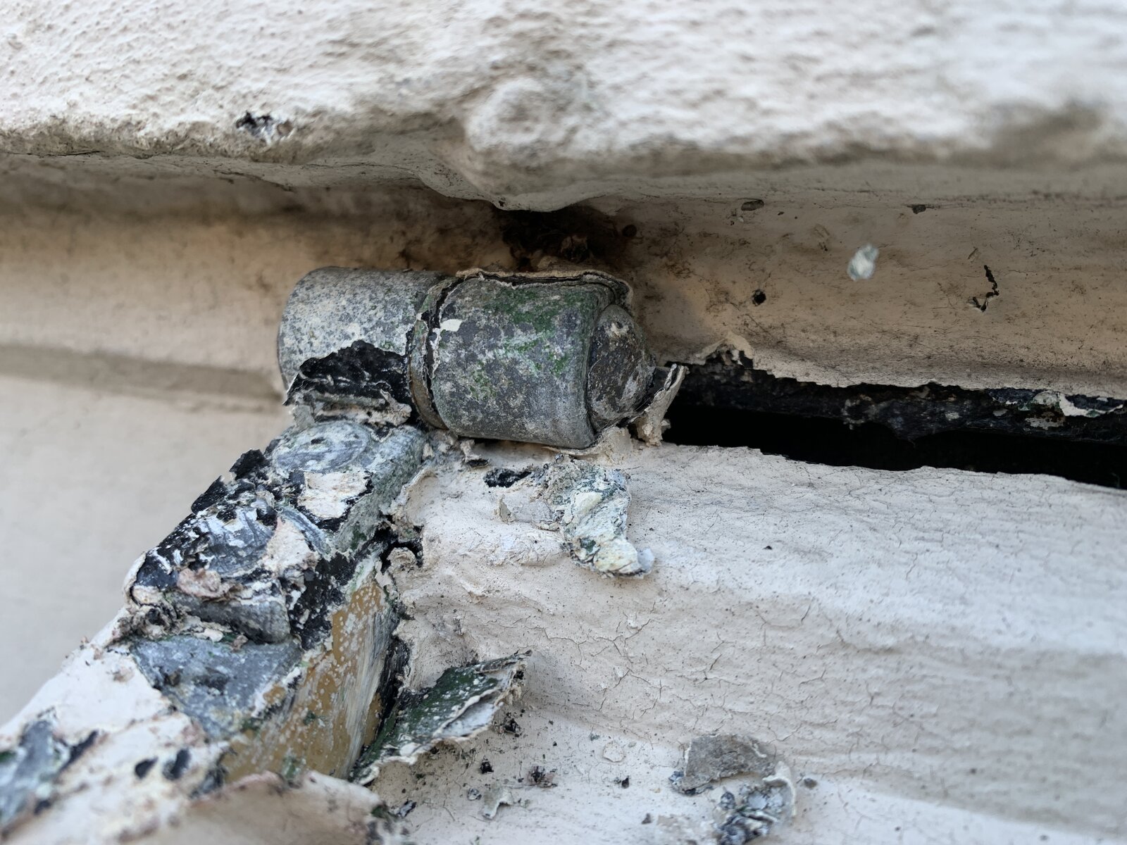

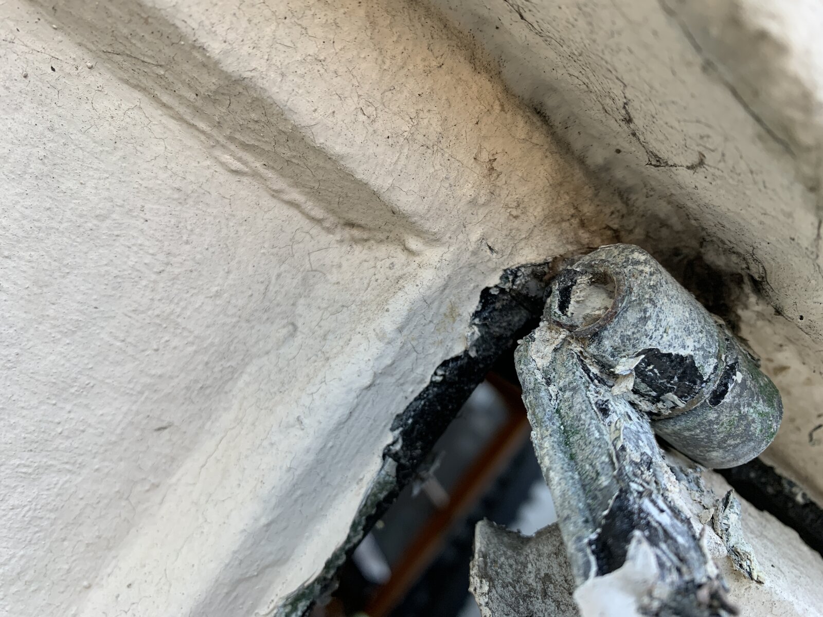

I have an old metal window I am looking to restore. Have sanded and primed inside and the metal is in great shape but does anyone have any idea how to remove these old hinges so I can clean them up, re-paint and reinstall?
Haven't tried anything yet. Thought I would just check on here before I go to it with tools and destroy them.
They look as though they have a peened over pin. I suspect the pin may knock out but I think you will destroy them if you try to remove them. Wire brush to clean up, sand down and then prime & paint.
Thank you so much. I had no idea what these were called but makes my google searching much easier. I may still remove and replace if I can't get them to the standard I want and because it will make wire brushing and sanding so much easier. I'll see if I can gently un-peen them (if that is a word) as they seem to have a hollow centre.
