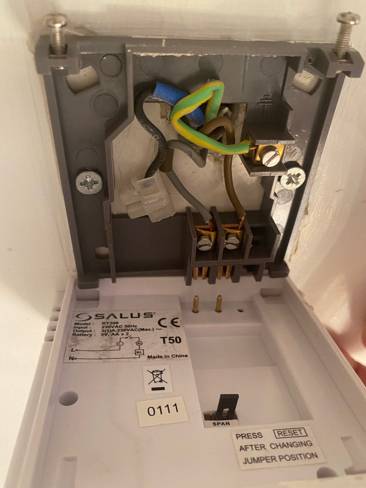

I am going to replace my existing heating system controls with a wireless smart heating system (probably Drayton Wiser). In doing so I want to remove the two existing room thermostats I have (I have two zones for my central heating). They both have three wires (as well as the earth)
  1. black (sheathed in blue) - I believe this neutral
  2. brown
  3. grey
I believe 2 and 3 are the live and the switched live.
What do I need to do to remove this room thermostat?
The two live switching wires in (L) 'Live' and (SL) 'Switched Live' need to be permanently connected together and the other wires isolated separately.
In this case the best way to do it would be to find the other end (ie the origin) of the cable. Note where the brown and grey wires are connected and remove the cable and all of the wires. Then insert a wire link between the two terminals you have just removed the brown and grey wires from so that they are electrically connected.

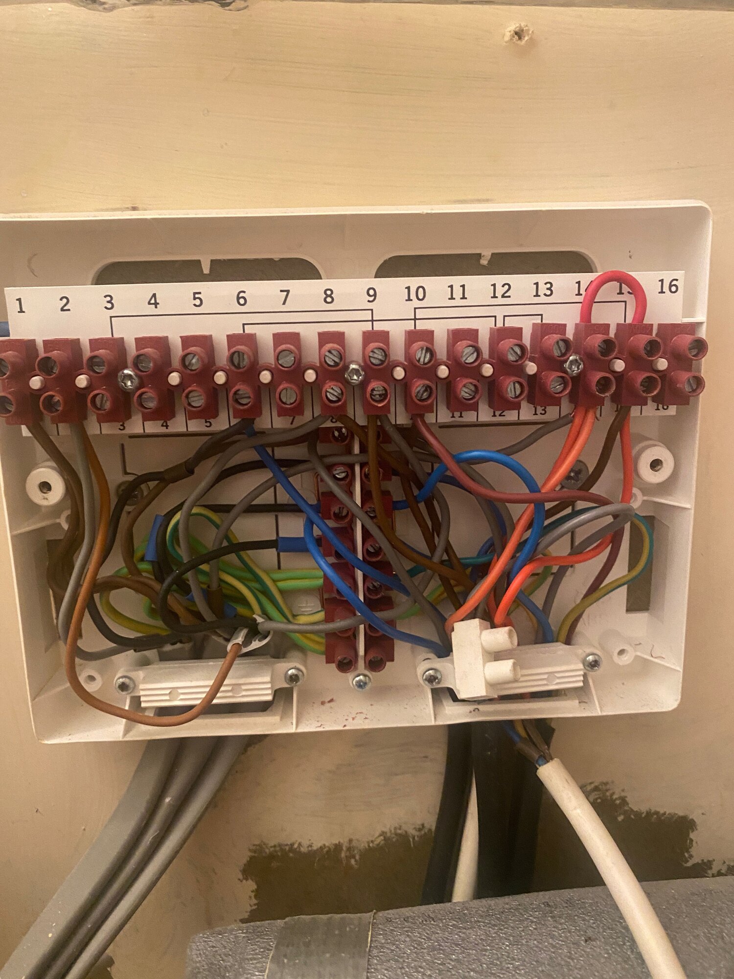

Here is the wiring centre (and a photo of what is printed on the lid). Anyone know which will likely be the ones that go to the 2 room thermostats?
It would seem to be 2 and 3 according to the diagram yet 3 has nothing going to it. Also 2 has a brown and grey going to it (like brown and grey at the thermostat as per my earlier picture) - so these are effectively joined together?!
First of all the nomenclature in the lid is for a single heating zone, so not all is applicable to your system.
The actual wiring is a bit of a rats nest....and difficult to see clearly what goes where. However there are two motorised valves controlling your two heating zones (and it looks like a 3rd motorisde valve for the hot water).
If you can identify the black cable coming from one of the heating motorised valves, then the brown wire from that, will likely be connected to one of the wires going to its room thermostat. Once you have identified the suspect wire, the other wire of course will be in the same sheath. I normally disconnect the suspect cable at both ends and then test it with a multimeter to make sure that it does indeed go to the room thermostat.
The process can then be repeated for the other room thermostat and its associated motorised valve.
