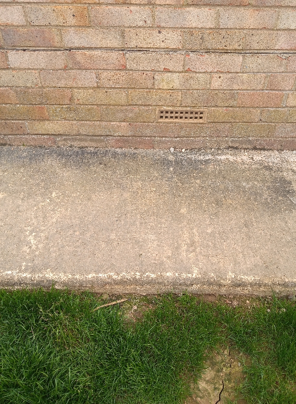

I want to remove the garden path around my house, it's slightly higher than the ground level around the height of a course of bricks (see pic).
So the finished level of the grass in this area will be slightly lower.
Will have to lower a few gullies that are embedded in the concrete path as part of the work.
Am assuming this won't affect the foundations and there is no reason why such a slight drop in ground level should be an issue?
