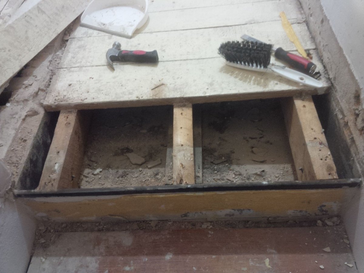

Sorry I can't transfer my photos. I will try to use online images and explain. We have no web/flange available to use. The stairs are welded to two beams of this shape parallel to each other, if that makes any sense.
Thumb.ashx
I don't know the right words but the floor joists rest on the horizontal parts of the two beams (2up 2 down house with stairs across)so there is no web available for stairs. As far as the stairs are concerned it is bit like welded between two steel lintels flush to wall.
Incase this picture makes it clearer.
The beams are parallel like this picture but shape of both beams like previous picture. In between two beams something is bolted here. Instead of bolting we have welded stairs between two beams. There is no top flange for both the beams and the web/bottom flange is occupied by floor joists of both bedrooms.
You need to post an image, it's very hard to visualise whats happening, it is also something very uncommon.
Things to consider: It might be structual, you may need someone in to fabricate any tie in/ strengthening elements. You could get a 'traveler' in to rip the whole lot of for free.

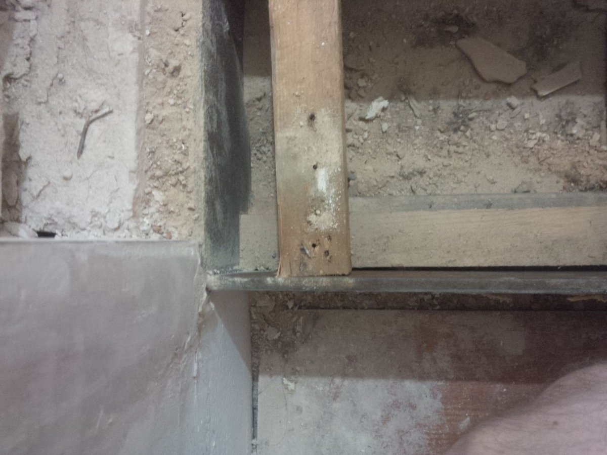

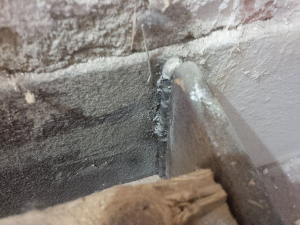

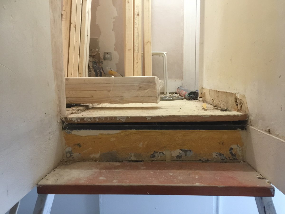

Both sides of the wood stair trade(orange) are two beams. Stair trade perpendicular to the beams. As you can see the beams, top of stair tread, left one is flush with wall and second appears like a skirting. No flange on the stairs side. Black and yellow, bit parallel to the tread and above it, is welded to the off white beams on both sides. The yellow bit is a glue on the one piece black metal which is probably the top bit of the stairs.
Beams are at same level as orange tread. Nothing underneath them.

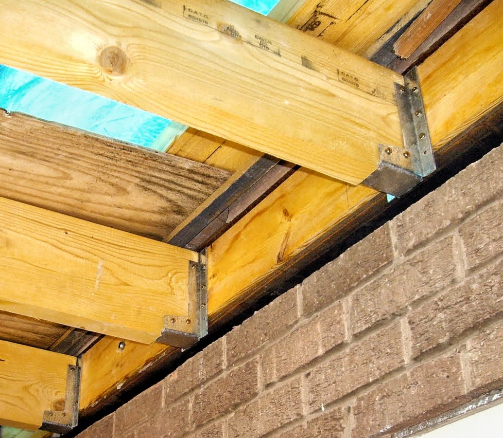

Anyway, here is the principle - a timber fixed to the beam and hangers to the timber.

Can I ask how is the timber attached to the beam? We have no flange/web for the timber to rest unless we drill into the beam. The beam is flush on the stairs side.
