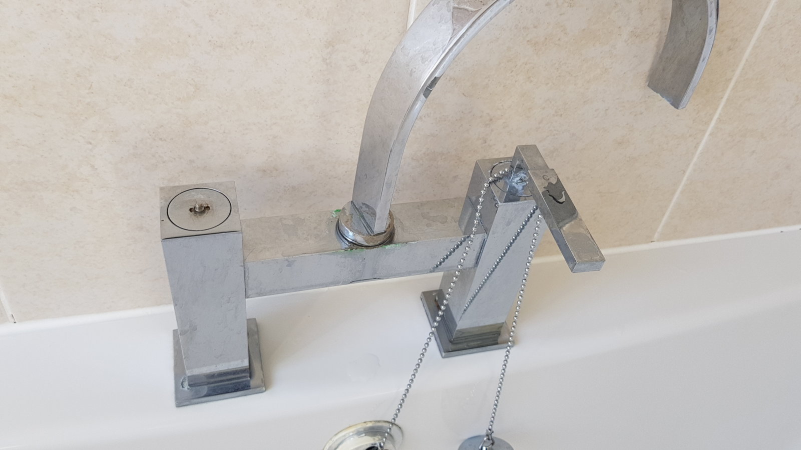

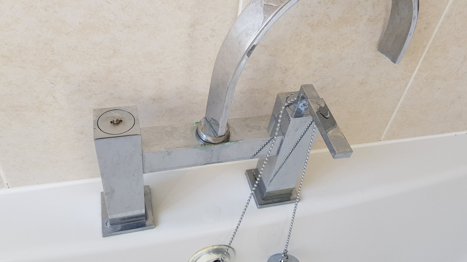

Hi All,
Bit of a dilemma hereo_O.
I need to remove the tap handle/head from a wickes Athens bath mixer tap ( due to a broken handle ) and have no idea how to. A plumber has been around and he also didn't know.
It's going to be costly as the bath tap is installed lengthways against the wall so there is no access to replace. The only options are knock some bricks out from the room next door which has just been plastered or remove bath, screen, tiles etc.
Any ideas? There is no grub screw holding it in place.

Thank JohnD.Another photo...
Yes as above spoken to wickes. I think the tap is about 8 years old. Wickes seem to be selling a few in remaining stock

are there no hidden allen key holes?
Often they are sited underneath or behind, and my kitchen taps have a very small allen key

No just a single hole but no screw and when you turn the tap the whole closes up as if it moved with the handle. There is one hole to remove the arm where the water comes out.
I'm stumped!

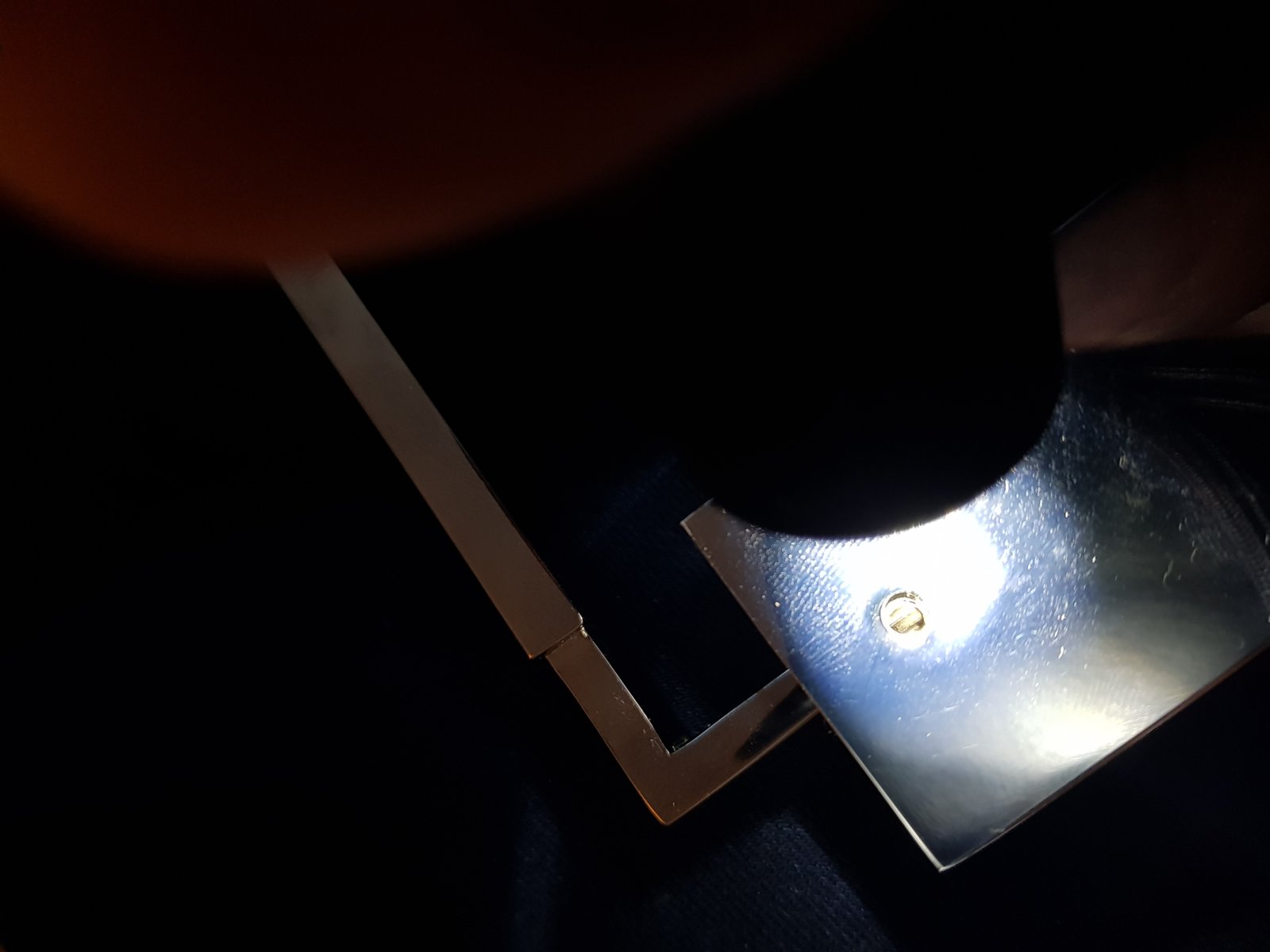

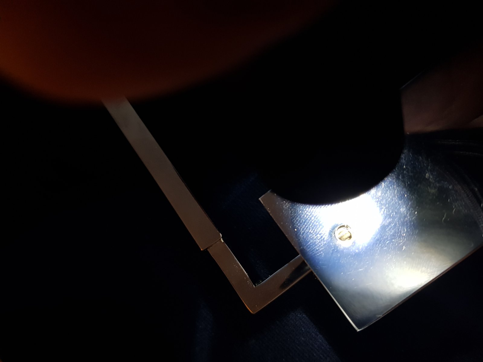

So have you actually tried to insert an Allen key?
Mine isn't about 2mm in size
Yes various sizes. If you look in the whole you can just see the brass top of the tap valve (the bit with the lines going down)
