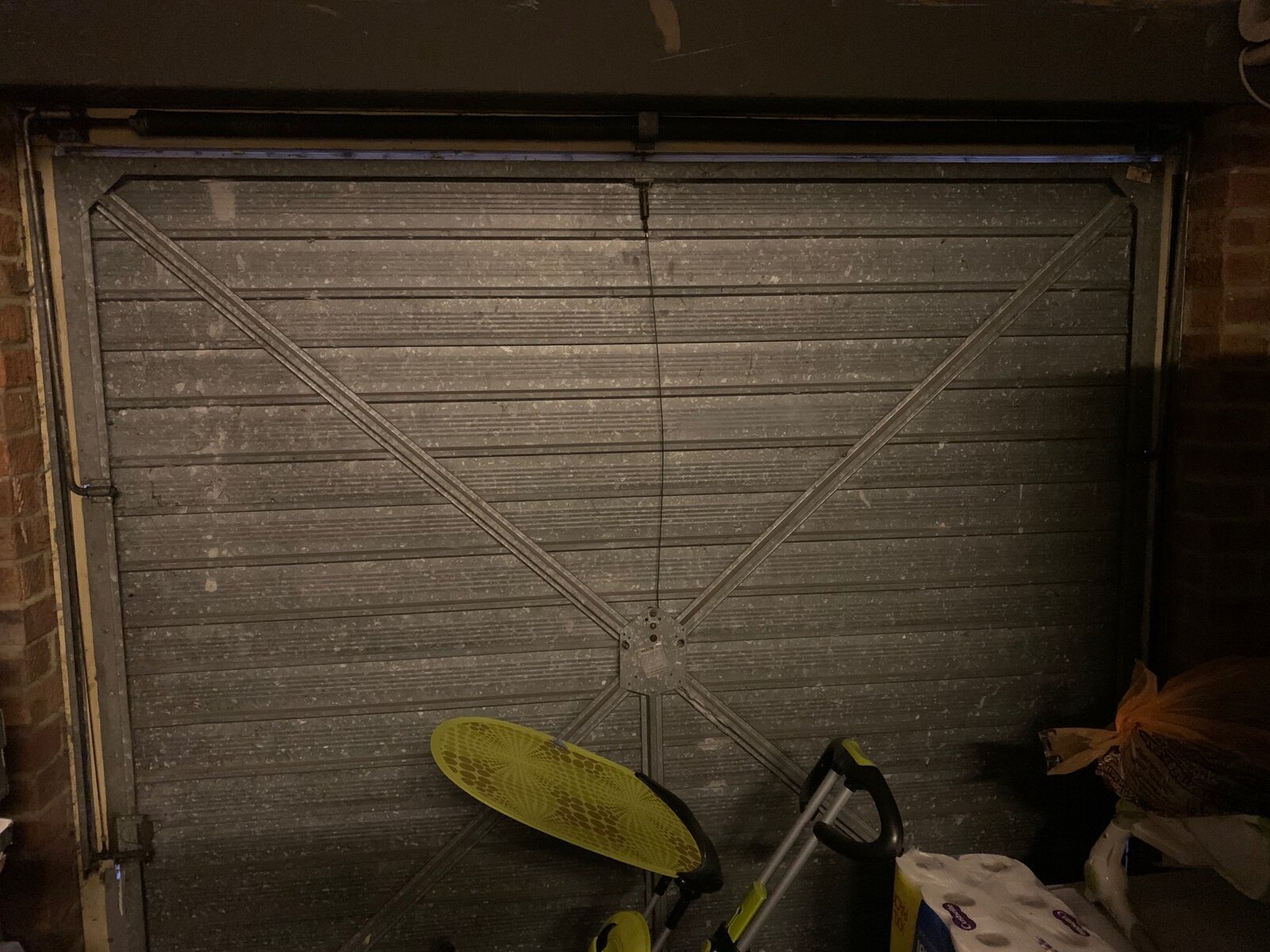

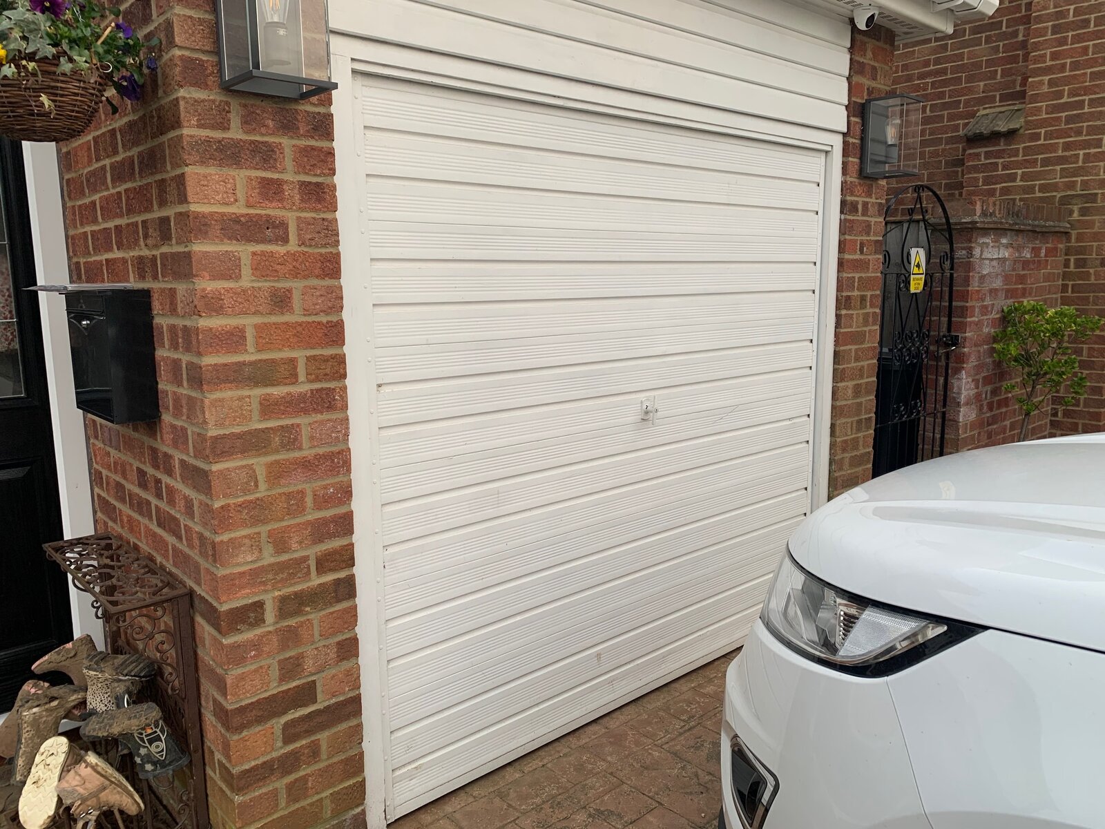

Hello, I've got a side opening garage door coming to replace my up and over garage door and I'd like to remove the old one without maiming myself. I've spent some time googling and still not 100% sure on what to do.
If I have the door in the open position and detach the side bits, does this render the mechanism defunct ? or do I still need to release the tension in the top bar ?

Is it a torsion bar?
The door looks like a Henderson to me.
Pretty sure you have to carefully unwind the springs to remove the tension
Yes, its a henderson merlin mk 2. Torsion bar at the top. So, I have the door in the closed position and unwind the tension first ?
cheers.
If your not reselling it then just snip the cables, the spring has the rods going through it so will stay in place but unwind itself quickly from memory 36 turns, or you can buy a kit which includes two R clips so you can lock it off and remove the complete door and spring left in tension

If you're doing this yourself, invest in safety gloves and a decent pair of safety goggles (not just safety glasses)
Actually, although people will think it's complete overkill, I'd also consider getting a face safety shield to protect the rest of your face. It's obviously good having the eyes protected, however should something spring back at you, best if your entire face is protected.
