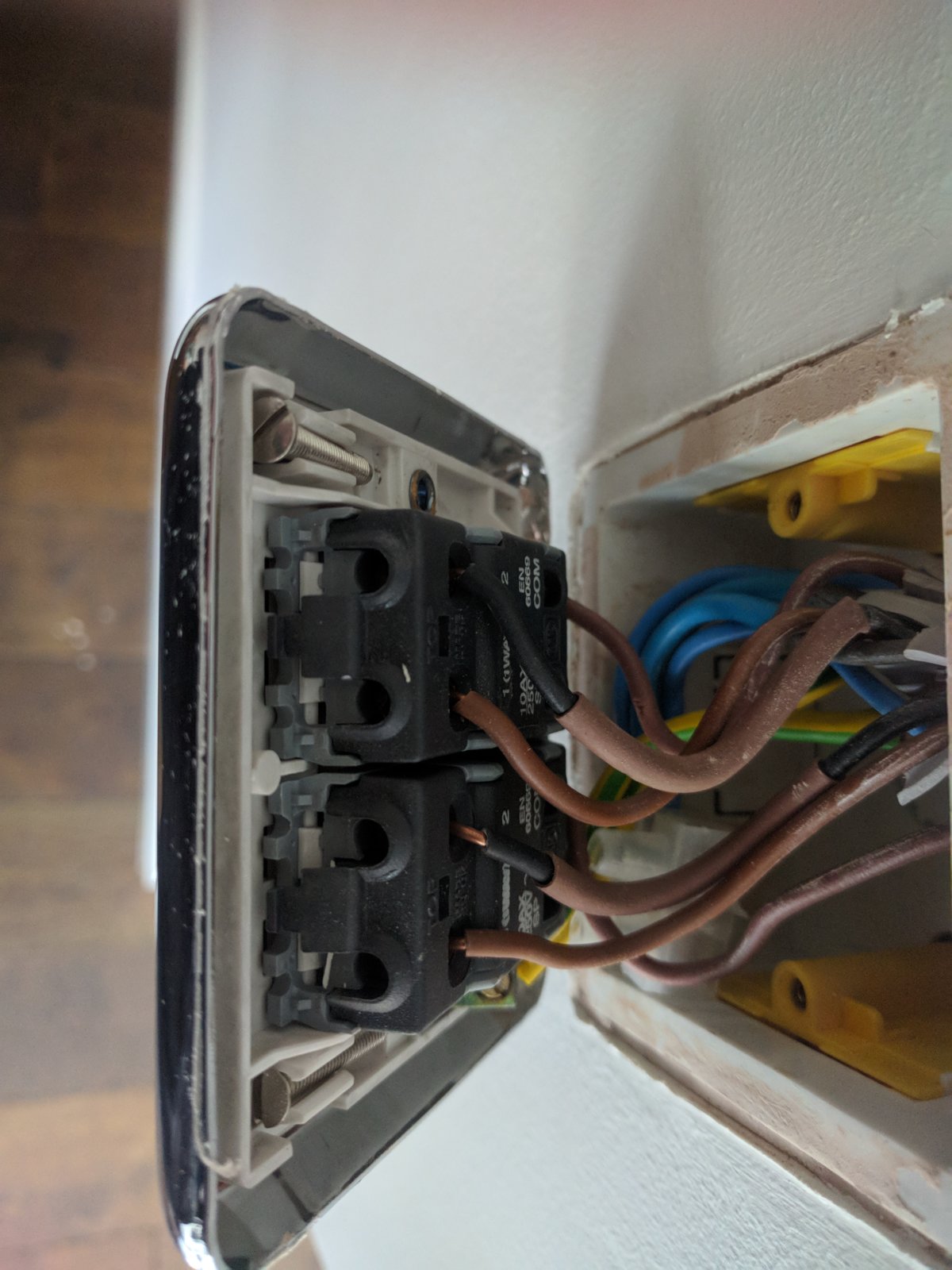

I have 2 x double light switches in my living room, wired to work 2 way, in plastic back boxes.

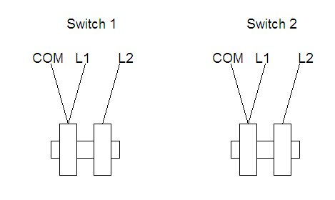

Both double switches have the same wiring configuration:
I wish to remove one of the two double light switches. Is this correct:
1. Switch off lighting circuit fuse at the fuse box
2. Left hand switch: COM + L1 into terminal block
3. Left hand switch: L2 into separate terminal block
4. Right hand switch: COM + L1 into terminal block
5. Right hand switch: L2 into separate terminal block
6. Earths into separate terminal block
7. Blanking plate over where the existing double light switch was
Steps 2 - 5 are better illustrated on another post on these forums:
https://www.diynot.com/diy/attachments/upload_2016-9-4_21-26-46-png.104606/
Finally, on the remaining double light switch, can L2 (black with brown sheath) then be terminated into a terminal block? I'm asking because I may replace this remaining double light switch with a LightwaveRF Gen 2 Dimmer, which only has connections for live and switched live:
https://support.lightwaverf.com/hc/..._Smart_Dimmer__2_Gang__Installation_Guide.pdf
If I'm totally wrong on the above, I'll get an electrician to do it.
Thanks for any replies / answers!
That means other connections have been made probably in your ceiling roses (good news) or a hidden junction box (bad news). Have a look inside your ceiling roses or back of fittings which ever is applicable.
Since there are aren't any grey cores going to the faceplate, it looks to me like the the switches are fed, with the 3 core between the switches each carrying two strappers and a neutral - grey being the neutral.
So I wouldn't expect any hidden junction boxes or ceiling roses stuffed with connections - looks like the joints are at the switches.
