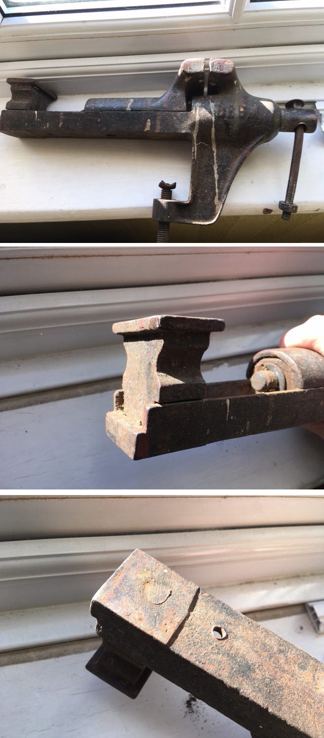

I'd like to dismantle my grandad's old vice and give it a good clean and lubrication. However, taking it apart seems to hinge on removing this cotter (I seem to remember them being called split?) pin. Given its location, I can't get a huge amount of leverage on it. Either to punch it out at the end
or say, bash a punch into the head hole.
Anyway, does anyone know how to best remove them in similar positions?
Any advice much appreciated.
It doesn't look like a split pin to me. Might be an odd screw someone tapped in?
If it's tricky, file off one end and punch it through. Or pull, it will be easier once you filed off the enlarged end.
A parallel punch, with a flat, not pointed, end.
Get a can of Plus-Gas if you can find it.
Stand back and take a wider photo please. Topside and underneath.
The maker's name and model number are probably on the castings.
Its a split pin with the round end slightly flattened, I think.....
Give it a good drench with penetrating oil first, but heat will help.
If you cant punch it back, you can always cut the head off and punch it through or even try pulling the ends.
I use a set of cutting edge pliers to get a purchase, not cutting through obviously!
If you remove all visible bits you can pull the vice apart and then deal with the pin at your leisure.

Cut off the open end ( only thing that keeps them in place ) the tap out with small Allen key.Or looks like there is room to tap a nail in top end which should force it loose .

Here you go @JohnD I think it's a DRGM? I thought the end stock might be removable but it looks like it's welded in place?
I think that end is cast iron, and it’s rivetted in place.....we can just see the end of the rivet.
John :)

Can you get a dremmel cutter in there to cut off both ends? I'd go for the split end first then try to get a small cold chisel into the eye and see if it will lift a little.
Once you start getting it out of the hole as far as you can you can then bang the eye a over a bit to give you more space to pull/lever the rest out.
Failing that try to chop both ends flush with a sharp cold chisel then withdraw the jack screw(?) to be able to remove whats left.
It can be done but these types of problems just require a bit of thought and plenty of patience.
