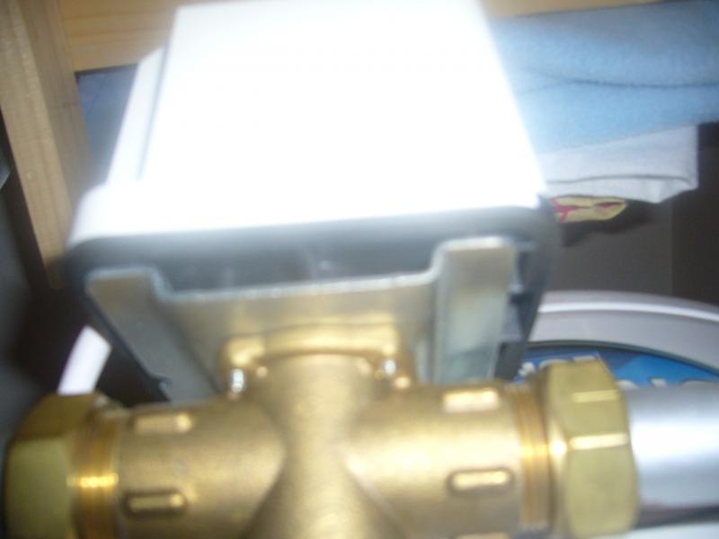

Hi does anyone know how to remove the casing on a 2 port diverter valve its a range make and is white. But looking at it i cannot see any screws to undo to take it off so any ideas would be great many thanks. And yes i will disconnect it from the mains power supply.

What it is, you see is that if i give the diverter valve head a gentle tap it then starts to open the valve to allow the hot water through to heat up the cylinder. after about a day the water starts to cool and then we give it a gentle tap and it opens up again. What i wanted to check by taking off the head is that the wires are screwed down properly and tight as it might just be a loose connection.

Not very likely to be a loose connection!
Much more likely that its a tight cog or seized up motor spindle, even a tight valve spindle.
However, all those possibilities will need the head to be removed AFTER the supply has been disconnected so that the inside can ben inspected.
I always manage to see how to open them by looking at the outside. In this case a telescopic inspection mirror may be needed to look at the underside.

Thankyou Agile i have been looking around the valve and still cant see any where to open it up so i will disconnect the mains and give it a gentle pull to see if it will lift up.

FFS..Just pull it off it will come off the valve body and then you will see the screws underneath to get into the motor etc. You wont blow anything up or kill anyone
