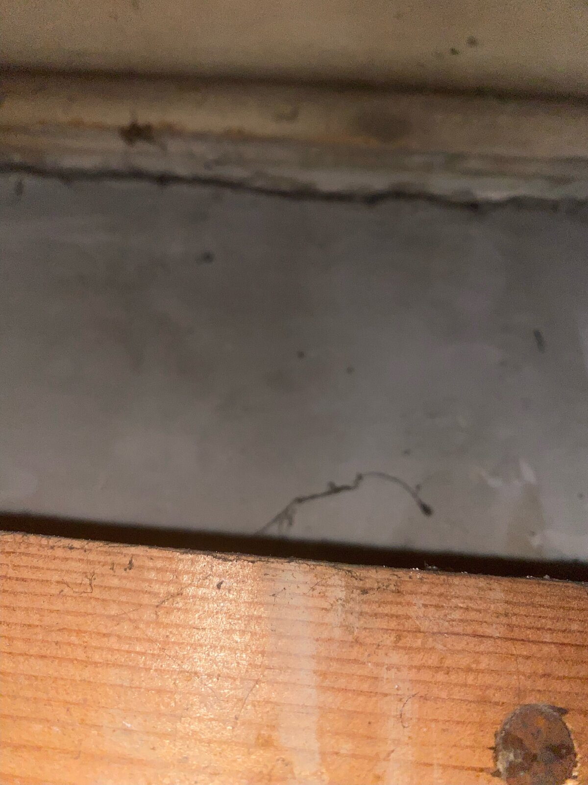

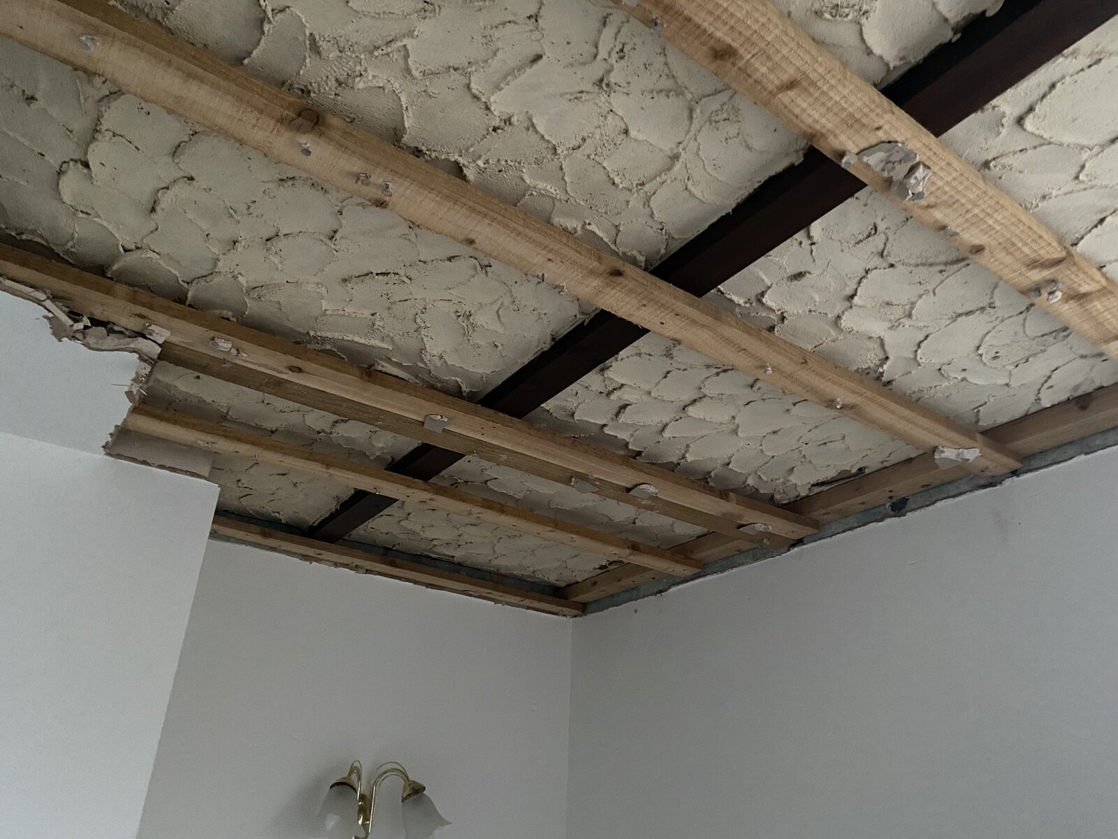

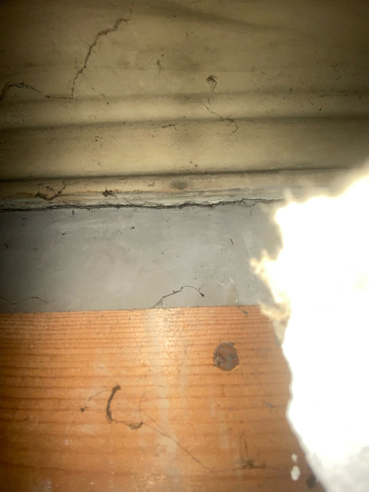

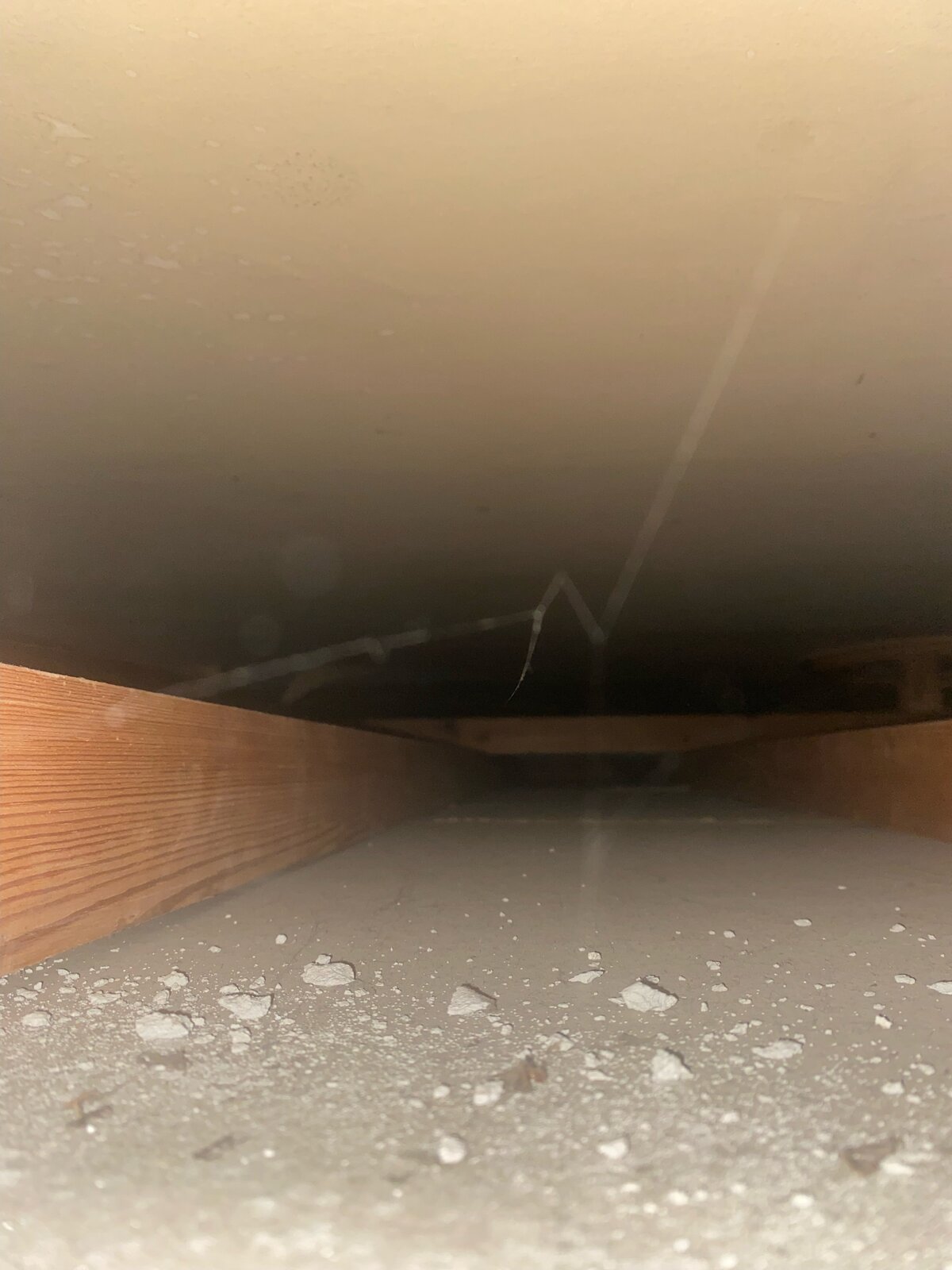

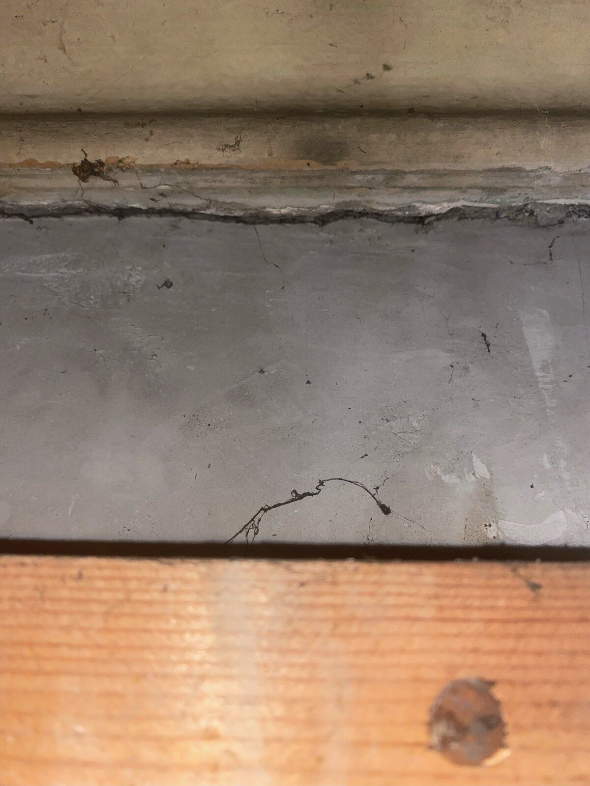

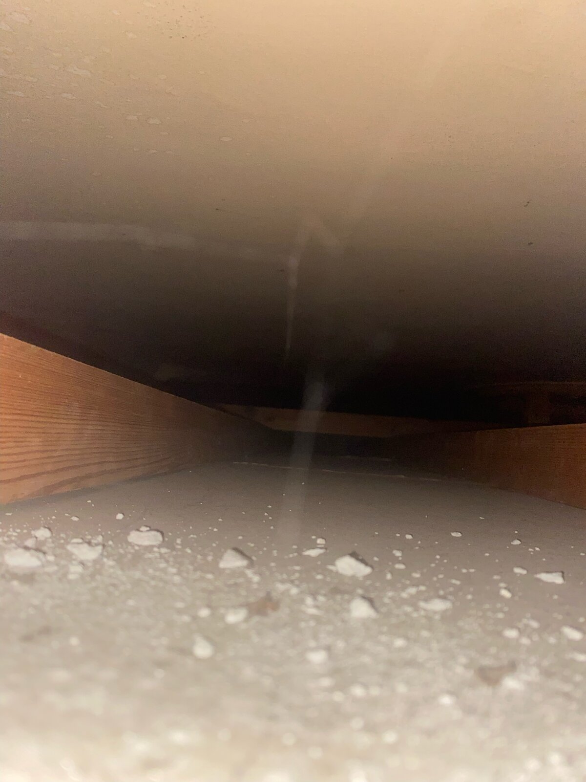

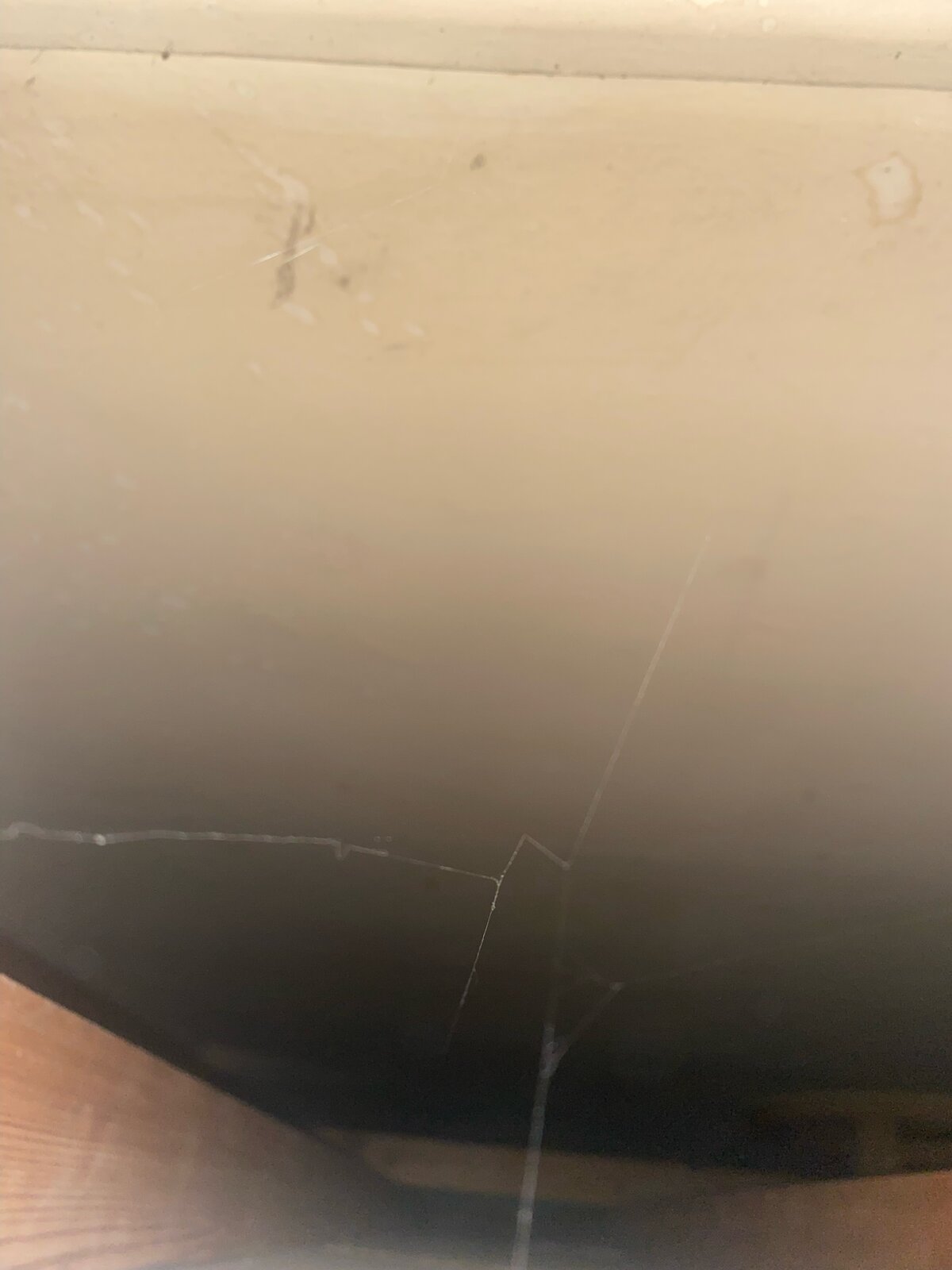

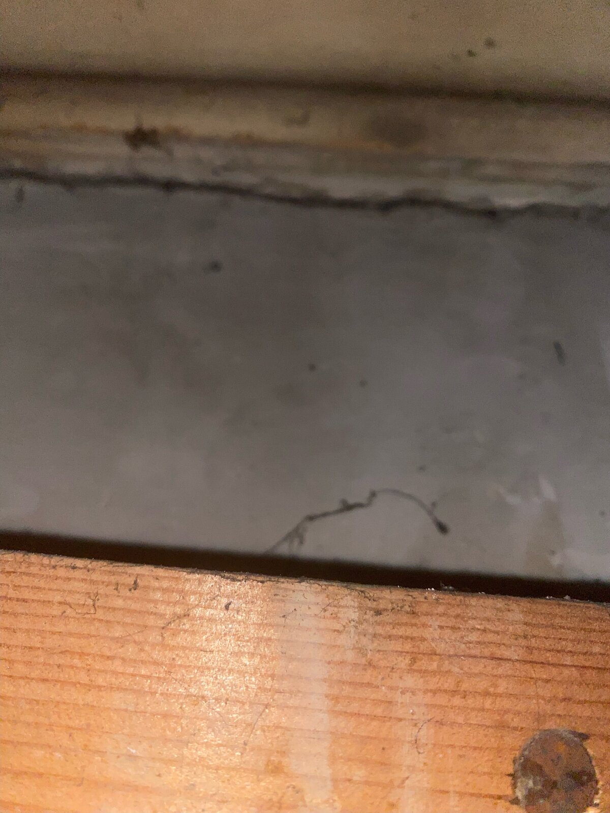

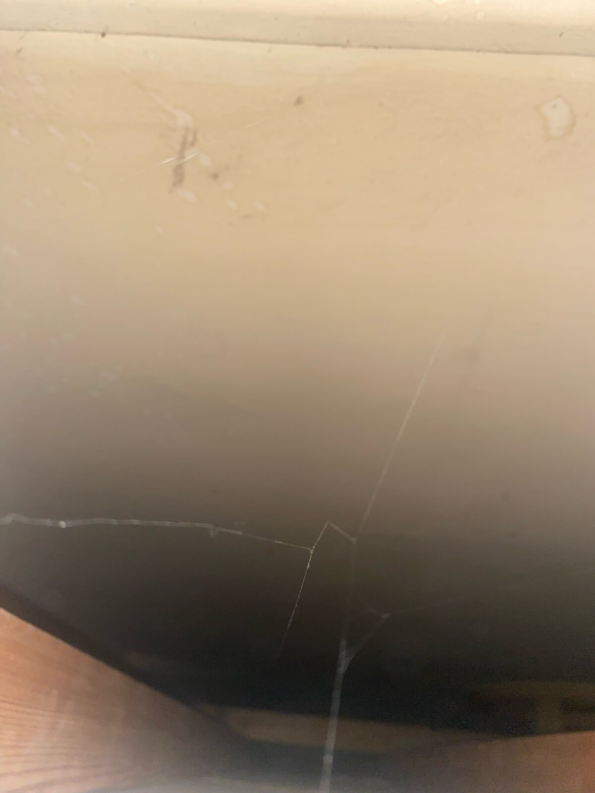

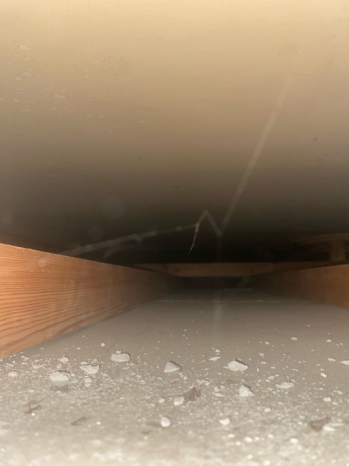

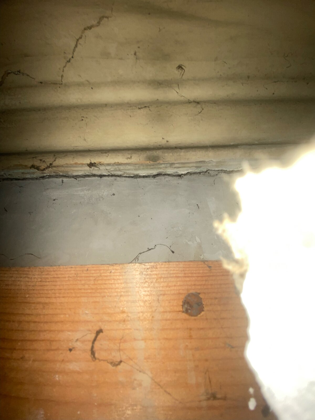

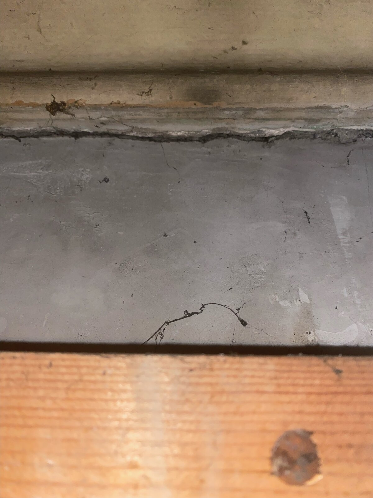

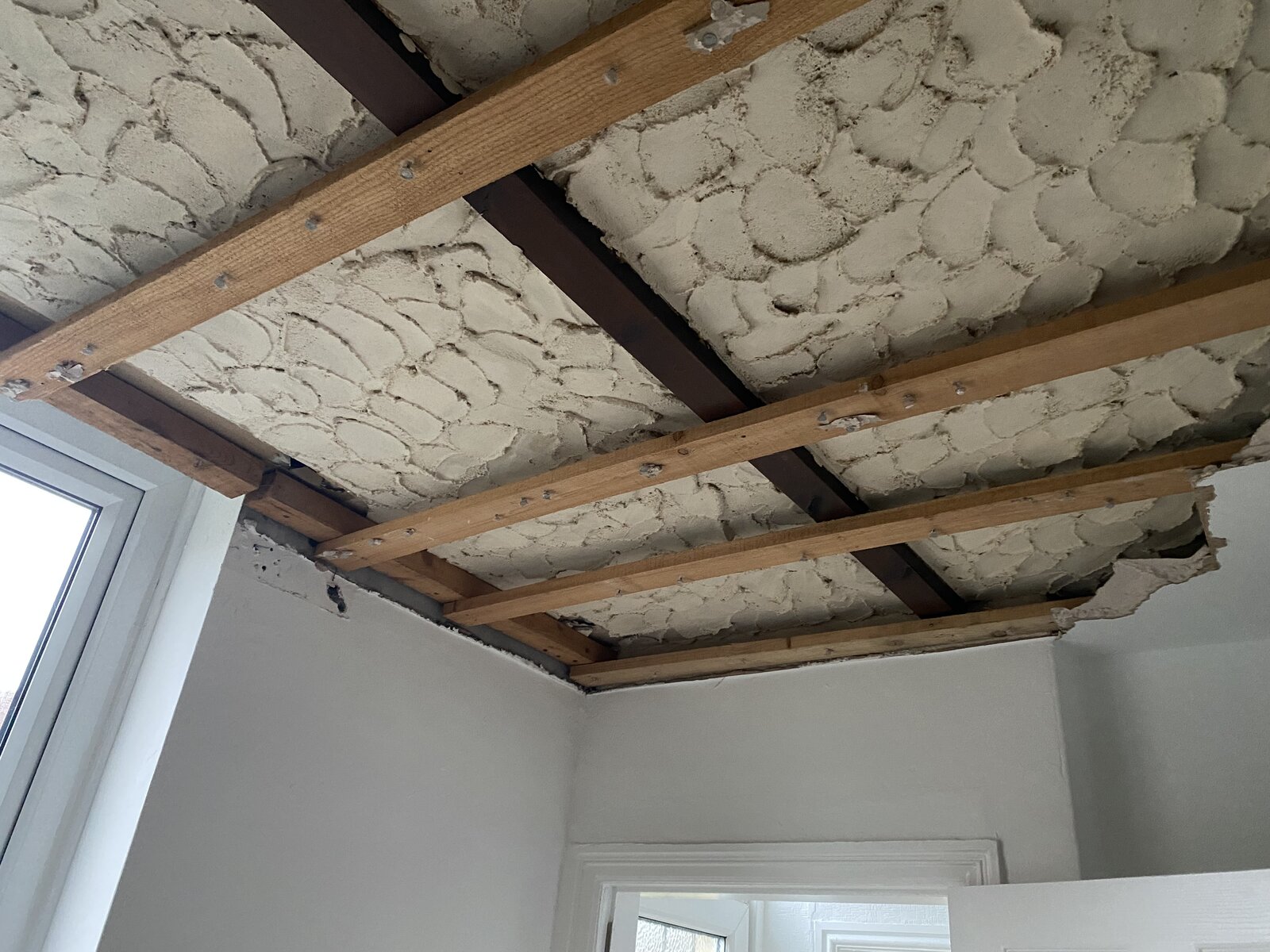

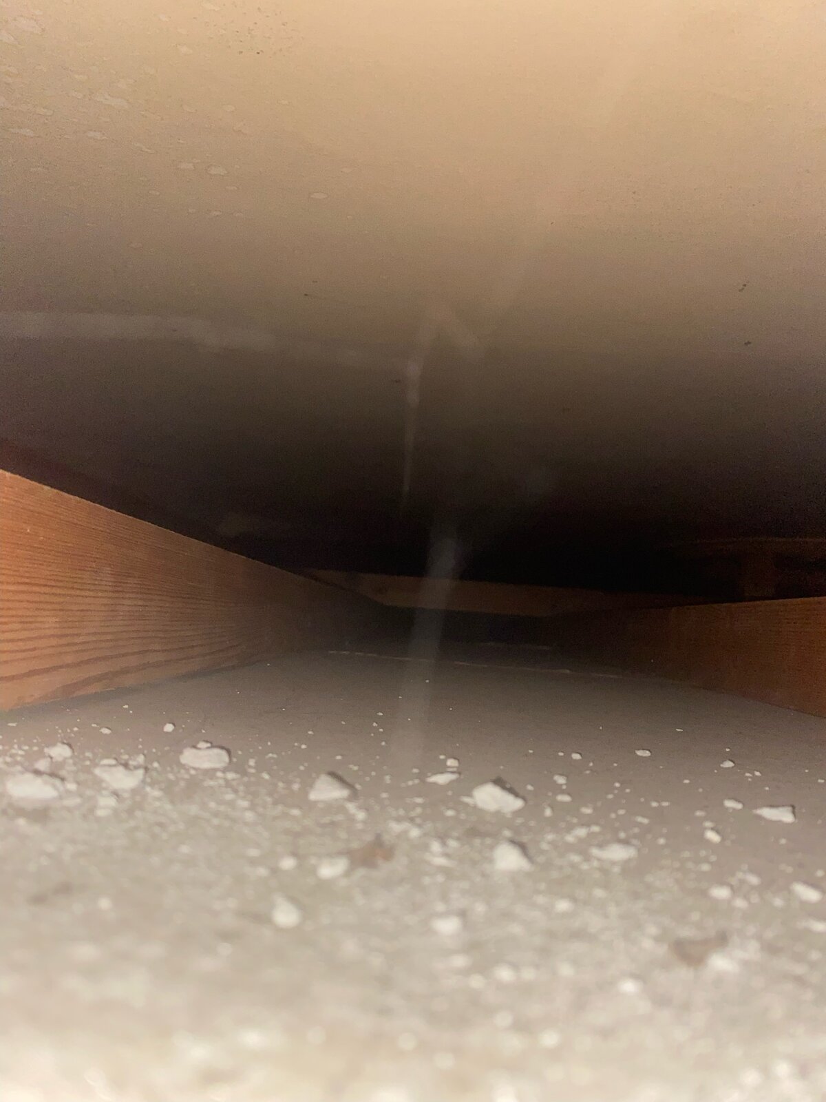

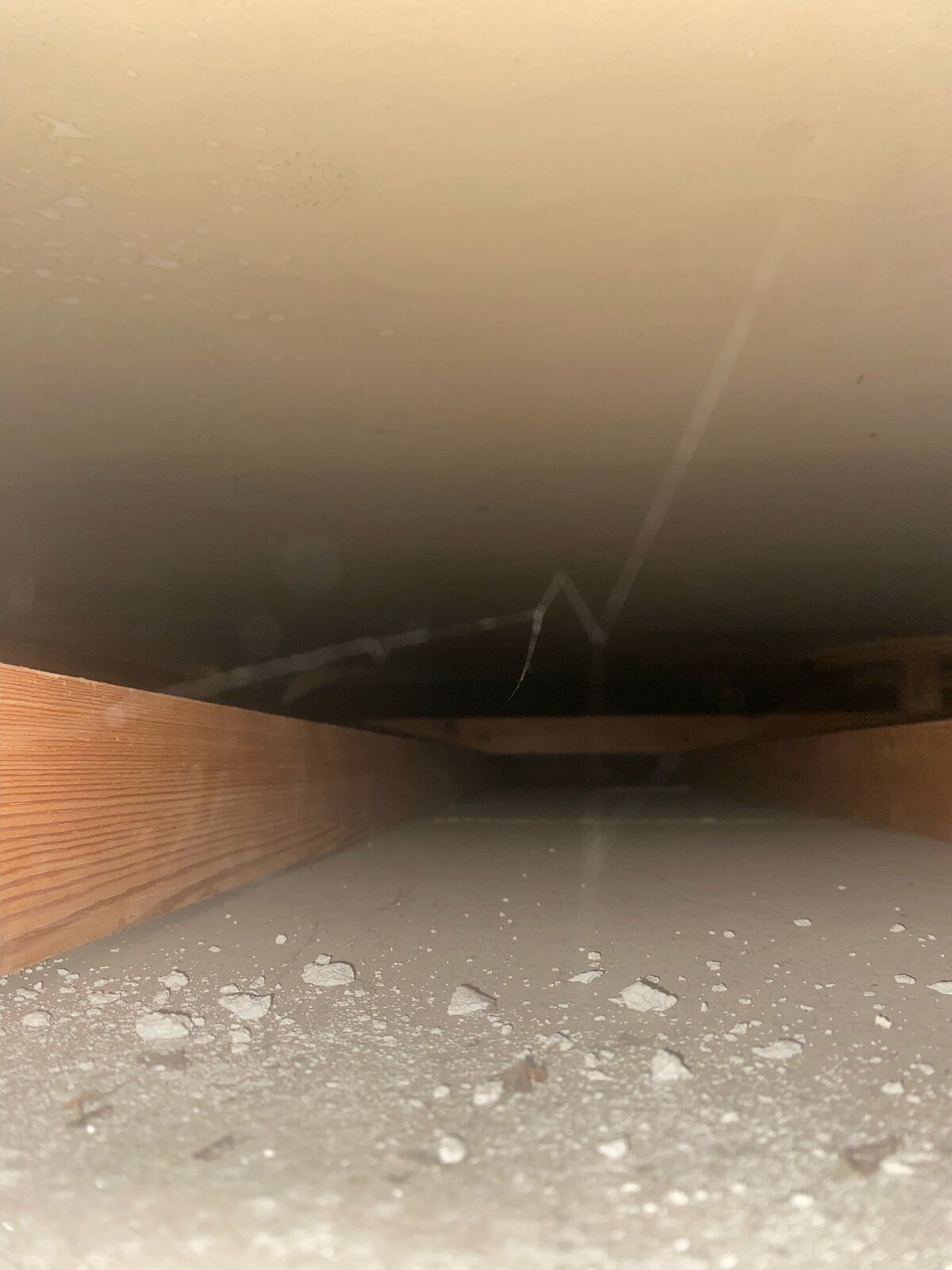

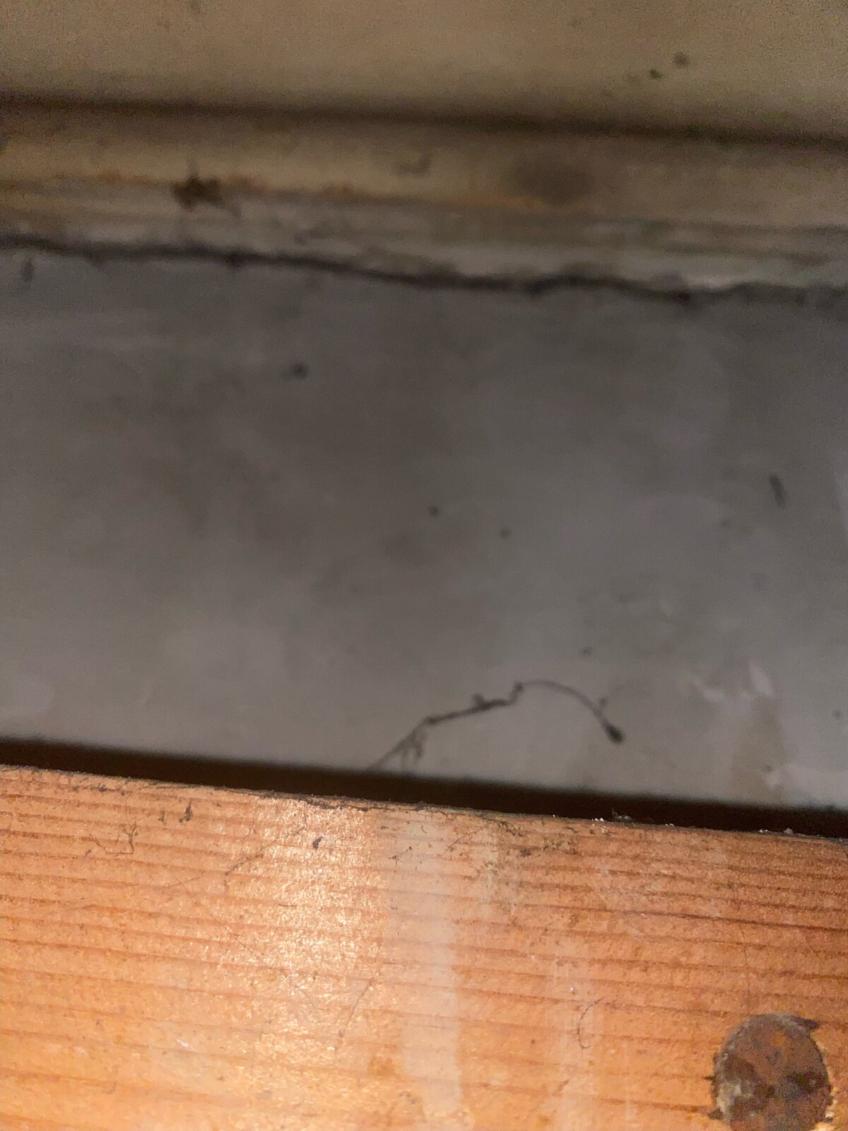

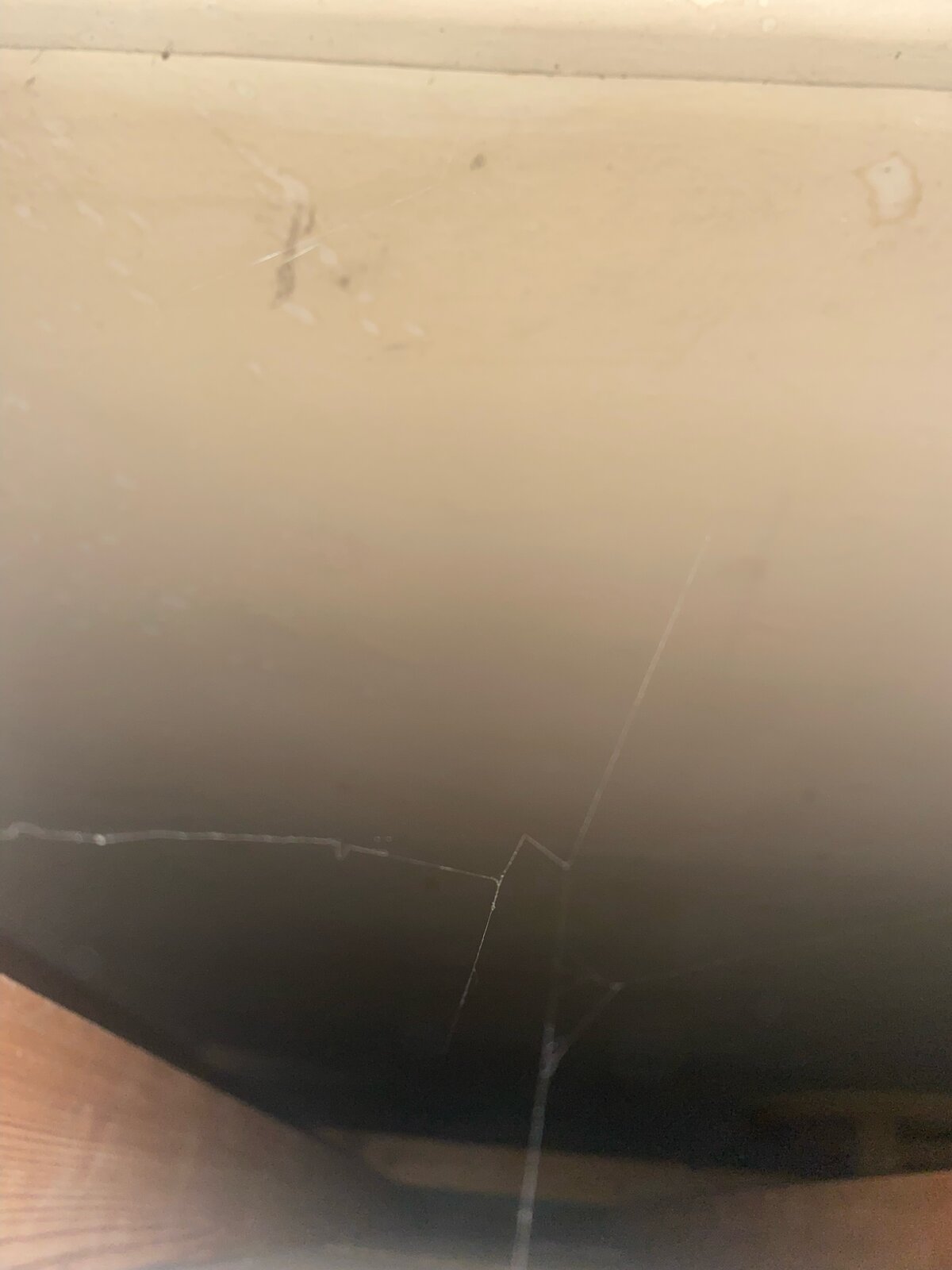

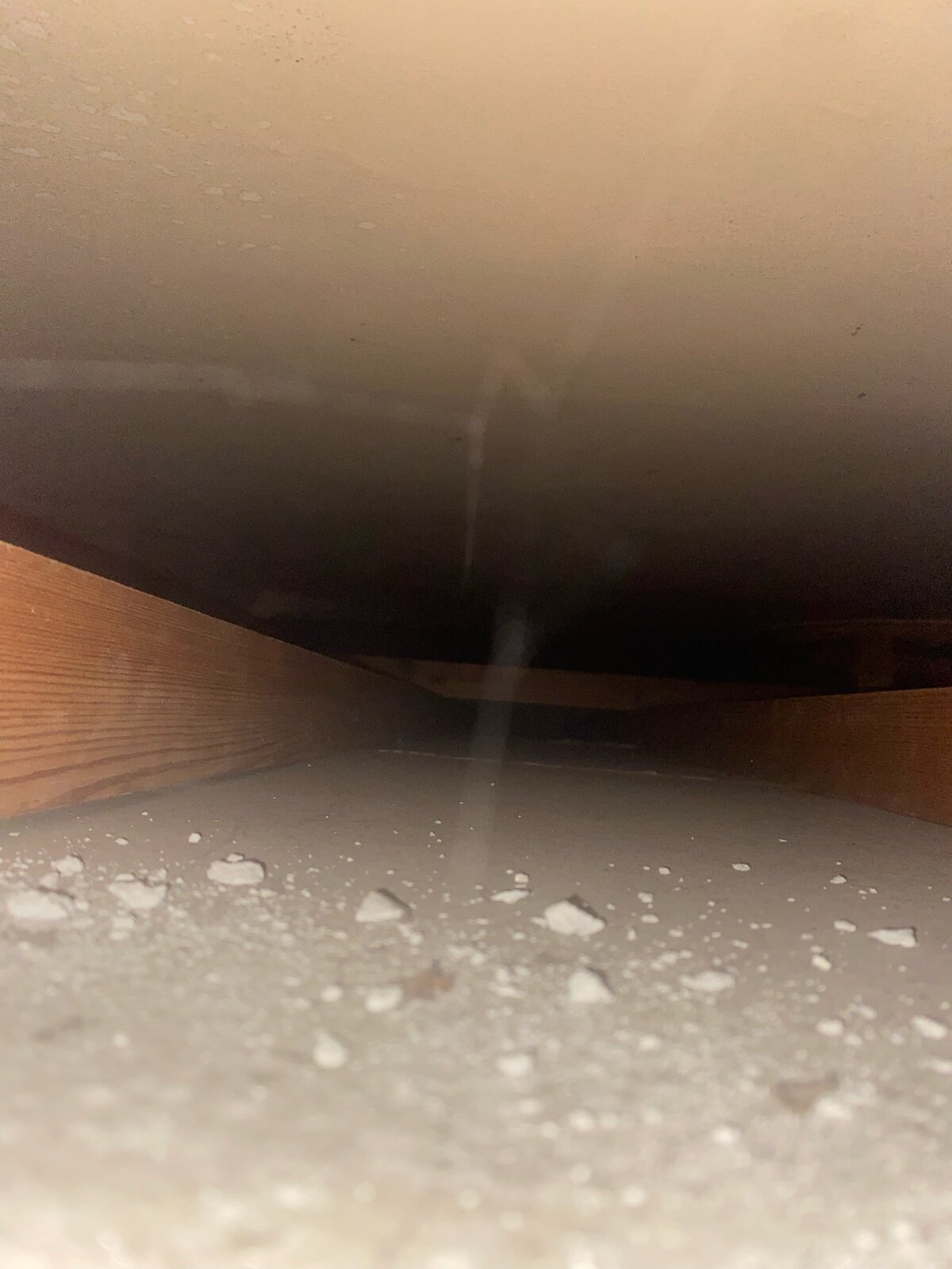

Any thoughts/ advice of how to safely remove - do you think this is asebestos , think is plaster on plaster board
Believe this false ceiling was put in to save money on heating and to cover a poor lath and plaster ceiling
Want to restore old coving and ceiling !

Lath and plaster.
Running coving I guess. It's moulded by using a template and dragging along. Called running cornice. Unlikely to be any asbestos. I've taken loads down.
I have seen cornice left up as by cutting along on ceiling. You can also repair it by making a template.
Proper eye protection and respirator when you remove ceiling..
You will need a skip.
If you can get above kick it down.
If not bash from below.
Omg its messy

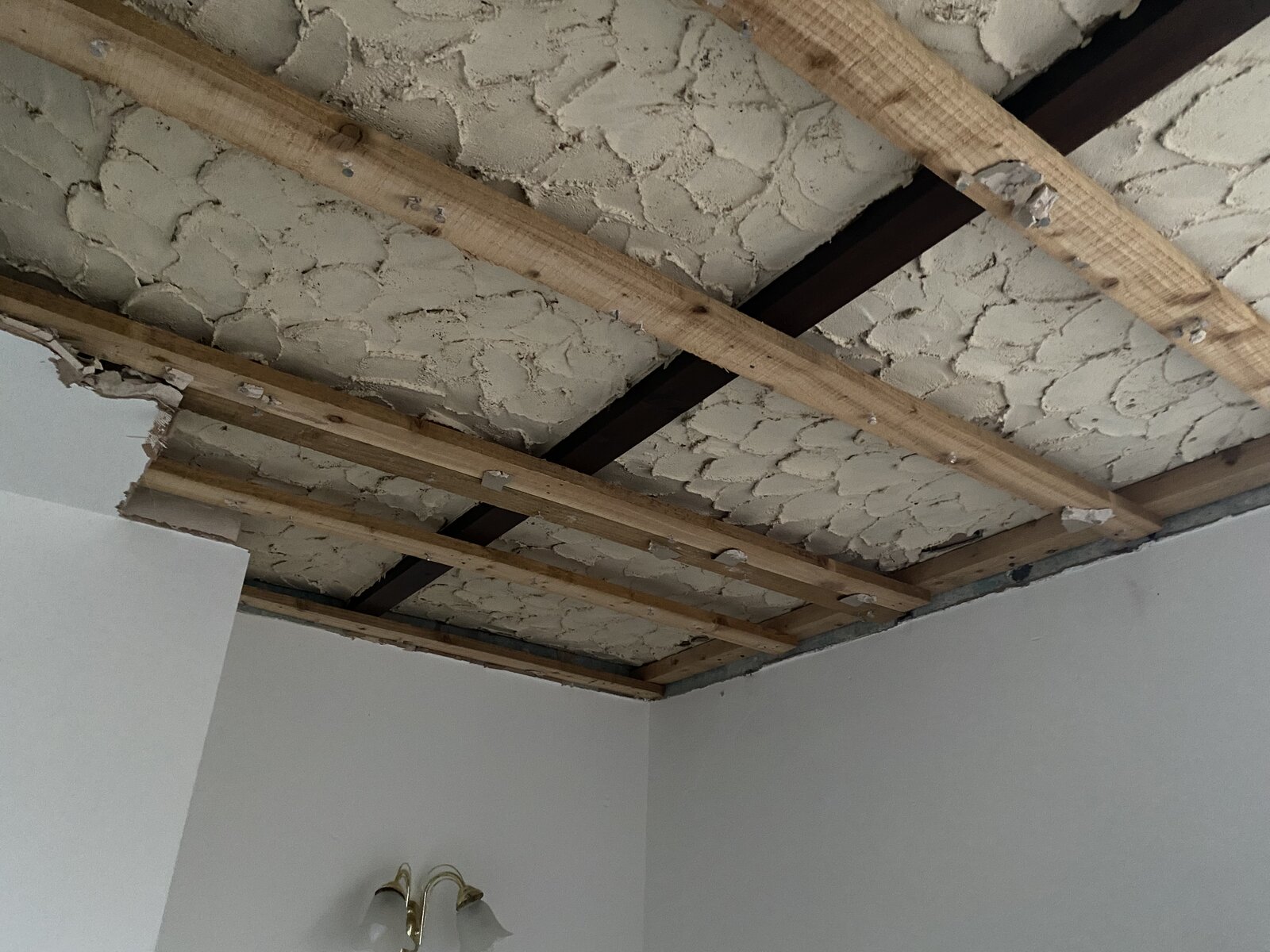

We use a crow bar and a claw hammer. You may need a screwdriver to remove the screws (?) after the plasterboard is pulled.
Yes done that for one layer and I’ve now got the ceiling and beam
Think it’s just like plaster on plasterboard and then the beans but we just wondering if that plaster safe and what we takeoff first
