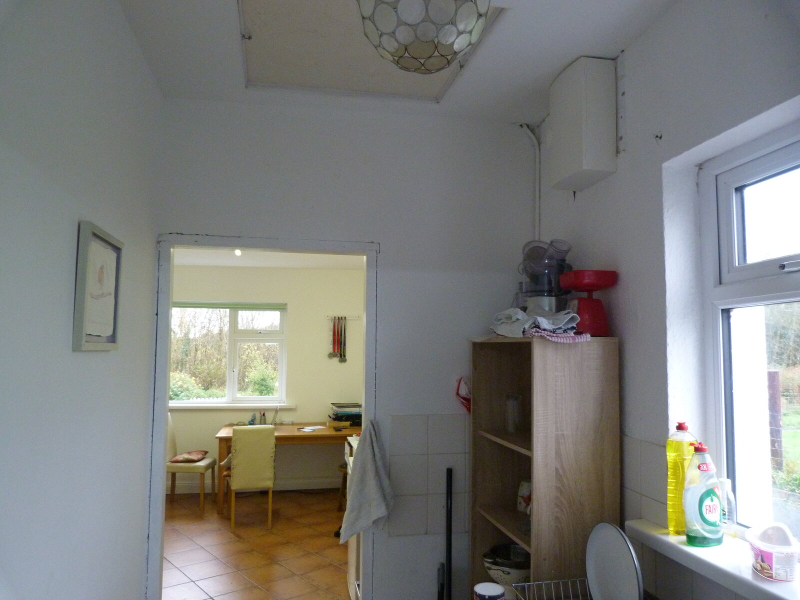

We have a wall in our kitchen that we want to remove. We want to run the new kitchen along the wall where it is. It is part of a doorway and we have had an engineer confirm it is load bearing. This is a bungalow with no upstairs and It's only two feet wide. We are living in Eire now, it's very difficult to get builders, so we are considering doing it ourselves. Is there a thread on here for doing it yourself? We have been kitchenless for over a year now and can't fit it until the wall is gone....

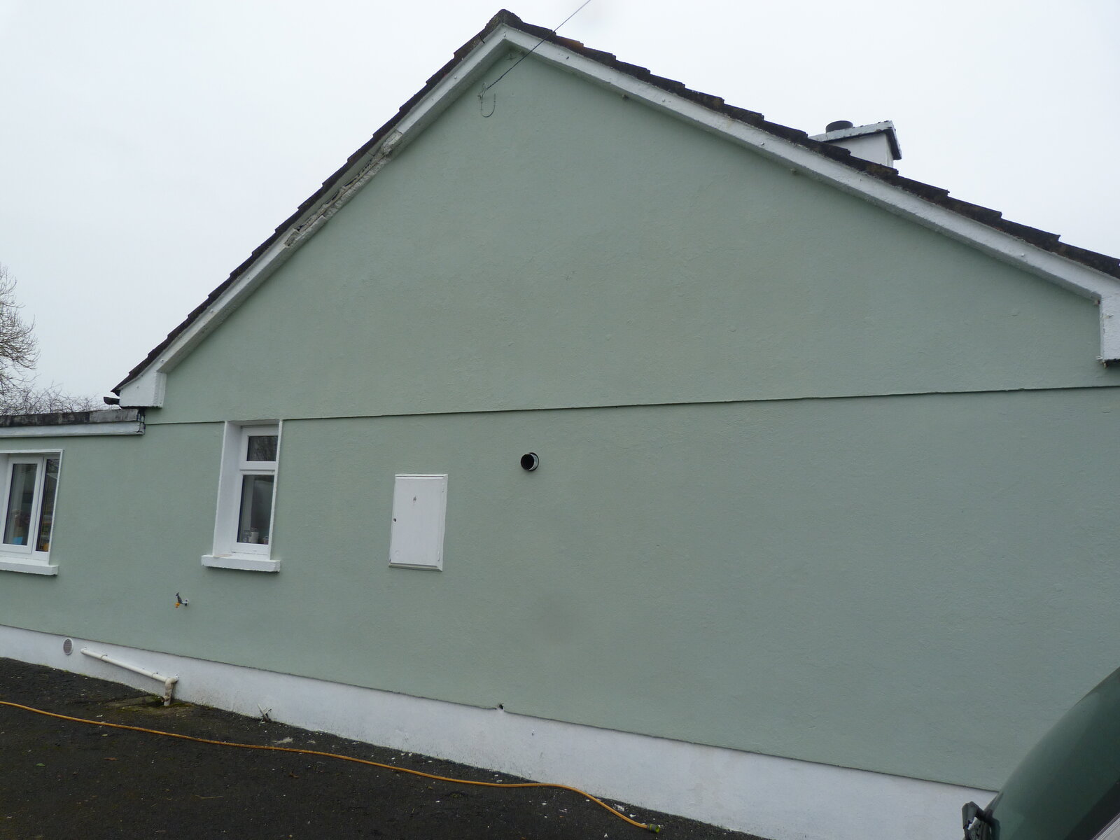

Thank you. That wall is the bungalow end wall, the short one if you get me :) We had hoped that the old door lintel went as far as the wall end, which would have made life easy, but apparently it doesn't.

What's above that short section of wall? If it's just ceiling joists the load is tiny and you could take the wall out and replace with a concrete lintel - with some simple temporary support.
Same picture, same angle etc but 6 feet upwards in the loft please
I will try and get up there and take a pic. As far as I know there's nothing up there, but the engineer sez its too long a span for the roof truss if that little wall goes without a support. He was mad though, he left the handbrake off his car and it rolled into our flower beds, he forgot the stuff he took in the attic and hasn't billed us yet. He came in March....

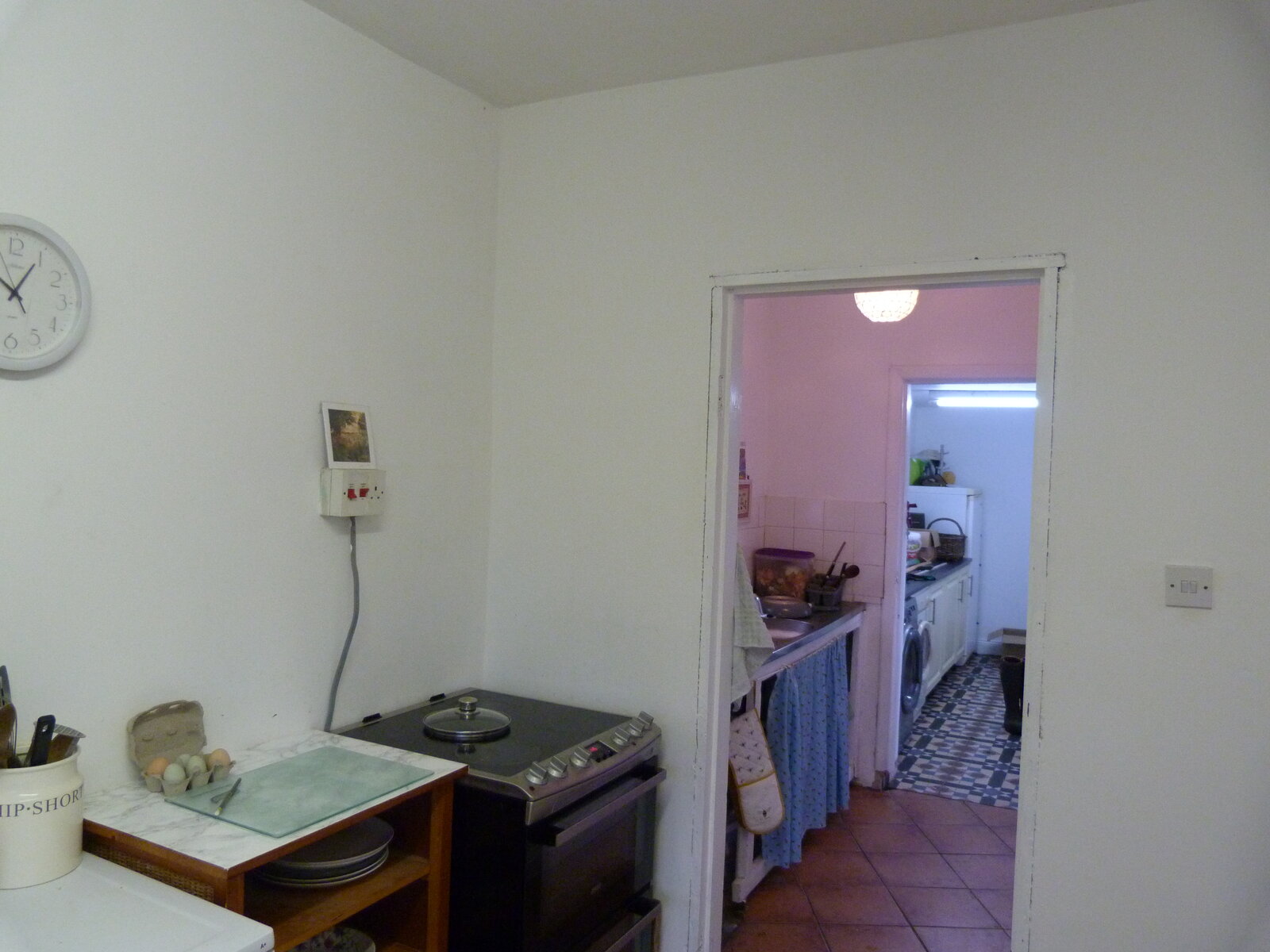

Yes, do sort a pic out; various options may present themselves once the dogs can see the rabbit. Have you got a quick sketch of the floor plan too?
So here's the other side of the wall. It's about two feet wide, plus the door width, so a span of about six feet. My camnera broke shortly after this, but I took some pics with my phone in the attic. There's not much to see as the insulation is very thick, but the joists go across this wall, so I guess that they will have to be supported. The entire bungalow is made of breeze blocks, there are no stud walls here at all. In an ideal world, I'd get rid of the lot up to the level of the ceiling, so that the kitchen became L shaped, but we will probably just put a lintel in above the doorframe into the end wall.
