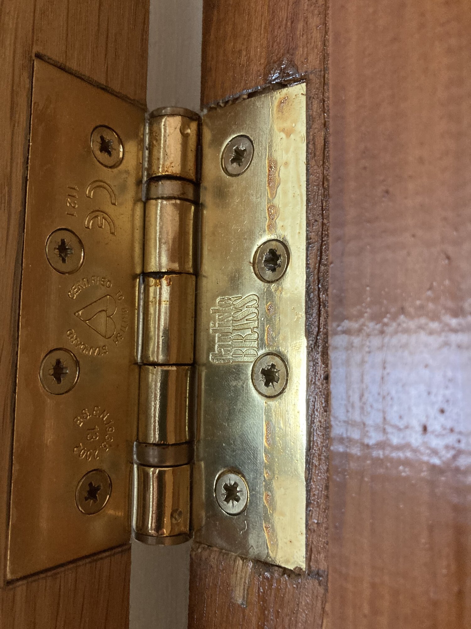

Hi Folks, first post on here and maybe I’m being silly but I can’t figure out how to remove my internal door to the kitchen (I need to get a big fridge in).
On my old doors I was able to knock a pin from the bottom, remove and pull the door up and off without touching the screws on the hinges, but on my newer doors the pins don’t look like they come out ? Any help greatly appreciated!
Thanks Andy , (ask a stupid question!) I was hoping to avoid having to remove the 12 screws in case I manage to bugger the alignment somehow and liked the ‘knock the pin out’ option of the old doors , I take it these hinges leave me with no option ?!
Dave, the vast majority of hinges used in the UK are of the "trapped pin" variety. If yours are the "trapped pin" variety they cannot be converted. You can buy hinges with a knock-out pin, but depending on where you shop they aren't always an off the shelf item. I can't recall a single job I've been on in the last 10 years where they have been specified, other than a couple where I was installing rising hinges; these are always "drop-on" types with the hinge pin permanently fixed to the door jamb leaf of the hinge. In fact with washered or ball bearing hinges IDK how you could have a removeable pin
Unscrew the hinge from the jamb of the frame/casing but leave the hinges attached to the door. When replacing you'll need a prybar and maybe a block of wood to lift the door so you can get the first screw (in the top hinge in), then get one in the bottom hinge and it is plain sailing after that

I make a point of buying lift-off hinges. They are usually a bit more expensive, but if you ever want to take a door off, the effort saved makes it worthwhile. Quick and easy and you do not lose alignment.
