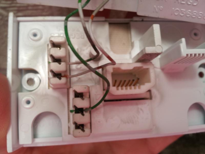

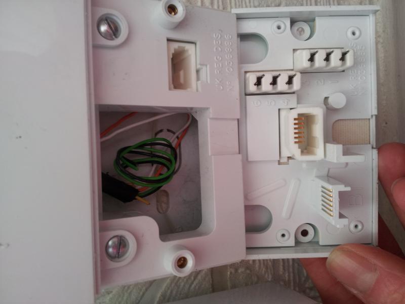

Here are the images of the newer of the sockets:
and the older master socket:

The socket in the bedroom that you want to remove is a secondary socket, and has only one telephone cable going to it. That suggests that you can remove it and cut the cable back. Any other sockets that currently work will still do so. However, it would be better to find and disconnect the other end of the cable first. If your phone worked in test 1 above, you haven't found the other end yet.
The newer (not working) downstairs socket looks like a correctly-wired master socket. However, as there is no signal at it, it has been disconnected elsewhere so you can get rid of that if you wish.
The older (working) downstairs socket is wired rather strangely. It seems to be connected to one extension cable only, and that is wired to both the socket itself and to the extensions side. As such it is unlikely that it is actually the master socket for the line, even though it has the components for one.
It's backwired, meaning electrically it is the master socket but there is another socket / junction box somewhere else that the line comes to first, and bypasses, to run back to via the same cable, which if I read your post right is what you mean.

I meant the bit that is detached in your top picture of the older/working downstairs master socket. Then you test (with it detached but still wired) in both the test socket (the socket on the bit still attached to the wall in that picture) and the socket in the detached bit. And in the socket, elsewhere, that your parents used to use :oops: if you know which that was! And in the upstairs socket that you want to get rid of.
Then let us know which ones worked.
I think I agree with cajar that the downstairs master socket is backwired from somewhere else, in which case with is front panel detached only the test socket will work. But it would be helpful to know.
Also there is certainly a socket/joint somewhere else in the house that the master is backwired from. Identifying that might be useful - what other sockets are there in the house?

I tested everything out this morning, and following your suggestions I found that the telephone, once the master socket's front panel had been removed, would only work when the phone was plugged into the test socket at the back of the master socket.
I was getting 'No Line' when the phone was plugged into the bedroom socket, the socket in the living room, and the detached socket of the master. Although when ringing the house phone from my mobile, they all sounded as if they were ringing (but no ringing from the phone itself if you see what I mean)
Only when plugged into the test socket did the phone operate normally :(

Good news, this means the master socket downstairs is wired and functioning as a master socket (demarcation point). So, simply disconnect the WIRES from the FRONT PLATE, then screw it back together and you can remove the upstairs socket and the other sockets if you wish. This will also remove the backwiring issue. No need for a professional.
