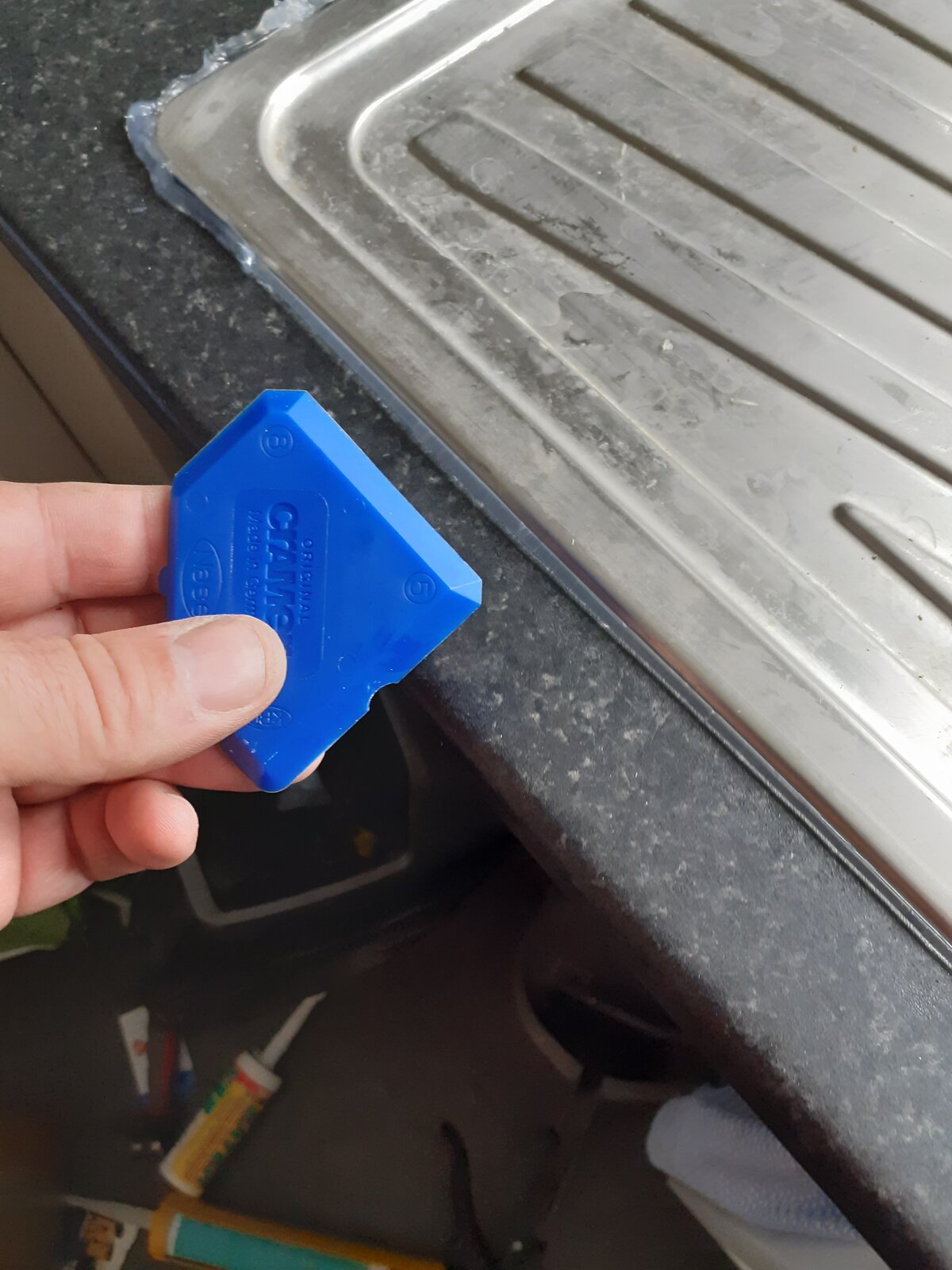

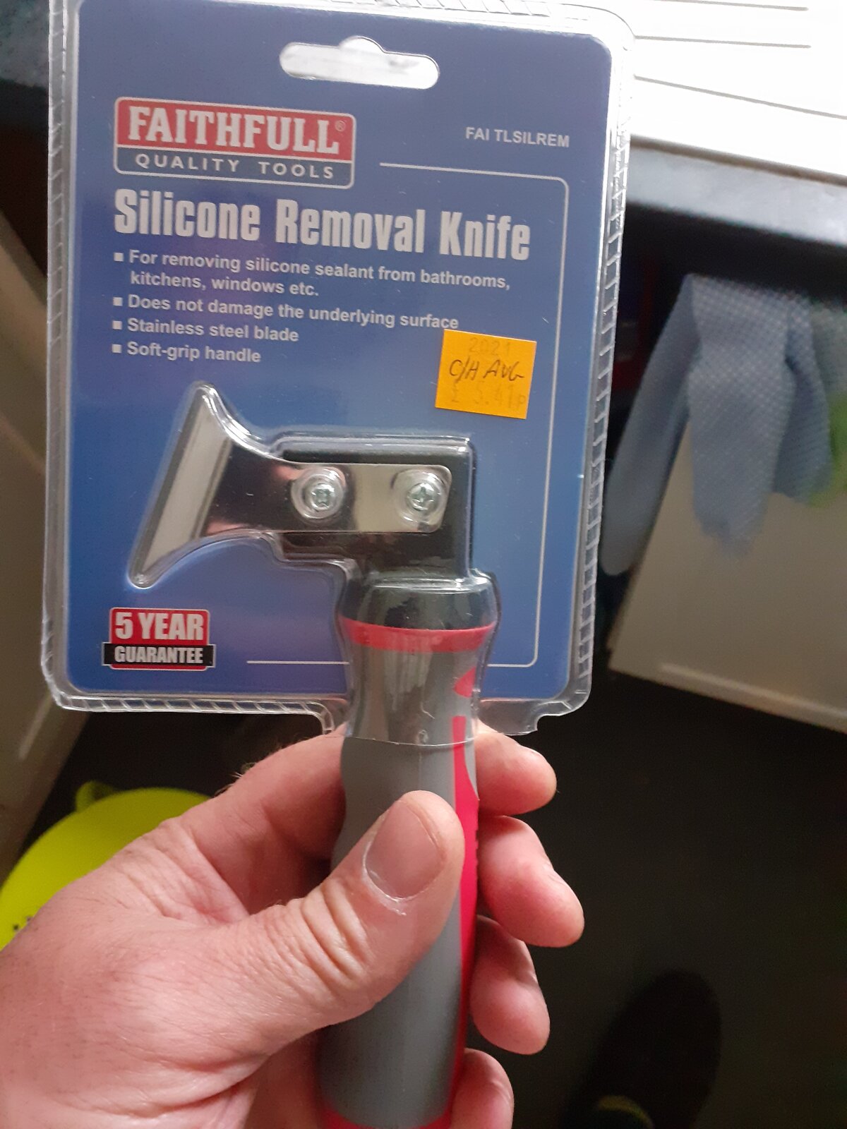

Used a Stanley knife and other scraping gear and this silicon remover but took ages to get rid of old stuff. Not sure I got rid of everything. Used meths at the end.
After applying probably too much I used a blue edge of Cramer profiling kit but a fairer bit smeared onto drainage board and around edges. Is it ok to use a wet cloth to then immediately remove this?
How before it ready to stop water hitting it?
Rule no. 1 - don't apply too much silicone
Rule no. 2 - kill the worms before starting work...
The tool is for running between edges at 90 degrees which you don't have. But you do have 8 fingers to choose from.

You can put new silicone over old if you want but it will look awful and won't last long. Always best to get rid of the old and then apply new.
This stuff works for removing the last traces before you put new silicone on:https://www.screwfix.com/p/no-nonsense-sealant-remover-100ml/88987

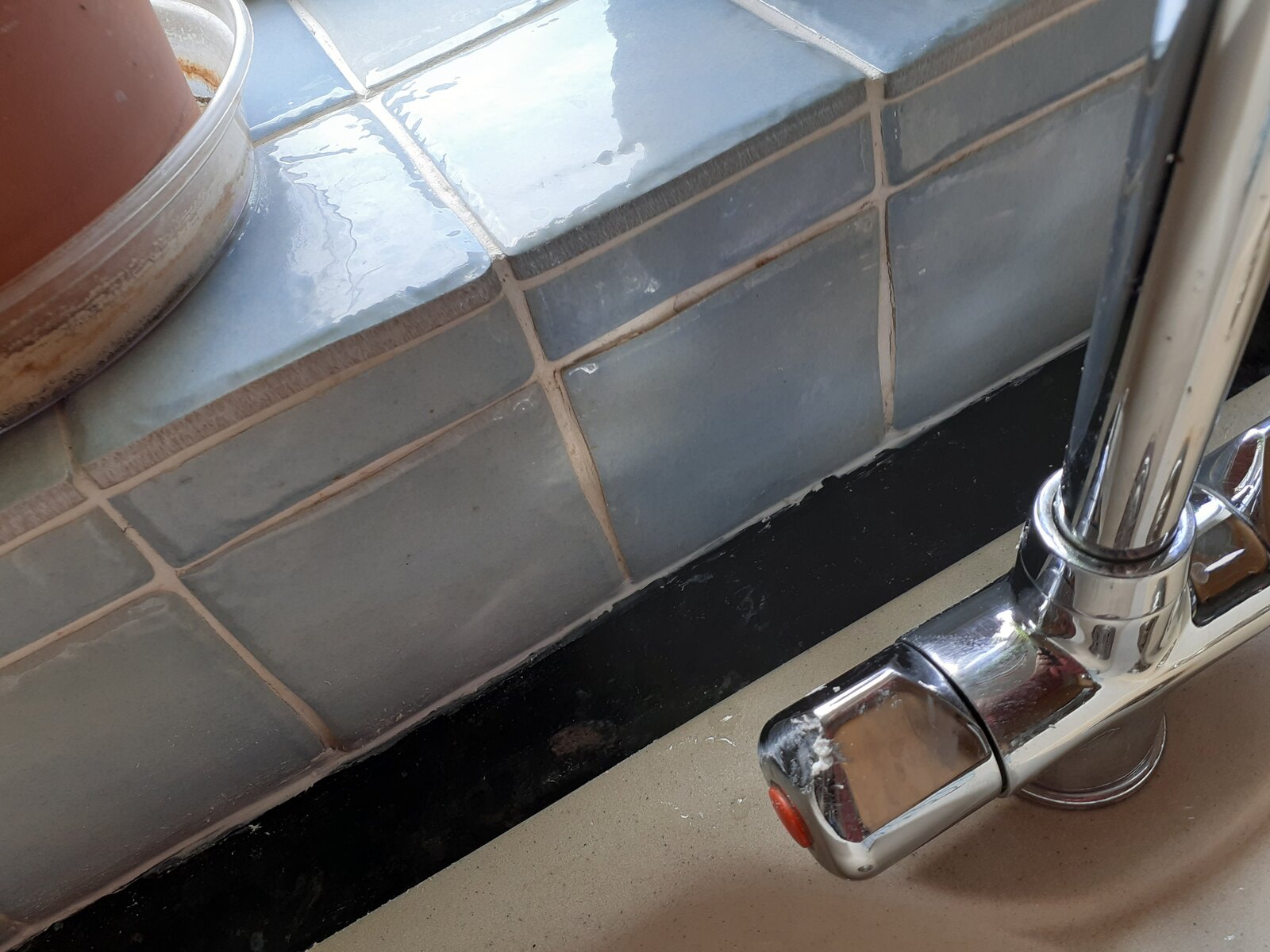

Had another go and went well for half but botched the other half. I went over it with wet sponge. It started drying quickly and went a bit fraying . Tried to cut the dried smeared bit with Stanley but will need to do it again.
Surely it's apply at right thickness then smooth with finger (I didn't wet finger)then apply wet sponge to remove excess? Maybe I was too slow
Too much silicone. Wet your finger. Don't use a sponge.
There shouldn't be any excess if you apply less silicone in the first place. You should try to put a small amount of silicone on and just smooth it to shape it with a wet finger. If it spreads out of the sides of your finger you had too much in the first place, if it sticks to your finger then the finger is not wet enough.

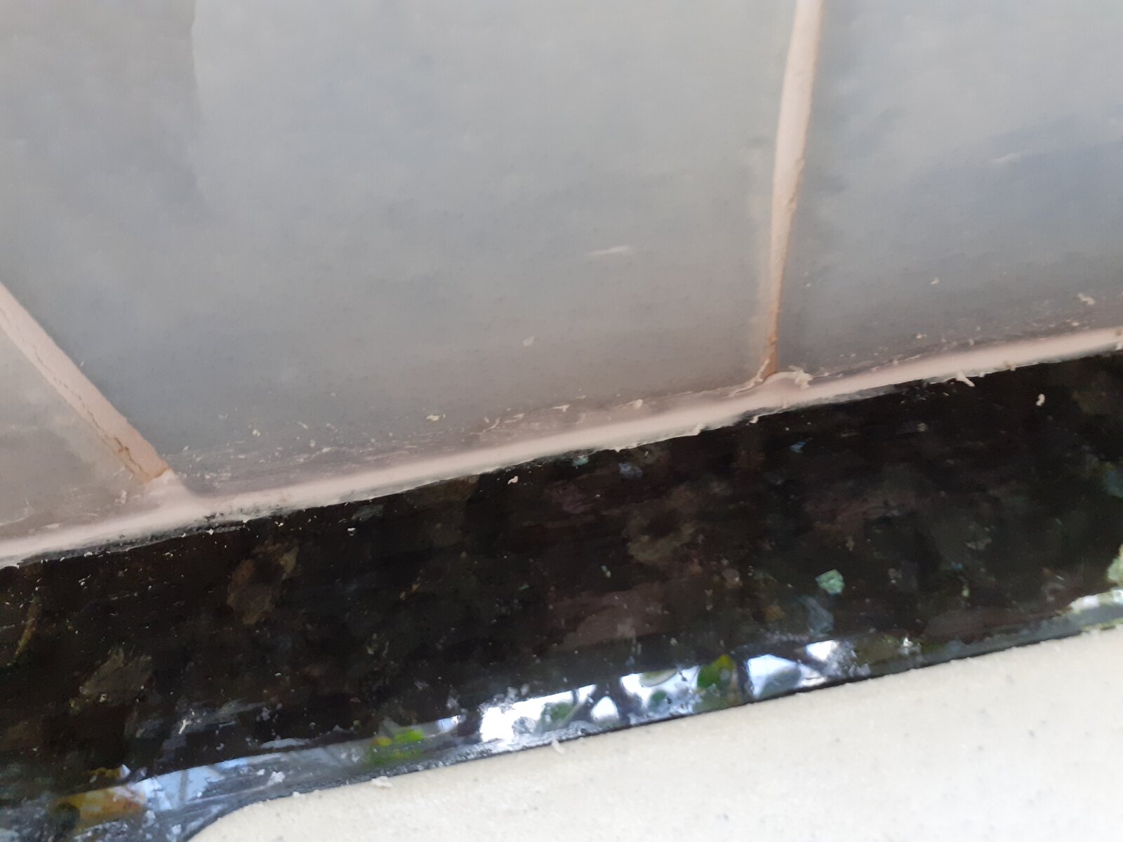

100% of any old silicone must be removed
Surfaces must be 100% totally clean and dry - unlike the stainless steel sink in the photo.
The correct type of silicone must be used. There are various types for different situations.
For sealing around a kitchen sink, the proper method is to remove the sink from the worktop, clean both the worktop and sink, then apply a thin bead of silicone to the underside of the sink before installing it back into the worktop, then remove any excess with the profile tool. Applying the silicone, putting the sink back into the worktop and profiling all done within a couple of minutes.
