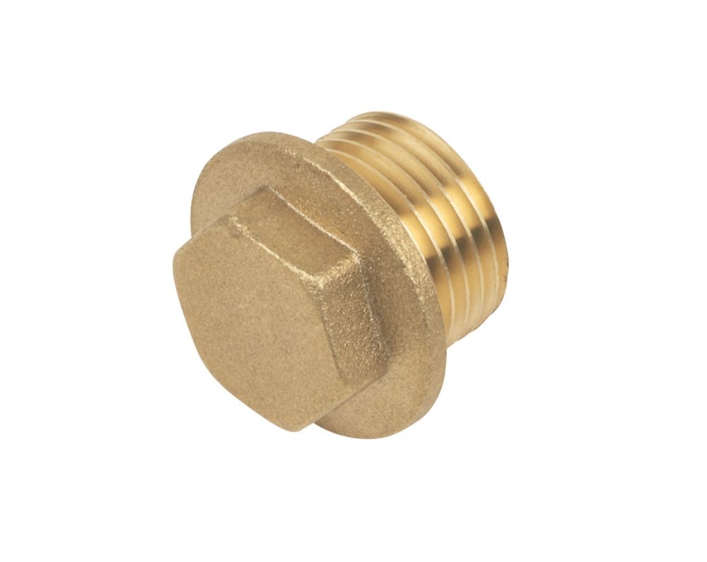

I have an Altecnic PV016RS shock arrestor installed just after my stop cock. Paradoxically, i think it's causing banging in my pipes - i think these are meant to be installed close to a tap or appliance? Its far away from anything!
Anyway I want to simply remove it and see if it improves things. Can i just shutoff the water and unscrew it, and replace with a threaded cap (with a strip of ptfe tape)? Any idea what size and gender cap i need? Thanks

Ok, I may try this. I’m assuming completely depressurising it would be the same as if an arrestor weren’t there at all?
However, if I were to remove my guess would be to use a 1/2” male cap like this:
The data sheet doesn’t mention thread size, so it’s a complete guess!
I believe that no. is a 15mm compression so this would be your man
It could be that someone has removed the nut & olive & screwed the 1/2" thread directly into a female fitting in which case you can put ptfe around the male thread of that stop end and screw this in its place
As you say with water still on releasing pressure from ev will give you effectively no ev as would pumping it up to 12 bar.
