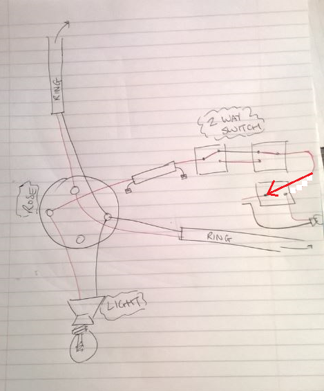

I have a "borrowed neutral" on the landing light - which I'm not best pleased about, but can live with.
I recently changed the old light fitting and put a new rose in - but now can't seem to get the darned thing to work.
This should work right?
s!AvUDx3iwnbuOjtIfTDfaiWAw_FlvRw
https://1drv.ms/i/s!AvUDx3iwnbuOjtIfTDfaiWAw_FlvRw
Poolio
What does "ring" mean on your diagram? Lights should NOT be on a ring final.
OP, I would put the landing on the ground floor circuit then it will give some light to the upstairs if that circuit fails.
A bonus of this set up is that the wiring for both switches on the landing feed from the same breaker.
