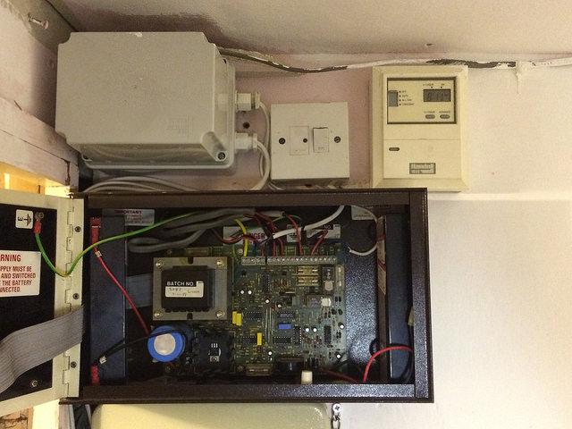

I'm driving past tomorrow and I'll grab that photo. I seem to recall a bus-type bar in it with a load of connections on it.

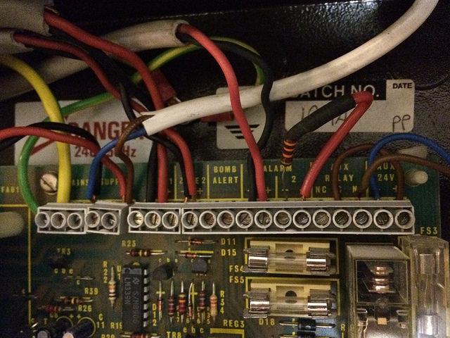

As promised, photos of the alarm. It's a Protec alarm system if that helps. Didn't jot the model down *DOH*

Nice to see that we have a Bomb Alert option in place ready for the End of the World scenario :rolleyes:
Lol like it " bomb alert " .. Looks like a 24v fire alarm switch off with switched fuse spur above panel , looks like there are 2 x 240v cables going into pcb so be careful are the door magnets 240v ?
I think they are 240v. There are three of them running off the CH timer, which was put in place to shut three doors at predetermined times on an evening.
I'm not sure what the white box is about above left. I'm guessing that it's where the various wires come in and connect together.

I might be wrong but... It looks to me like the big grey box is a psu or set of relays for the holding magnets and the alarm's Aux 24V is being switched by the alarm relay to (de)activate the magnets.
So there's only one bell circuit and both zones have been run in T&E rather than FP200 (Firetuf) - nice! :rolleyes: Maybe you don't need to bother with ceramic choc blocks!! ;)
