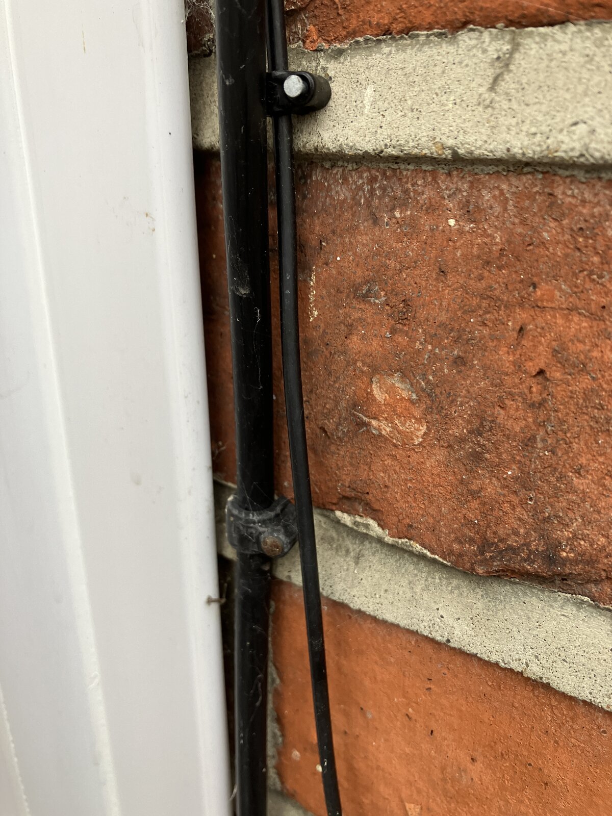

Hi all,
I'm 99% sure of the answer to this, but I'd like to be sure before I do it! Victorian terraced house, lots of old unused phone, sky, etc cables attached to the outside front wall using cable hooks/clips with nails. It's ok to pull the nails out of the brick and pointing, right? I won't be letting water in etc... right?
Photo of one of them attached (the fat cable is the one I'm going to get rid of).
Thanks!

The nails don't always come out cleanly. Try to prize the nail up gently.
A japanese restorer's bar would be ideal
If you don't have one use an old chisel or grab the fitting with mole grips. On houses about to be repointed, I just use the claw part of a hammer, but it pulls it out at an angle. Assuming that you don't damage the pointing, water ingress should not be an issue.
It is, but it might pull a reasonable sized chunk of mortar with it. You can alternatively use an angle grinder and cutting blade to cut it off flush
Thanks everyone! OK seems like this will require a bit more care than I'd thought, especially the ones high up. I think for now I'll just cut off the most unsightly dangling cables and see if that improves things.
