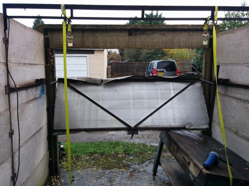

In case anyone else has a similar problem and is scratching their head like I was...
Stage 1:
use ratchet straps to hold the door in place while counterweights removed (using cheap angle grinder and thinnest available metal cutting discs). Used an old workbench to stop the weights dropping on me/the concrete floor. N.B. each weight must be over 10kg, probably 15kg - quite glad I didn't assume they were lighter!

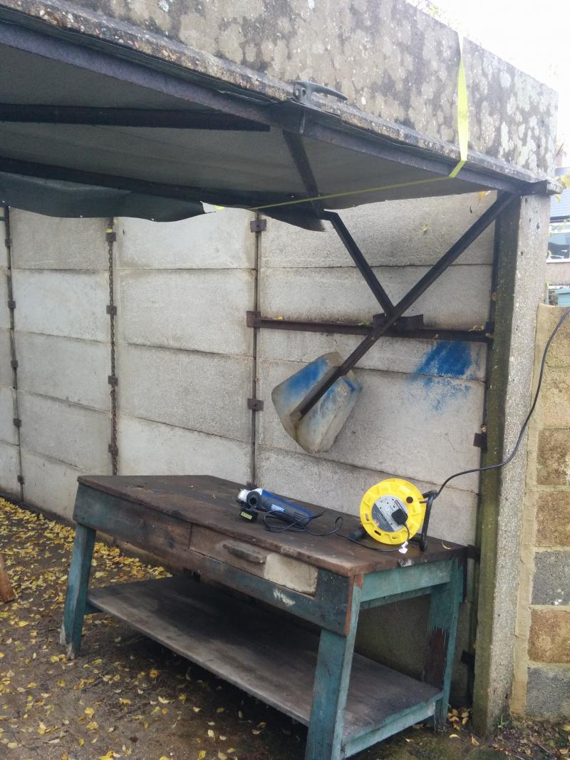

Stage 2:
carefully/slowly remove the straps, one at a time, and 'manage' the movement of the door - it swung 180 degrees as you might expect, so that all the weight was at the bottom.

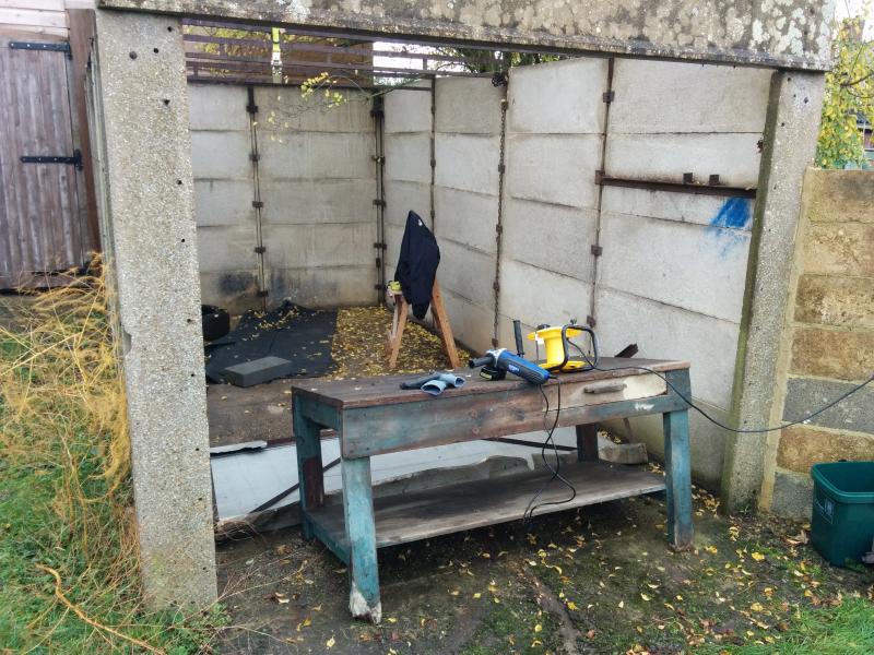

Stage 3:
move workbench under door and carefully cut door away from pivot point on garage side wall.
Stage 4:
move bench under centre of door and cut the door away from the other pivot point. At this point the door will come crashing down. As you can see from the pictures, I was helped by having a lop-sided bench, which meant I could work from outside the garage, safely drop the door onto the bench, and it simply slid away from me into the garage.
I'm sure having someone else to help might have been better, but they might just have got in the way or been showered with sparks of molten metal :(
