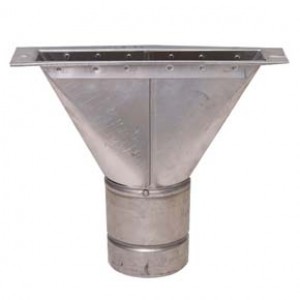

Not sure if this belongs in Building, Plumbing or Roofing so apologies if this is the wrong place!
My house has a cavity flue running from the ground floor up into the loft, with this kind of arrangement in the loft. The gas fire downstairs was removed and plasterboarded over years ago before I bought the house.
My roof ridge is in need of some work and I expect to have it removed and replaced so it seems a good time to get rid of the ridge vent and the flue pipe which is always getting in the way in the loft.
Can I simply remove this and leave the cavity pipe open into the loft space, or does something more "proper" need to be done?
As above but I would vent the redundant stack to the outside not into attic.

It was much simpler than I expected actually.
The 'ridge tile adapter' on the diagram was one of these which I believe is a standard fitting. This attached with two nuts to captive bolts on the ridge tile, so I was able to simply undo these two nuts and the whole thing dropped down. For now I've simply left the vented ridge tile in place which is ventilating the loft. I am hoping to have the whole ridge replaced before winter though so will ask that it's swapped out for a standard ridge tile while they're at it.
Where the round pipe enters the 'offset transfer block' at the bottom was cemented in to produce a seal however most of this had already fallen out or was loose so I was able to simply pull the pipe out after breaking away the few remaining bits. I guess if yours is in better condition this might be a bit more effort but can't imagine it being a big job. I've also left the cavity flue venting into the loft and fitted a plastic grille over the hole, to stop things getting knocked down the flue by accident more than anything.
