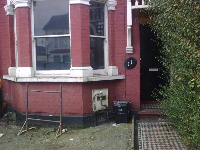

Expertgasman, its like your second link but a right angled fitting as opposed the straight one shown.
Agile, sorry if I have mis-lead you or anyone else. It is not a HA property, its a private landlord one that is managed by a letting agency. Secondly, even after reading your 'comments' on how some people do it that way I wouldn't. If anything happened to the next resident/ a prospective tenant or even a burglar I couldn't live with myself.

I few months ago I saw a meter that had been stolen and the pipes left uncapped.
Here is a bypassed gas meter!
