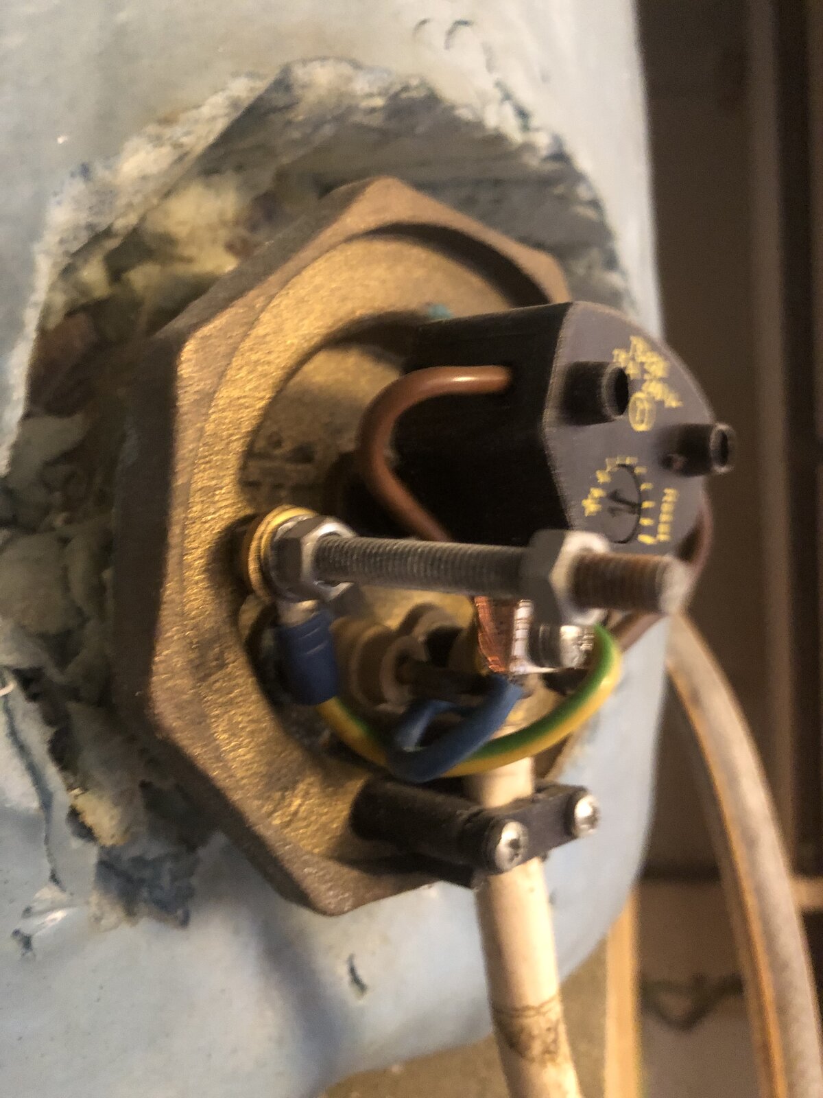

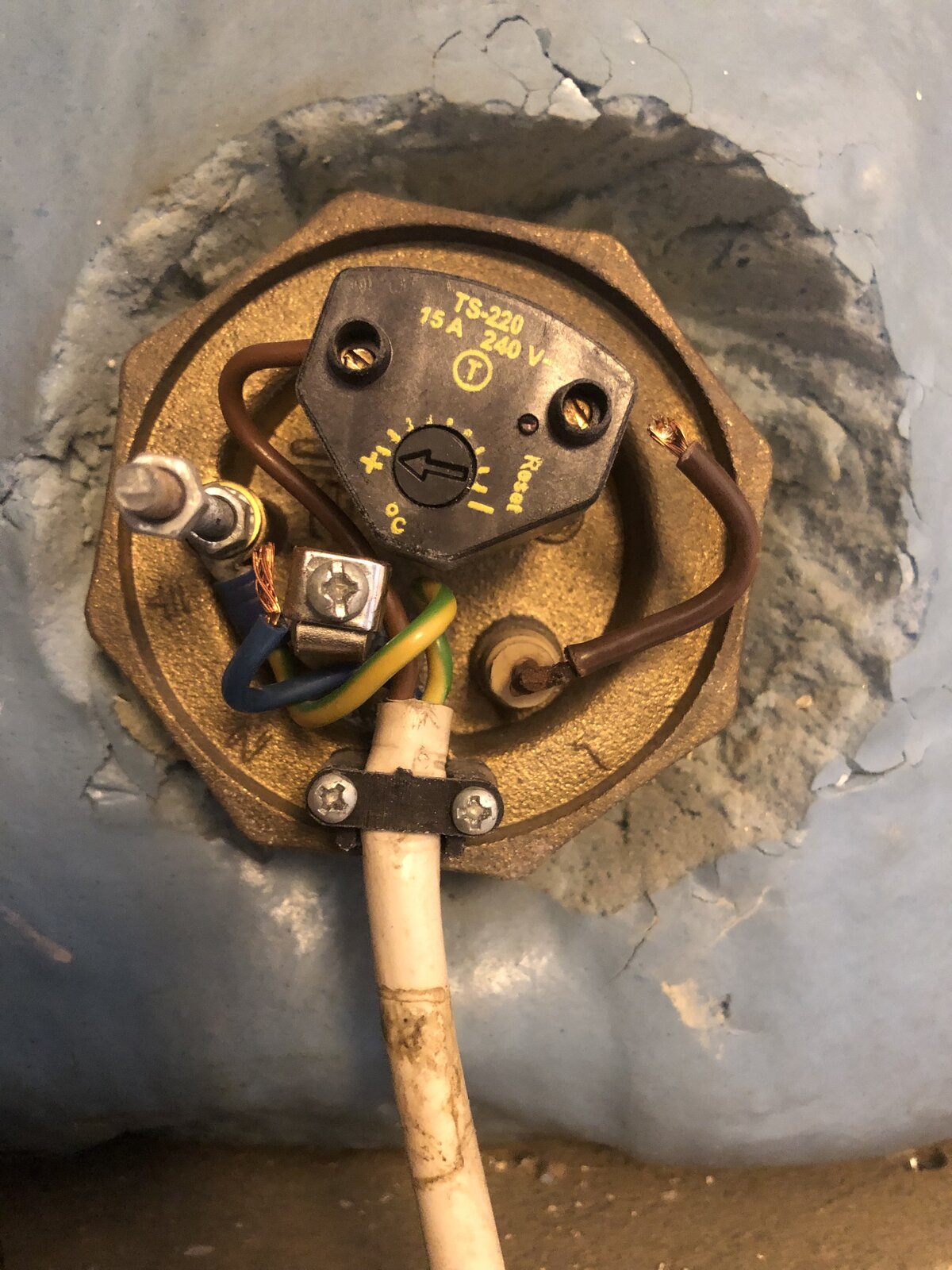

Hi
I was wondering if anybody might know a solution to a problem I am having removing an immersion heater. I am really struggling to find a spanner to remove an immersion heater. The box spanner and another immersion heater spanner that I’ve tried are a few mm too small and won’t quite fit fit over the nut. Most of the Stilson wrenches also don’t seem to open wide enough. Any advice would be very much appreciated.

Do not use a Stilson. Make sure you get a spanner with "two" handles in order to apply a coupling opening torque which helps to avoid tearing the cylinder top, first, if space allows, get a sharpish chisel and give it a good whack with a lump hammer in the anticlockwise direction to break the seal. Also, if a top mounted immersion, let the cylinder full of water.
If the immersion heater is being replaced anyway - try to get some heat into the boss first, to expand it and to help crack it. Try tightening a fraction, before trying to undo.
That might work if I could get a spanner that will fit the nut but standard 86mm ones available are a little too small to fit

The difficulty is finding a spanner that fits the nut
Immersion heaters, and the spanners to fit them, are a standard size. Are you sure what you have is actually an immersion heater spanner?
Can you show a picture of the spanner, on or nearly on, the 'nut'?
