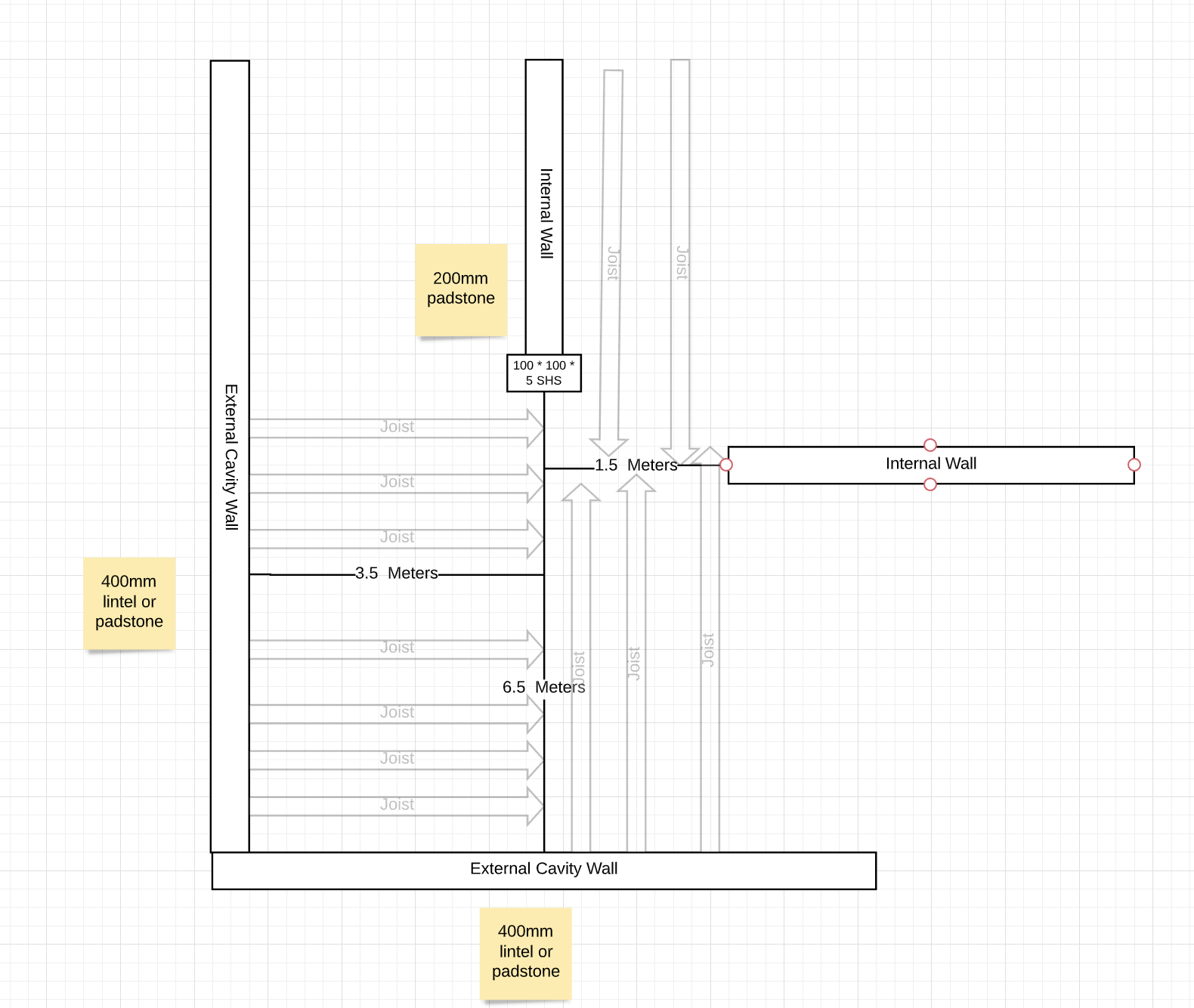

We are investigating the possibility of removing 3 internal walls (sections of walls) to make 3 small rooms into one large room.
One 6.5 meters, Holding up floor joists and stud walls
One 3.5 meters, No joists but a “vertical beam” that is under a roof purlin
One 1.5 meters, Holding up a couple of floor joists
The 2 smaller guys will be bolted into the bigger. 4 No 20mmdia BB with 10mm plate
I've had an SE have a look. He has recommended 254*146*31 UB for the 6.5 M and
203x102x23.1 for the 2 smaller guys.
The 6.5 M guy will not have any upright apart from at one end by internal wall (100 * 100 * 5 SHS - see diagram)
The steel will be going in flush to the cavity walls but sitting on padstone or lintels
See attached diagram for some more detail.
This might be a bit light on detail but thats basically my current knowledge.
What I want advice on is:
1. Are there any major stand out concerns with this?
2. What further questions should I be asking to the SE and builder?
Thanks!

You could ask the builder what further information they require from the structural engineer in order to carry out the work.
Thanks Leofric. Yes, I'll do that.
My concern is around the complexity, i.e. removing 3 sections of wall and the 6.5 M span. Would be interested in some independent
opinions. Builder and SE admit it is slightly complex but have no major concerns i.e "all doable".
