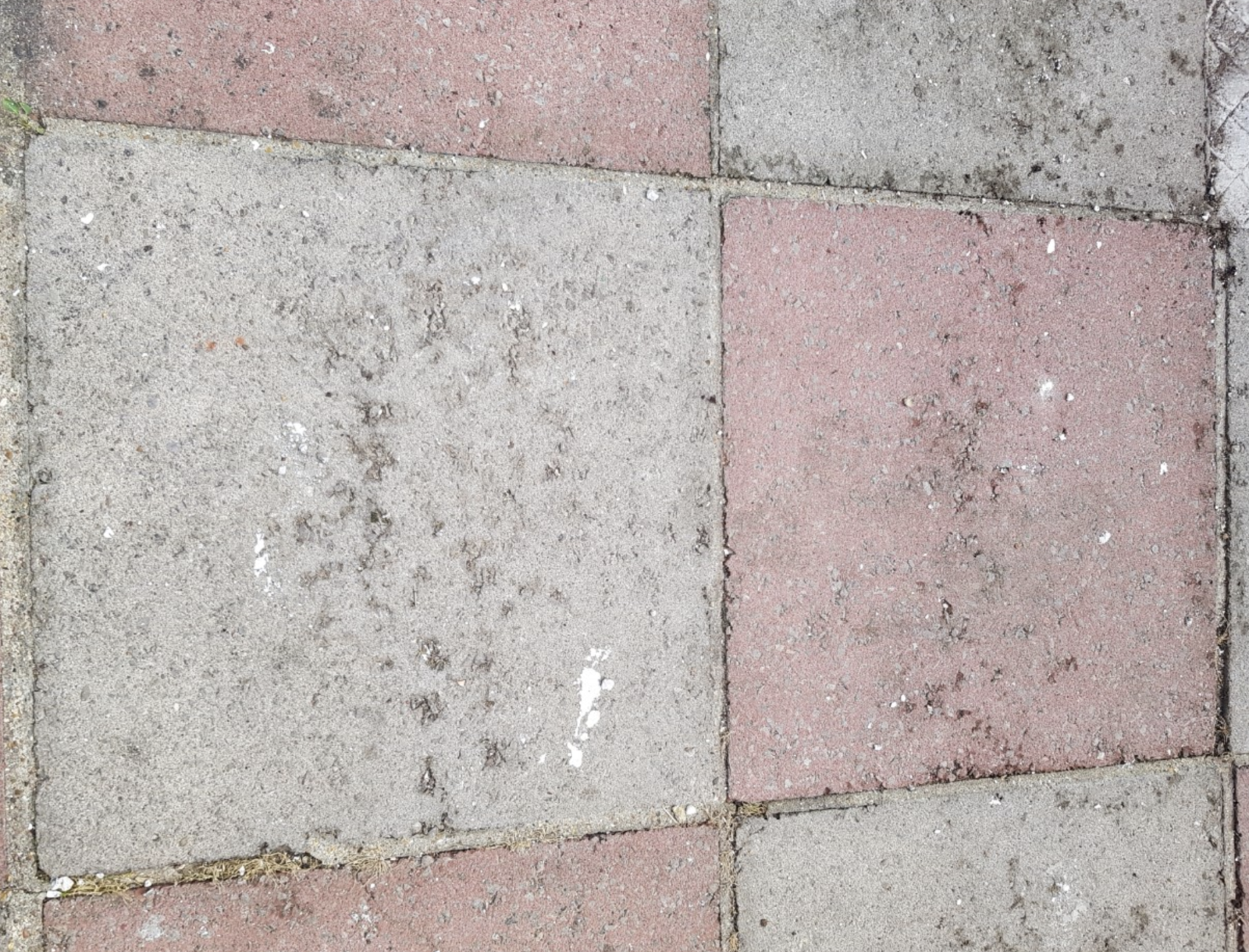

Can someone please suggest the best way to remove white masonry paint from patio/stone?
I painted the house white and some has fallen on the floor below. Tried white spirit and it was useless, so was a jet wash. And now reckon I need something a lot stronger. But also don't want to discolour the patio too much (they're old red and beige stones).

Wire wheels on a drill should work.
Sanding requires a better quality paper that won't go blunt after a minute or two.
The paint is unlikely to have penetrated by more than 0.5mm at the most.
Photos of the stone work would be useful.

I don't think the paint stripper will make much difference. They normally only break down oil based paints. Cellulose breaks down wb paints pretty quickly but I am not sure that cellulose will help much given that the paint has soaked in.
