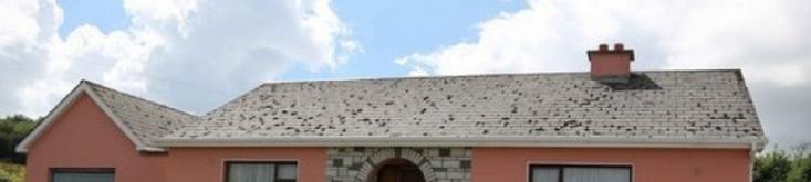

Hello all,
Any tips or advice on the best way to remove moss from a roof without causing damage? Use a Kärcher?

Do not jet wash your roof. You will most likely damage it permanently.
It will take off the outer "hard" layer of the tile. By damaging this you will probably shorten the tiles life considerably. It will be more susceptible to absorbing moisture and then blowing out (shaling) in cold freezing conditions. You will probably then need to paint them to protect them and that will need doing every year or so and will look terrible.
In my opinion, do not trust any companies who recommend jet washing or let them any where near your roof. Yes it maybe cheap and easy but it is a cowboy roof cleaning method. The amount and pressure of water also has the risk of causing the roof to leak.
The best way is to treat the roof with an appropriate moss cleaning solution (not too strong in terms of acidity i.e something made for roof tiles) using a low pressure spray (watering can pressure). And let the moss decay and get washed away in the weather.

If you have concrete roof tiles, I personally wouldn't use acid.
Just a stiff brush and plenty of clear water (as above, jet wash = big no).
But why bother? It'll be back within a few months and however you clean the roof, clambering over the tiles will damage them.

Ok, ok ... I hear you, no power hosing. I will investigate moss remover, but its not a thin layer of moss evenly spread - its great clumps of moss, they should lift easily enough but clearly am afraid to crack the tiles. Roof is old fashioned slate.

Is that your actual roof?
With it being a bungalow makes it a lot easier to access at least. Slates can be damaged easily so you are right not to climb all over it. In my mind you have two options.
Pay a roofer with the correct equipment and experience to go up and clean off the clumps with a brush and water.

Invest in a decent long reach brush (like the window cleaner ones but with bit harder bristles) and scrub them from ground level or a ladder/platform. You could even get ones that squirt water from the brush end.
Water should do it, or you could use some ph neutral tile cleaner. I do not know how acidic moss cleaner is...to be honest it doesn't look that big of a moss problem so just water and scrub lightly with a brush.

Yup, that is the actual root, I will own in about a week.
