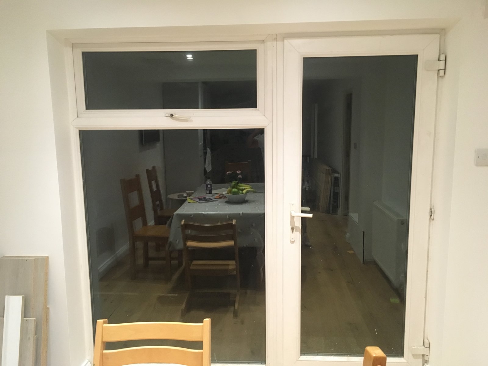

Evening all,
In a few weeks I’ll be having new Bifold doors replacing our old UPVC French doors. To save a bit of money (£250), I told the installers that I will remove and dispose of the old doors myself.
How do I go about deconstructing this thing (see image 1), so that it is ready for the installers?
I’m thinking:

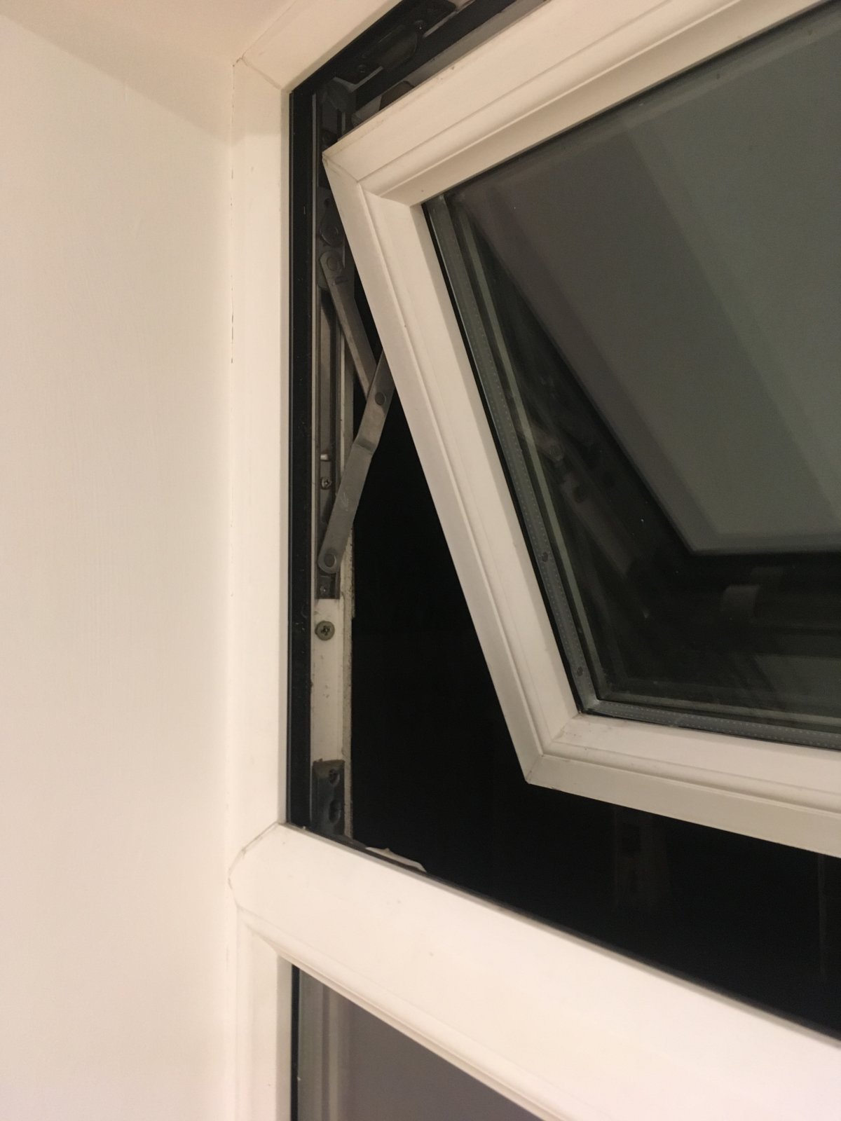

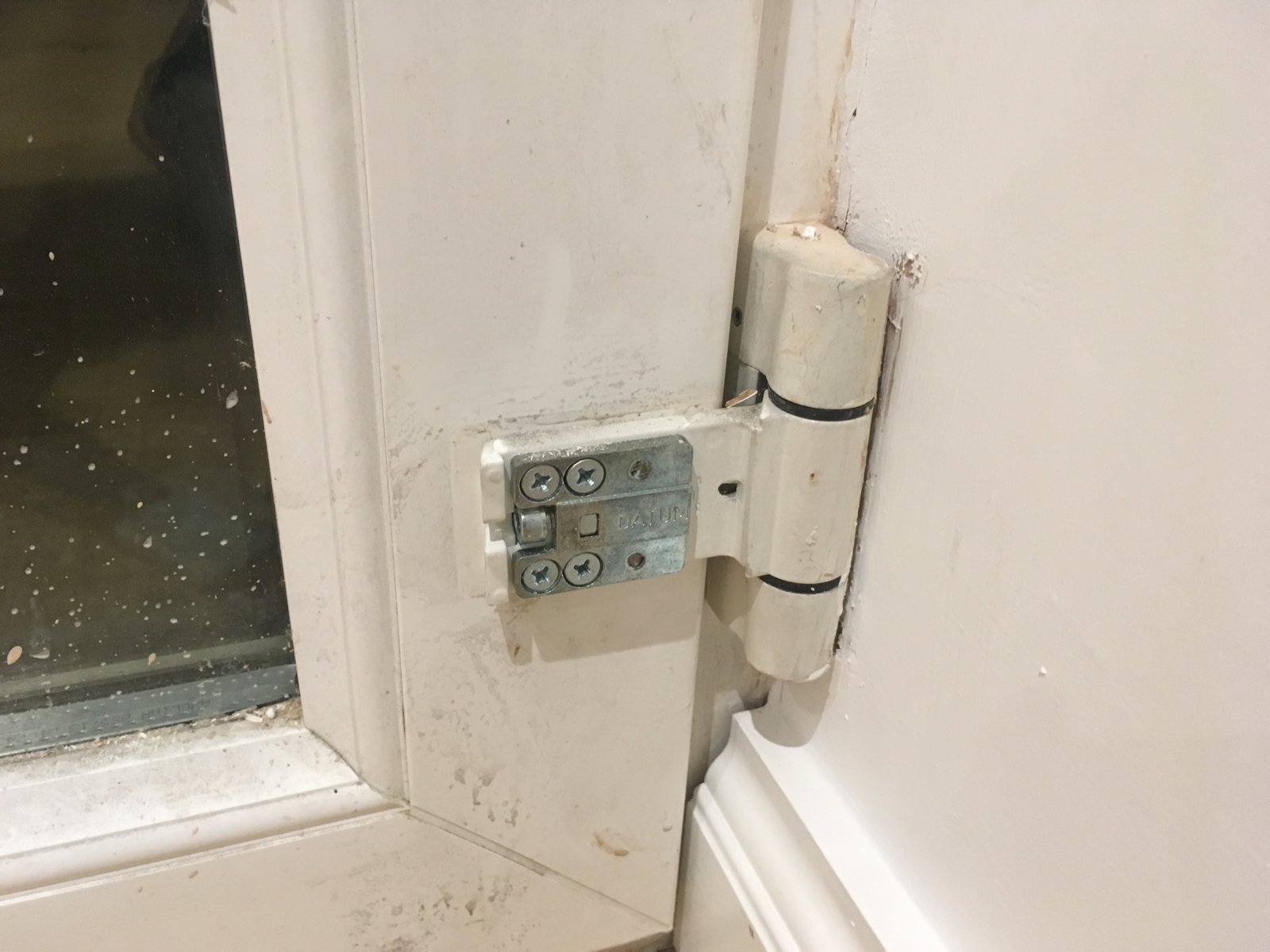

1. Remove the door from the hinges (see image 2)
2. When the door is removed, I’m assuming I will have access to the screws affixing the frame to the brickwork (although I’m not sure how the other side is held in place as when the side window is open, I can access just one screw.
Any help would be greatly appreciated.

The weight of the glass is a significant part of the overall weight of the door so remove it first.
When the doors are removed the locations of the frame fixings should be apparent.

Thank you- The entire unit consists of a door, window and a large pane of glass. I feel fairly confident in removing the door, but how do I remove the large pane of glass? There are no obvious places where it is being held in place.
Firstly unscrew the opening window sash.
You will need to deglaze the large pane of glass from the window to access the rest of the fixings on that side. Yours look to be internally beaded (hard to tell from the pics) if so you just need a thin scrapper to prise the beads out. Look were the shaped molded part around the glass joins the flat part of the frame, Start in the middle of the longest side and try to force the scraper in.
It is possible that they are externally beaded though. An outside close up pic would help us check.
Whether you deglaze or dehang the door is upto you, It would make handling easier if you are on your own and yes you can just undo the screws you mentioned.
Dehanging the door will not reveal any more fixings though. They should be visible when the door is open just like the fixing you can see in the open window sash.

Superb/ thank you for that gazman. It looks like it should be a relatively straightforward job!
Just below the top opener hinge I can see a concrete screw, so you will likely find a few of those around the frame. They are a largish star type head.
When you remove the large piece of glass take care that you don't end up with a heavy unit heading your way rapidly! S second pair of hands with gloves would be very helpful if you don't have a suction thing to remove it with.
