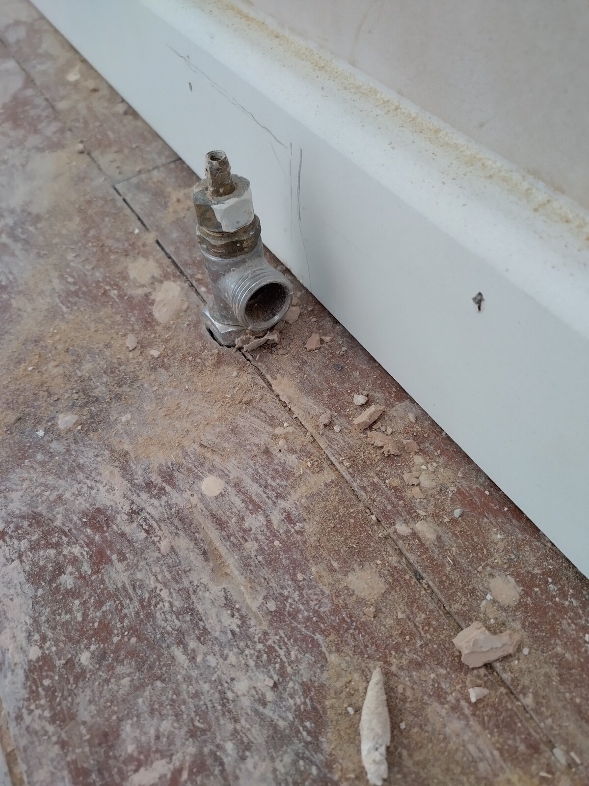

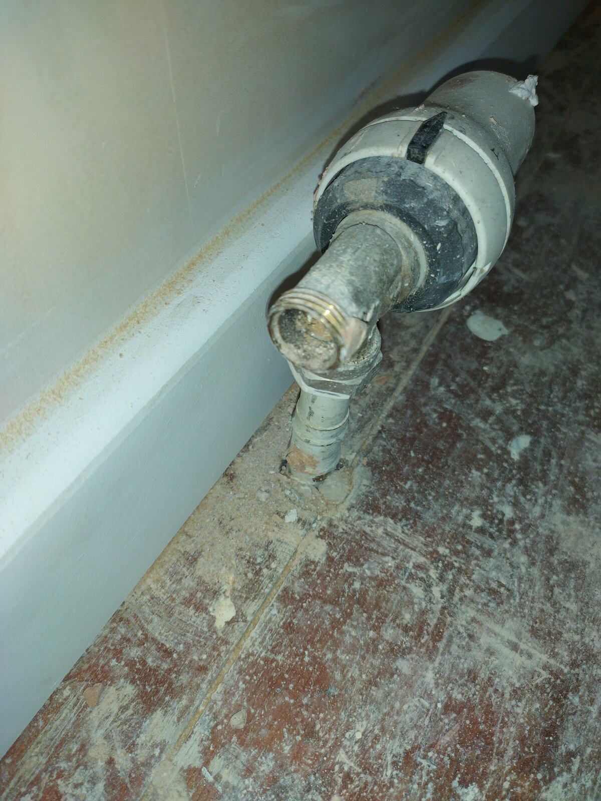

I've had a look at various threads here, but can't find the exact info I need.
My plumber came to look at replacing some old corroded rads. Stupidly, I didn't think to ask him to take the old ones off and cap them off before he left.
He said something about buying some brass caps ¾ and ½ with a rubber seal.
I'm OK with shutting off both sides and removing the rad (will need old towel or similar to soak up water). But I can't find the caps with a seal. And are the sizes the same?
Thanks.
In my experience, they are normally only needed for TRV valves. Old ones don't always close completely. Hence the need for a blanking plate and a rubber washer.

The TRV doesn't look like it is weeping. Possibly no need for a cover. If you are concerned, cut up an old plastic milk bottle and place it under the trv
