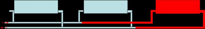

Hi, I'm about to remove 3 radiators from our CH system which are at the ends of "loops" and I've got myself confused. Can I just remove the radiator and cut and cap the flow and return pipes back to the next radiator or do the flow and return pipes need to be joined? I've tried to show one of the radiators I want to remove in a diagram.
Thanks in advance.
Cut and cap as you propose. If you join the flow to return you will effectively create a bypass and your rads won't get hot.
