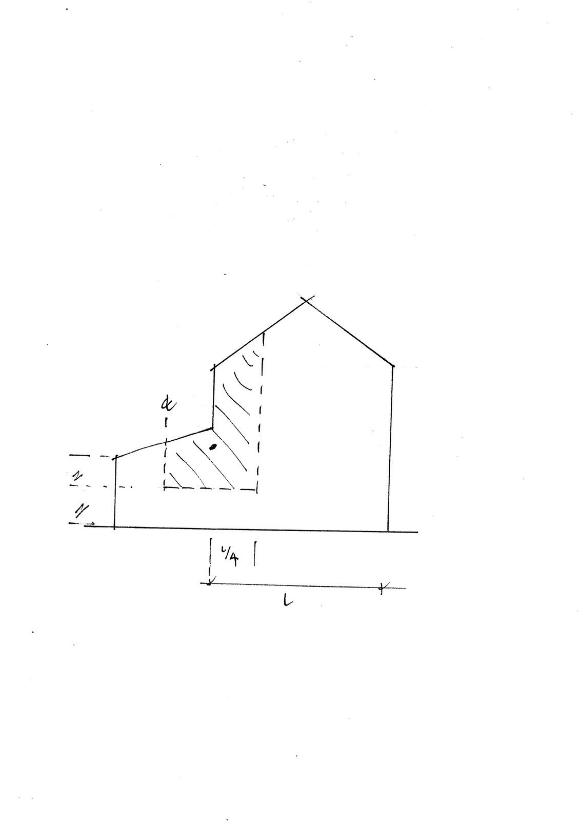

For wind-load calcs, I'd take the area hatched on the attached sketch.
If you are sheltered/suburban/low rise, suggest unfactored wind load of 0.6kn/m2.
Assume this acts at top of piers, so bending moment is shared between the two piers.
If you go through the loadings carefully, you generally find that the resistance moment of the 440 x 440 (loaded) piers is greater than the applied moment.
(Note that your Building Control people need to agree the wind load, and the wind-loaded area; if you're more exposed, they might want > 0.6. If they want wind-load calcs for the whole gable wall, you then have to consider the resistance moment of all internal- and external ground floor walls perpendicular to the gable plus contribution from chimney breasts, and add them up, which is very tedious. You can generally assume that the floor and roof/ceiling act as diaphragms and will tend to distribute applied lateral load among all walls).

Thanks for the sketch showing the loaded area. So I can understand better...
You take half the height of the rear extension and ground floor of the existing building. Presumably that is because your taking what would be the reaction force as it is being considered as a beam. If so that is something i would agree with.
However you take 1/4 with depth of the building. Why not 1/2? Does this tie in with your previous comments about considering the building as a whole. What is there were no other internal walls?

edit: just occurred that your referred to the other internal and external walls. Therefore you consider that the floor and roof structure transmits the load to the opposing walls and therefore only 1/4 has to be directly resisted by the piers. Correct?
The reason I suggest ¼ the width of the main house rather than ½ is that there is usually at least some degree of stiffness across the width of the gable at ground floor level, even if it is only - say - a light studwork partition adjacent to a staircase or a cloak/meter cupboard wall.
The other reason is the purely theoretical one that if you include half the gable for the wind load, you'd considerably increase the applied moment, and it's unlikely the piers would be able to resist that.
At the end of the day, it's a semi; what's the chance of your neighbour waking up one morning and deciding to demolish his house to make yours a stand-alone detached? In the real world, next door's will give you some support, so there's no point in making the theoretical figures more difficult for yourself.

All interesting stuff, although im of the mind that if you maintain 450 x 450 solid piers and all else the same then your general OK.
If you keep to roughly the loaded area on that sketch, and no more than 1.0kn/m2, I'd be fairly sure the 450x450 piers would be ok.
Agreed. Particularly as the vertical stress would reduce the tensile stress on the mortar joint on the tension face.
Actually 450 works out to roughly equal to a 665 return when you take into account the external leaf running further to accommodate for the cavity. Although a solid pier would give more benefit where the existing brickwork is poor or there is a high axial load.
