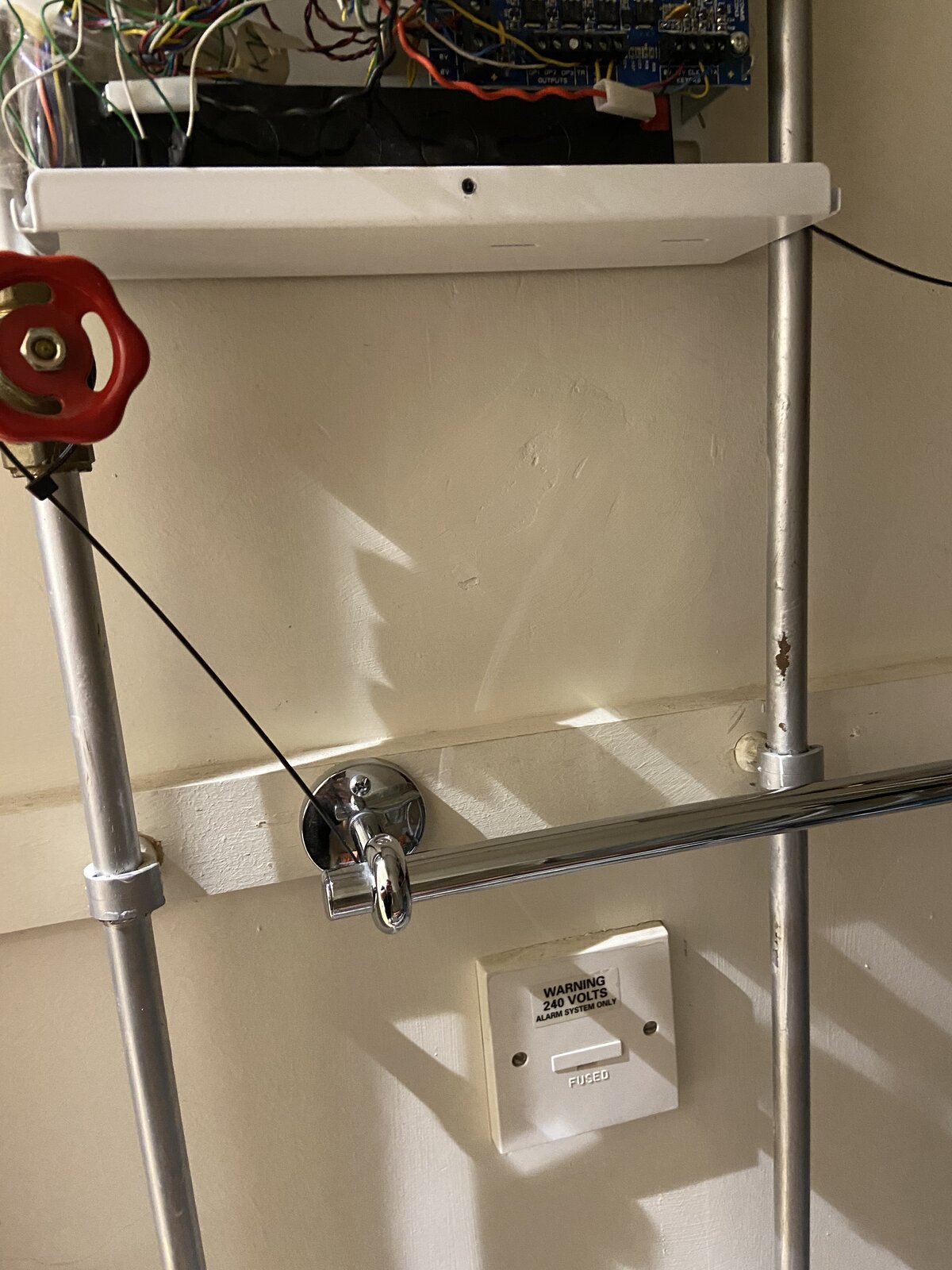

Hi there,
Looking to remove the alarm system as no longer required. I've removed the large battery from the box. The power is still live to the keypad. What's next?
How do I turn the live power off to the keypad as want to remove and plaster over.

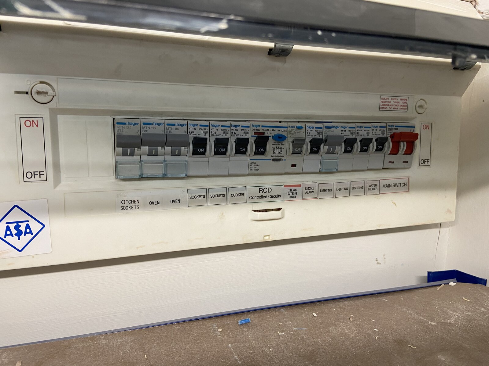

Need to know how 230v power is wired to alarm control panel ?
Do you have a fused spur next to control panel ?
Is that on it's own circuit or wired off ring main or lighting circuit ?
Good questions, looks like a fuse spur, not sure if it's on its own circuit as nothing is labelled up on the box (see attached pic) do I need to turn all power off and remove the fuse?
Also, do I need to do anything to the bell box or can I just leave it in situ.
Appreciate the help
