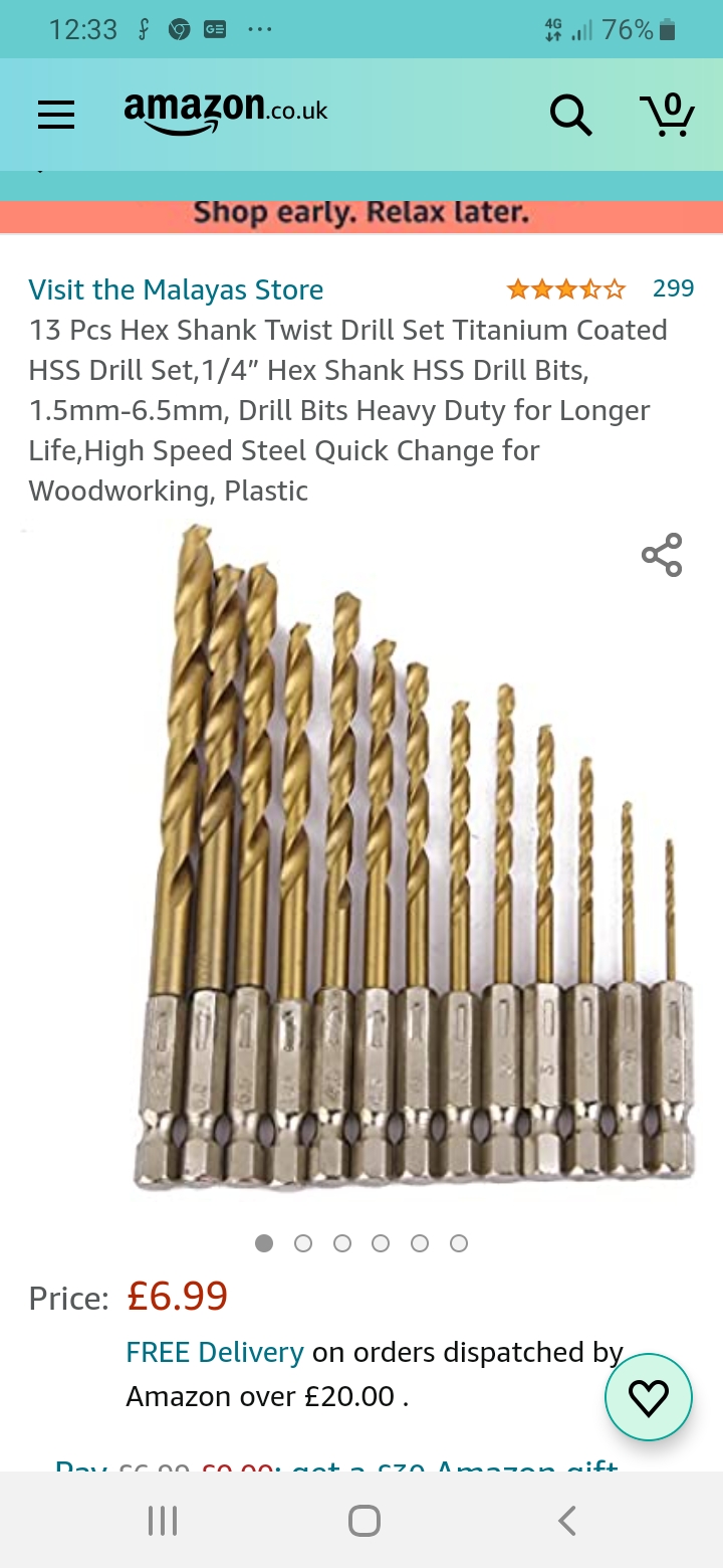

When you say twist drill bit, do u mean what's in the image? I thought these were called metal bits!

When you say twist drill bit, do u mean what's in the image? I thought these were called metal bits!View attachment 211909
Yes, they are called twist drills or HSS Twist Drills, but not those cheap things. £6.99 for 13 different sized drills is far to cheap to be decent quality. They may get you through timber a number of times but once you start using them on any type of steel, even mild steel, they will soon burn out and become blunt. You should by a decent set from a well known brand such as Bosch which are a better quality and will last longer.
