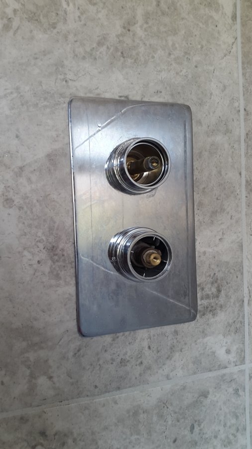

Hi
I'm trying to replace the thermostatic cartridge in a Tavistock dual inline shower.
How do i remove the face plate without cracking a tile? !!
Darren
Gentle pry? Sharp blade first if any silicone has been used.
I think a lot of silicon has been used! Any spray i can apply to melt it?
Big, thin carving knife, and saw through the silicone.
Cheesewire and 2 wooden batons and saw through the silicone
